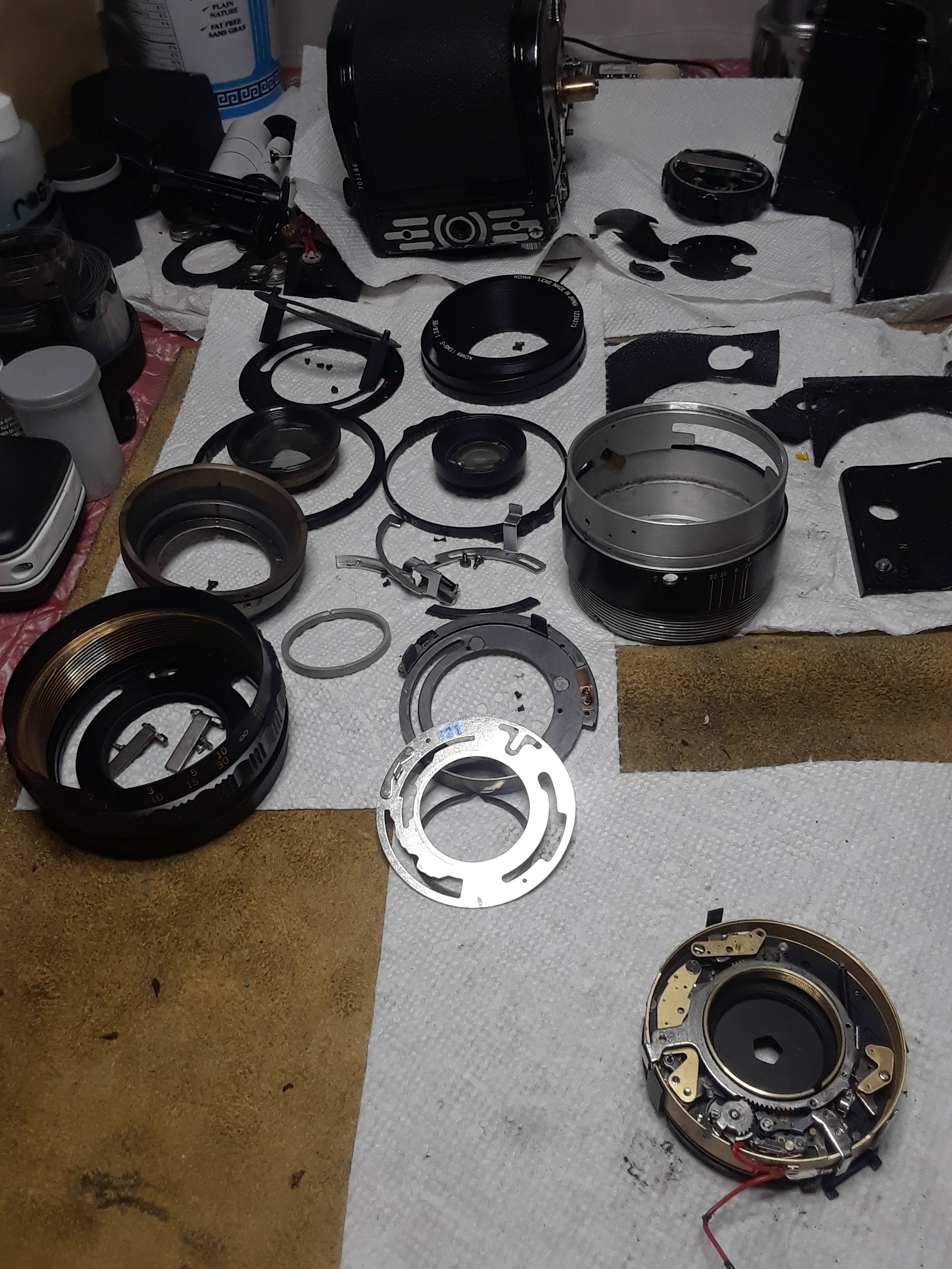

I'll search for some pics I have , I cleaned up a few Kowa six lens for Beau photo out here , after I spent countless (120) hours learning how to
do this same task , with some help and a few parts from Ross Yerkes . By the time you're down to cleaning shutter leaves it's kinda important
to understand that patience and no coffee are almost a necessity ( and I always crave coffee :smile: ) Pm me, I live in Burnaby . Peter
This is 4 screws away from the blades falling to the desk :smile: . Peter

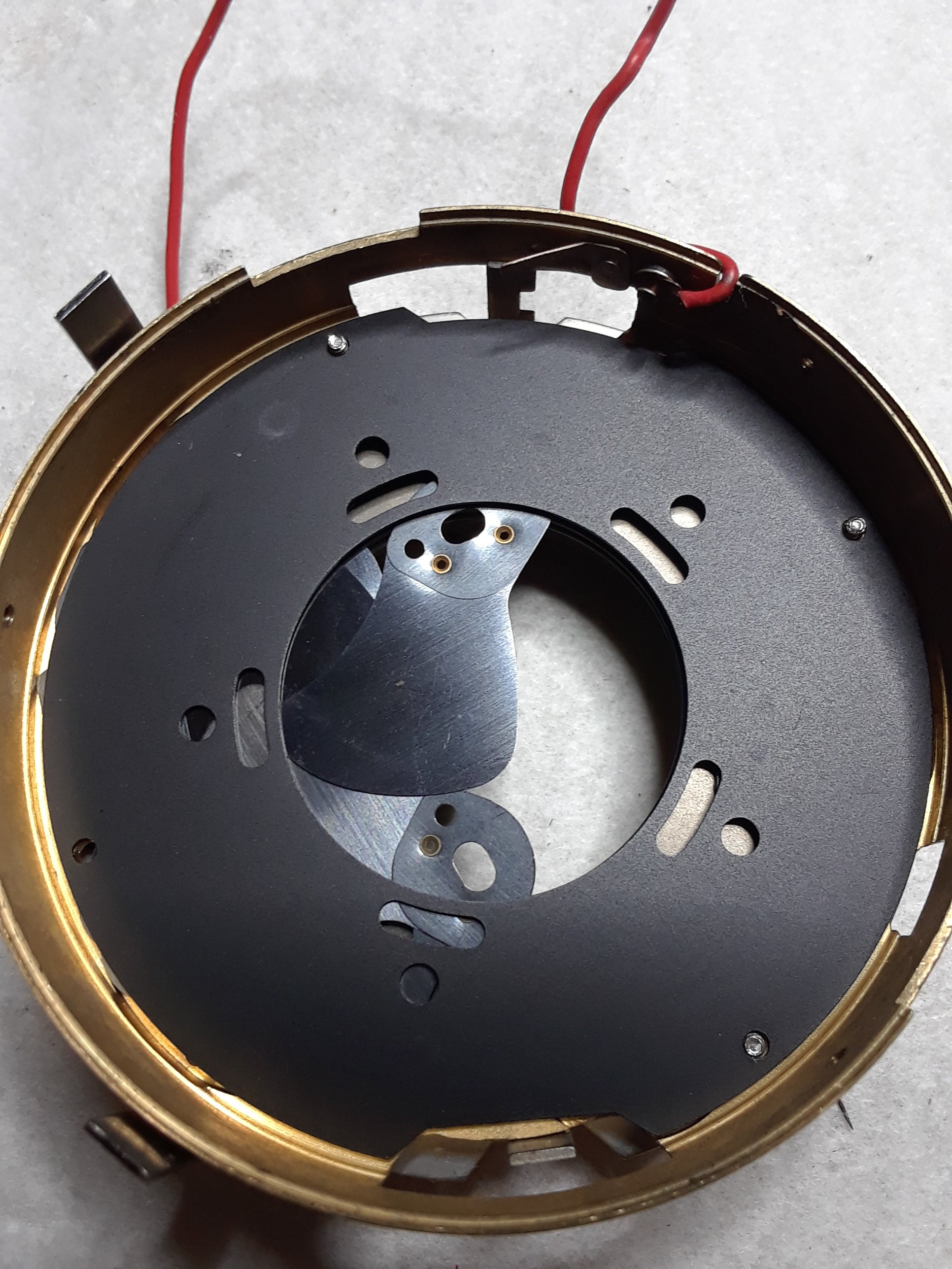

moto-uno
Sep 28, 2009
585
Burnaby, B.C
My Pics 355.jpg This is what you have to remove to get to the shutter assembly ( lower right ) , then the fun begins ! Peter
