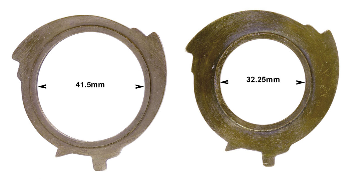

Hi guys/gals. Can anyone identify these brass lens mounts and for which camera/s they were intended?
Thanks.

I've a similar mount however it came in a job lot of brass mounts so I have no clue what camera it came from.
The one on the right possibly have held a Dial-set Compur #0, these came in 3 tube sizes the most common is similar to a later Rim-set Compur just a different thread pitch, there was one with a narrower tube so smaller diameter fit. Gauthier made similar sized shutters (Vario, Inso, Ibsor, Pronto. The One on the left would tak a Compur #1 Rim-set or Dial set.

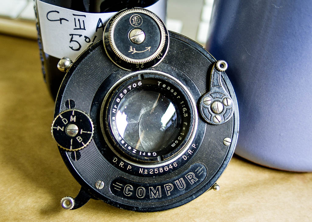

One was on a Compur Shutter housing a 135mm f6.3 Tessar but not sure if it belonged to a pretty beat up 5x7 wooden camera (no identity) which was in the same box of junk at a flea market.

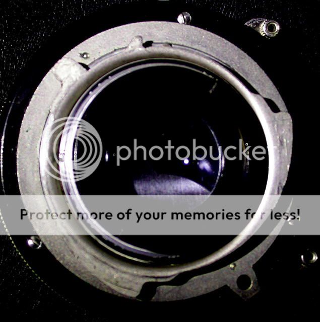

The image below is the back of the lens from an old Voigtlander folding plate camera. I was unable to remove the bayonet adapter, which replaces the typical retaining ring. I hope the image is clear enough to see the bayonet adapter ring.
A 135mm f6.3 Tessar would have been on a 9x12 cm Ayus style camera and as Old-N-Feeble note probably a Voigtlander their top models could take interchangeable lenses, Ihagee gad a similar system as did one or two other companies. Your lens was made around 1927/8.
The f6.3 Tessar lenses are the sharpest over-all and the smallest, less common than the f4.5, I have a 135mm f3.5 Tessar on an Ihagee Zweiverschluss Duplex and it's very significantly larger as is its Compur shutter. The faster the speed with a Tessar the less the coverage (image circle) and the softer they become at the corners and edges at wider apertures.

Old-N-Feeble, thanks the bayonet shape clearly the same same as I have.

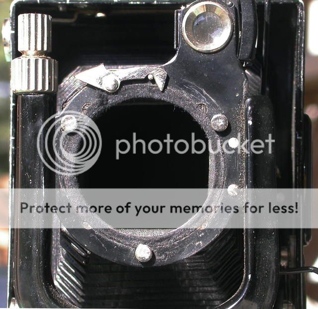

I am completely ignorant on this kind of bayonet.
How does it work? I mean these two studs (located below at the first photo).

Here's a pic of the front of the Voigtlander plate camera, showing the mating surface for the bayonet adapter ring. The three evenly-spaced chromed studs are fixed. The chrome thing at the top, near the hole, is a latch.

Old-N-Feeble, Thanks, that says everything about the lensmount ring I was searching for!
