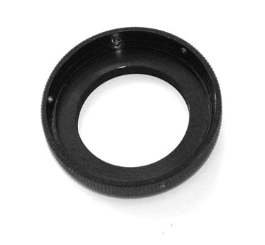

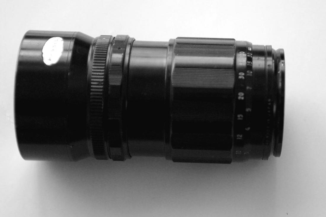

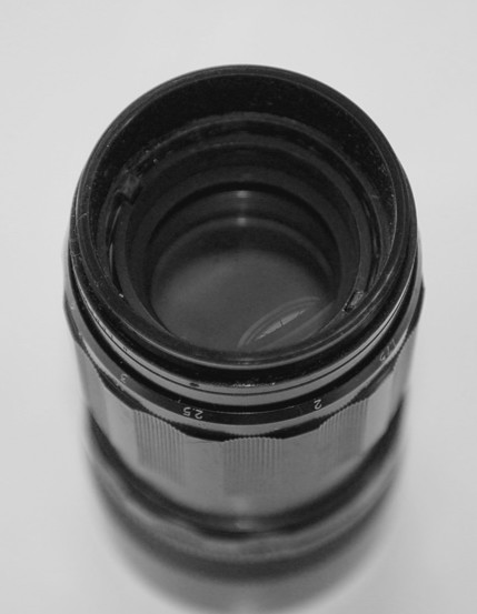

Three views of the lens mount
Here are three views of the lens mount, from left to right: 1. The adapter itself. 2. The lens rear without the adapter. 3. Side view of the lens with adapter removed. The rear of the lens is 55mm in diameter without the lens adapter. It was a 'pentax screw' or M42 mount attached, but I'd like to use it on a Nikon F. This is NOT a T-mount. The adapter doesn't screw on, it slides on and is held in place with three broad, pointed screws that fit into the v-shaped groove on the back of the lens. I don't know if these were intended to be user-changeable, but all it takes is a screwdriver (and the replacement adapter, which I lack). Thanks for any help you can provide.
