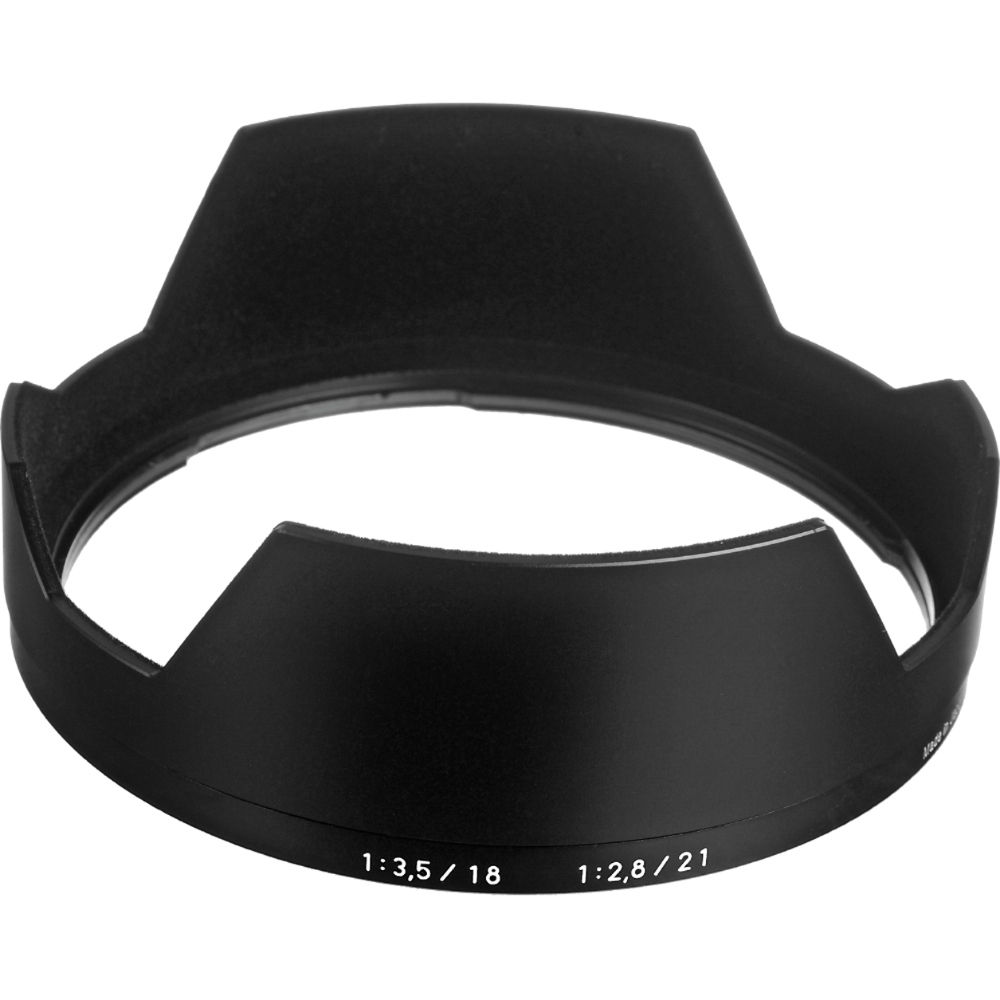

I've been thinking of hoods for my large format lenses and am not sure what is the right way to go about it. In particular I have a Nikon 90/4.5S and a 180/5.6 that I use on 4x5 and could do with some protection when in the rain.
I am not sure if I need to get one of those compendium expanding hoods or if I can just get a "normal" and a "wide" screw on threaded hood for them. Would the normal hoods interfere with movements or is the coverage there anyway? Obviously the difference is that I can get metal screw on hoods for nothing whereas a compendium hood is a bit more of a bother to find plus is going to be a lot bigger to carry.
What do people use for lens shading?

A fixed lens hood will certainly interfere with movements. If it doesn't it is not effective, because it is too wide. The best system is the Sinar bellows with the adjustable sliding mask II. Toyo and Wista compendium hoods are also good for their cameras.
Kumar.

Have a look at one of these ;
https://www.srb-photographic.co.uk/p-size-bellows-lens-hood---black-11227-p.asp
It slits into a Cokin P size holder and can be used whilst using filters . Extends for longer lenses , leave more flattened for wides and do on .
I had one for years using it on 135,120 & 5x4 .
You can get one that fits the Cokin Z-pro filters from Speedgraphic .
https://www.speedgraphic.co.uk/lens...ee_cokin_zpro_hitech_100_nisi_v6/29309_p.html
They fold flat and all you need is the holder and filter adapters for your lenses .
But if you use slot in filters , you already have all this .

Both these hoods are good, but how would they be adjusted when movements are used?
Kumar

I find it very easy to detect if a lens shade interferes when I peek through the clipped corners of the ground glass.

I must be missing something. Why would movements cause a problem? If the compendium shade is attached to the front of a lens, and you let's say tilt the lens down, well, the shade moves down too. If it didn't block the lens before moving the lens, how does it block it afterwards?
If you have a 90mm lens with an 90 degree view, the shade for an 90 degree view does not shade much. So usually the shade is based on the angle of view of the film format. So if you use any movements, the compendium needs to be adjusted to suit. As mentioned, looking out the clipped corners lets one see where the compendium is interfering.
If you tilt the front standard, but the position of the lens is still on the camera axis, then the field of view doesn't move down. Tilting the lens doesn't change the field of view, it just changes where the plane of sharp focus is within that angle of view. So it can lower the hood into the field of view.
If you apply rise or shift, the field of view changes, and that can also bring the hood into the field of view. Whether these are real issues depends on how much movement you apply and how tight of a hood you need. As usual, wide angles and shooting towards the sun are harder.

It's not clear to me. If the hood is attached to the lens, and you apply rise or shift, the hood moves equally as far as well as the lens. How can the hood block the view and cause vignetting after the move if it didn't block it before the move to cause vignetting? It not different that changing the the whole angle of the camera by tilting the camera or aiming it in another direction. The hood moves equally.
Applying rise is different from tilting the camera upward. I could draw a picture, but I suggest you try it. Rig up a shade or lens hood (even a piece of cardboard will do) so it is just above the field of view with the camera zeroed. Now apply front rise. The field of view moves up (that's the point of front rise) and now the shade will be poking into the field of view.
