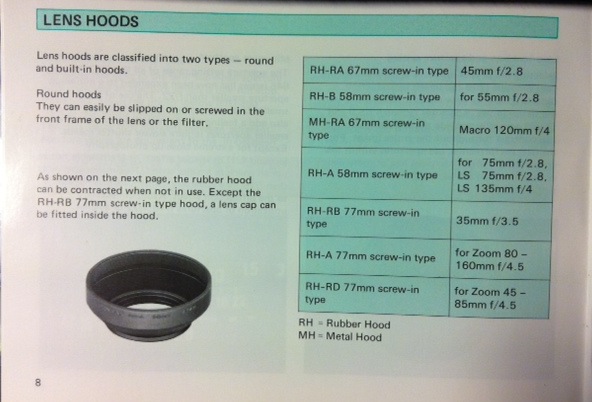

It would seem that pentax changed the hood for this lens. According to my official leaflet, the correct hood for the Pentax 645 A 2.8/45mm lens is the RH-RA 67mm screw-in rubber hood, although this contradicts the info above. This information is based on a Pentax 645 Interchangeable Lenses folder dated November 1995, just before the release of the 645N; see the attached picture (sorry for its poor quality).

Well now it is all starting to make sense. Pentax changed the hood for this lens mid-course. The slide on hood is simply a friction fit, although I believe there may be some sort of indent on the inner side of the hood collar that helps keep it in place but I'm not sure.
Troll's more recent manual shows the availability of a 67mm screw-in hood. Given the choice I would probably favor that one.
Perhaps this is why the Pentax Forum was confused.
