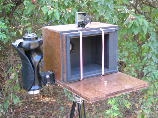

Does this help?
The tail board is not necessary (and makes it really difficult to carry)
Just slide the inner box out to focus using a ground glass; keeping the inner box parallel to the outer box.
