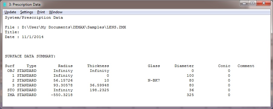

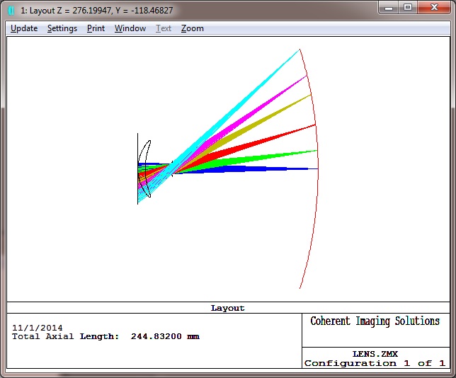

Here's an example of an 8x10 landscape lens prescription
With a crown glass (BK-7), a meniscus lens with the concave surface having a radius of curvature ~1 2/3 that of the convex surface will correct astigmatism. Placing an f/12 stop about 36mm behind this lens will correct absolutely for coma (the distance is important for coma...the stop diameter will reduce spherical and color). This is the classic Landscape Lens (Wollaston Landscape Lens) as found in the Kodak Brownie (scaled down of course).
If you use an achromat meniscus, then you correct spherochromatism and you have the Chevalier lens.
If you halve the power of the Chevalier and place a copy behind the stop so that the layout looks like a mirror image, then you correct lateral color and distortion as well. This gets you the Rapid Rectilinear or Aplanat (depending on who you talk to). It allows you to open up the stop to like an f/6 or f/8...hence "Rapid". That takes you to the late 1800s in photographic design.
