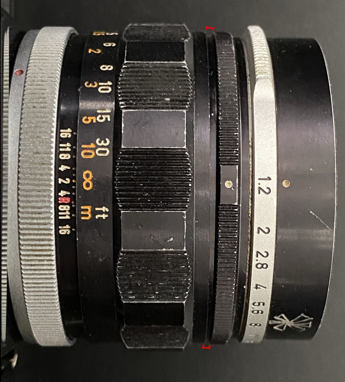

I found the issue, highlighted in red. The gap between the stationary and rotating part of the lens is slightly different on the left and right sides. There is a small amount of play. I can force it back to an even plane by pressing down on the left side. When I let go, it's uneven again.

That would do it. It's probably just a set-screw (or two) that has come loose. Can you fix it? Sure, assuming you can get at the problem screw(s). That may or may not be easy, and you have to have the right tools.
