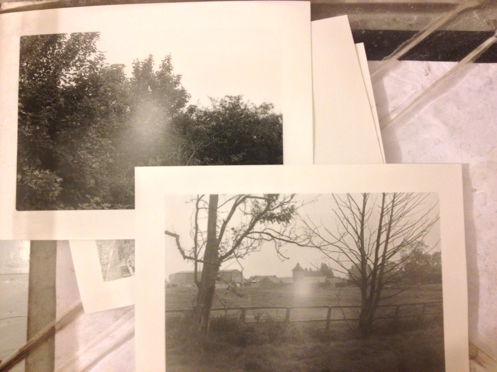

Hi
these were shot with a 1952 Leica Elmar 5cm f3.5 lens, is this lens flare? Or a dog of a lens? My Summaron and 9cm Elmar on same camera (a leica III) do not do this. One foto is with hood and one without, the sun was behind me and it was overcast....
I am sure it is obvious..but the flare if that is what it is, is always in the same place, the centre of the image... 11photo.JPG

Its not too hazy, certainly not as hazy as my Elmar 9cm, which is actually a beautiful lens and shows no obvious flaring from haze, nonetheless.....
Haze will have different effects depending on which surface(s) is/are hazed. I really can't tell you anything else without seeing the lens, of course, but cleaning it is the first step I'd take.

Thank you, I thought it might be the shutter curtain leaking, but i checked one roll of film with 3 different lenses and the 5cm is only one with these light 'balls'....
georg16nik
Aug 3, 2010
1,101
With shorter lenses, holes in shutter curtains might be more apparent.. depends on if its the rubber or the cloth part.
Inspect your curtains in dark with pin light.
Besides the 9cm Elmar, what were the other lenses you tried?

35mm Summaron f3.5 coated from 50's, very nice lens, had no problems with it at all, maybe it is the 5cm focal length that is causing it? weird...

thats what I thought, either the shutter curtain has gone thread bare at the centre? or the lens is defective? but as said, other lenses work ok, unless the 5cm focal length shows it up somehow...
Anton Lukoszevieze
Oct 1, 2006
383
Analog
solved...ish
Tested the 5cm lens on another ltm body, no light ball, so it must be the shutter curtain, but only the 5cm lens shows it, not 35 or 90mm,
which is strange...i am sure there is a scientific reason....

The center spot is characteristic...
The single coated or uncoated triplets need a deep lens hood...

Hi Anton
I accept that but if you like the single coated signature, you will still need a lens hood to contain excessive flare.
You can make a trial push on one out of paper mach and black paint.
Most thin lens triplets have a plane surface which will cause problems without a hood.

did you check whether you have a burnt-in hole in the curtain? Check it in the darkness with a Maglite light-tight held onto the flange.

lens
Hello Jochen, my camera is Leica III, i did shine a torch in the dark through lens flange, no sign of light. at back with base off....I just shot a whole roll yesterday in bright sunshine with 90mm lens and negs are perfect, no leaks/marks whatsoever. I am beginning to think Noel may be correct about lens hood, though...maybe the 50mm elmar (coated) is very flarey indeed.....i did try with fison hood on it also...

HiAnton
It needs the FISON.
It will can misbehave if the sun gets to the front surface with the FISON.
Even multi coated lenses can misbehave.
I prefer the single coated signature.

Just taking the base off won't do it. The pressure plate covers the gate completely.
You are better take it to a qualified person in case you can't walk the walk.

Before panicking and taking it for an overhaul do a simple test to determine if it really is a leaking shutter curtain. Load film, fire off a blank frame, take the lens off and leave the camera in daylight for 30 seconds. Cock the shutter and again leave the camera without lens in daylight for 30 seconds. So you have two blank frames with the shutter un-cocked and cocked. There may be some mild leakage around the edges, but when you develop the film look for your round halo in the centre, if it's there you have a shutter curtain leak.
Myself I think it is more like haze in the lens, exaggerated by maybe using a small f stop so the haze itself comes into focus, and while you should definitely use a lens hood it looks far too uniform for conventional flare.

I agree that if it is the lens, there must be something wrong with it. I use an uncoated 1939 Summitar, granted a different lens design, but I've never had flare that bad even in the most extreme conditions. Not even close.

Beg to disagree
a) does not look like bad flare to me I've had much worse.
b) flare is dependent on brightness of flare source and darkness of subject
street scean in open shade shot from other side of street, sun light into optic no picture at all, is not untypical
A filter won't help & some triplets have two plane air to glass surfaces. (A summitar only has deep curves.)

And yet Erwin Puts describes the un-coated and coated versions of the Elmar as being very flare resistant, indeed the coating makes no real difference at all. Now I'm not going to disagree with him, but it seems to me that banging on about flare before the other possibilities have been eliminated is likely to veil the truth. And particularly as it is so uniformly central in the image and seemingly independent of the type of light that does induce flare. It is in other words a fixed phenomenon most likely caused by a mechanical or optical fault, rather than an intrinsic design characteristic of the lens.
