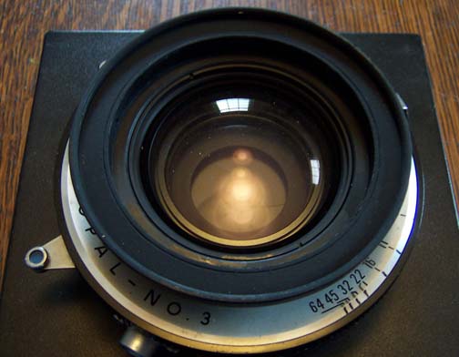

Since the G-Claron is symmetrical you might consider mounting the front lens on the rear of the shutter. Oh wait are the shutter threads the same on the rear as the front on a copal 3? If so that would work.
I use a standard stack of 82mm filters and it covers all my lenses except the 210 super angulon. When I used a G-Claron 355 I had a 77-82 step ring for it. On one of my user process lenses I mounted an adapter on the front so it can accept 82mm filters. Essentially I epoxy a step up ring to the outside front lens barrel from whatever the lens accepts to get to my 82mm filter. I did have to custom machine the adapter on the lathe so it slid perfectly onto the lens.
They are just inexpensive process lenses so I am really not concerned about epoxy on the outer barrel and if done right it looks very professional. I would not do this to some pricey lens of course but I have one on my Konica Hex GRii 260mm.
