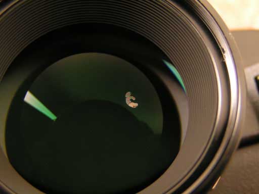

Hello all,

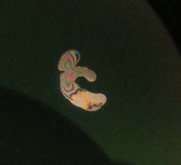

Last May I purchased a Pentax digital spot meter and have happily used it on and off over the summer. However, just a few days ago I noticed an abnormality in the lens that wasn't there when I bought it (see images). The aberration is not on the external surface of the lens, but seems to be below the surface (possibly in the back side of the lens). Does anybody know what this could be? I'm not sure when or how this happened, but I think it occurred in the past few months. I live in the wonderfully humid area of Washington DC, so it could be moisture related. However, I've never done anything extreme to the meter (i.e. I've never dropped it, spilled water on it, etc), so I really don't know how to explain it. If anyone has any ideas, I'd really appreciate it. Thanks.
Dan
1659406678
1658543761
Looks like lens separation
You've got silvery reflective surface combined with rainbow refractions. Compare photos before you noticed this with current photos to see if it's affecting the images.
Separation. The newton's rings are a classic consequence.
I don't know for sure but in another view when it turns we can see if it's a girl or a boy.
Seriously, does it look like it's on the outside or inside of the glass? If it stays the same it may not matter as long as you are getting consistence readings. It's not like a lens that can be stopped down though but looks really small at least.
You are ok it is off to the side and out of the line of sight for the photocell. A new lens can be put in.
