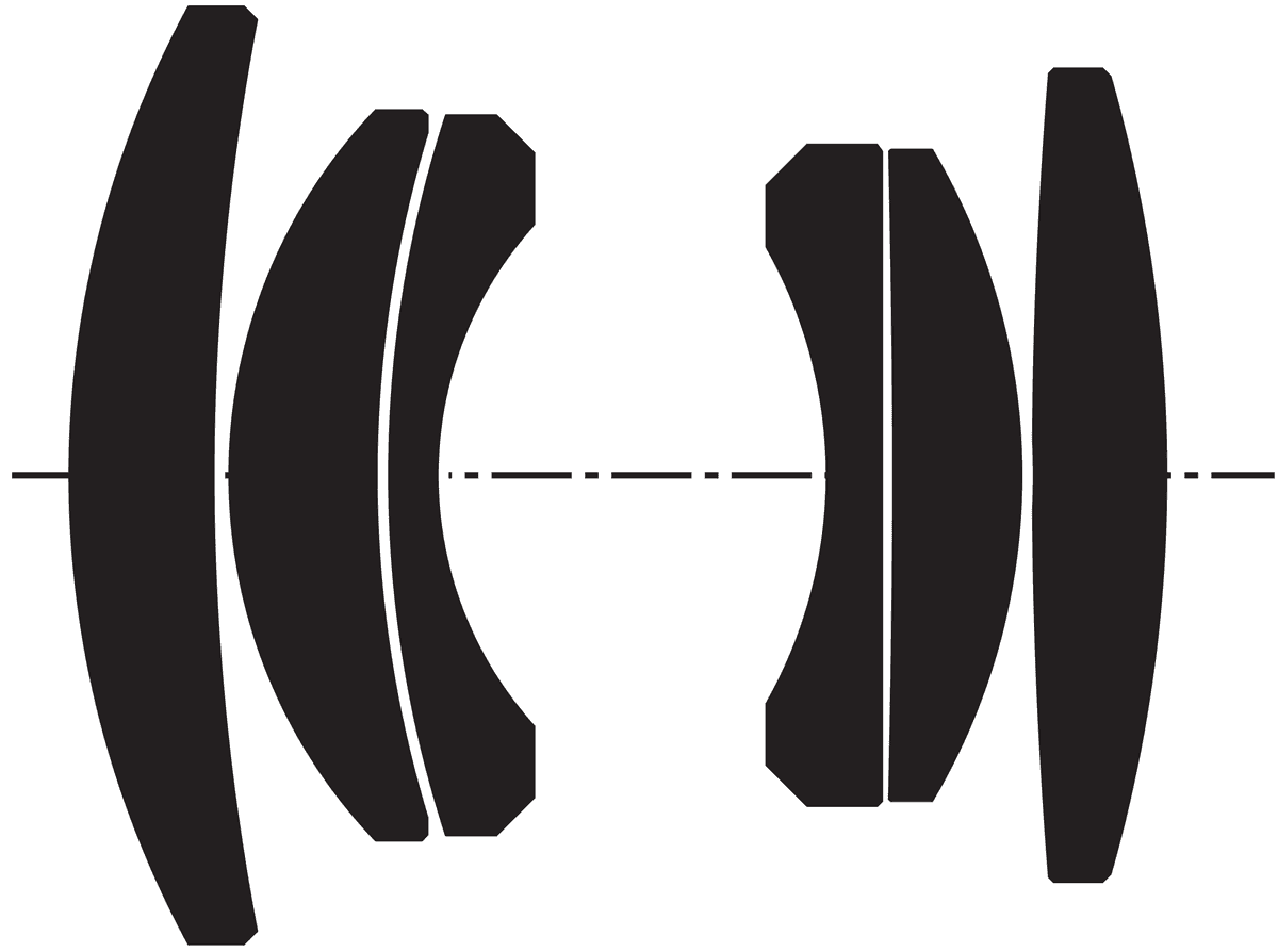

It is not a subjective call
The type IV cron has three plane surfaces
The ZM Planar has two
Before Mandler published his PhD this had not been done for Double Gauss lenses.
So it is 2/3 a type IV cron? ie near enough for me.
If you want picky Zeiss should have kept the two interior surfaces plane.
cuthbert
Nov 16, 2014
822
Sure? May I recommend this article on the history of the planar?
http://vintage-camera-lenses.com/carl-zeiss-planar-history-part-1/
check out the cemented surface of the third group in the planar for the 1953 Contarex, it looks pretty flat to me.
http://www.marcocavina.com/articoli_fotografici/Zeiss_Planar_50mm_story/00_pag.htm
The Planargon 35 mm also have four flat surfaces, and the 1955 Planar 55mm f1.4 two in the second element.
I can say that many, many 50mm lenses have many plane surfaces, this was done in the 60s and 70s (and afterwards) to simplify production costs. Those lenses (for example the Canon FL 50/1.8 II, and FD 50/1.8) can't really be regarded "clones"of some other lenses. Even if the design looks the same (6/4 or 6/5 double gauss), the glass choices, diameters and overall computation and optimization can differ greatly.
Nodda Duma
Jan 22, 2013
2,685
Batesville, Arkansas
flavio is correct. Do you work with optics? :smile:
Today it's not as common to maximize plane surfaces because blocking many lenses and test plate matching for spherical surfaces is now just as cost effective.
Btw lens designers very rarely share the details of their optimization methods (ie their merit functions) with anyone outside the company they work for.
