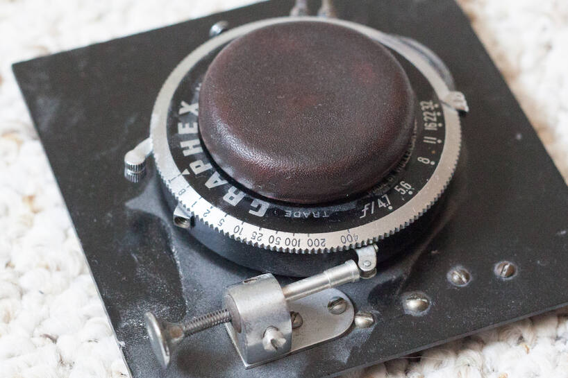

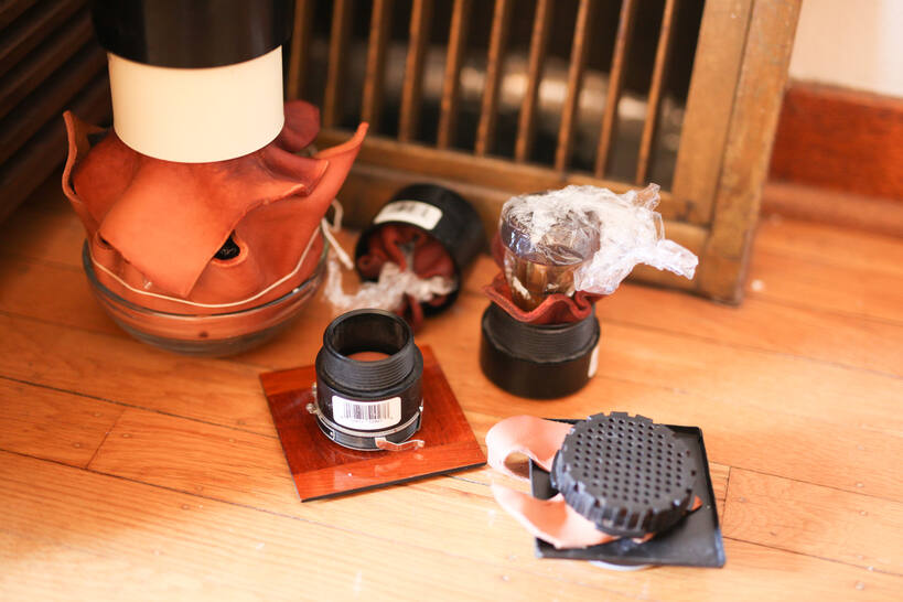

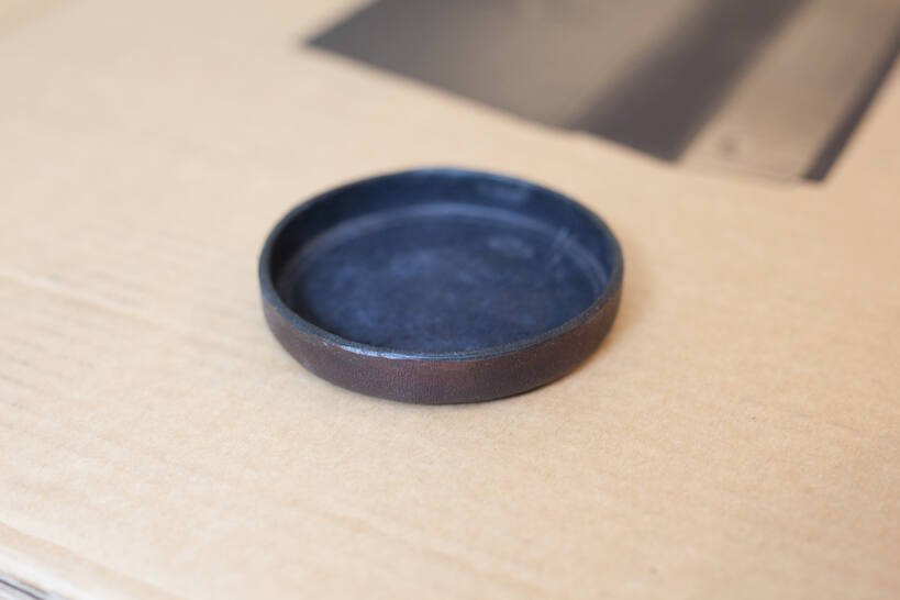

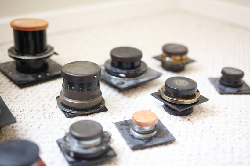

Attached are pictures of today's work in progress and some lest caps I have made in the past.

Finished all 6 caps ab hour into Sunday. Spent most of yesterday working and waiting for various drying steps, and finished the last dying, polishing and burnishing this morning. A few shrank more than I would have liked overnight, but no real failures. If you wet the leather in boiling water, it will thicken, shrink and harden very soon after becoming flexible so be careful. It will yield much harder caps, but I find the slight flex if you use only cold water perfectly acceptable. Water based dye leaves a slight green sheen, but clears up nicely with some dubbin wax.
