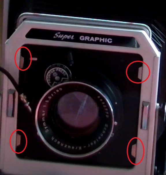

This is really an amateur question, so I hope you'll be able to help me. I am trying to change the lens on my Graflex Super Graphic. I removed the lens board first. There are 4 clips that need to be pushed in and the lens board is released. I removed the lens board with no issues, but those clips are not retracting back. I was wondering - is there some kind of spring mechanism that is aged/rusty or am I doing something wrong. I could not find any videos online and the camera manual does not give any information regarding the board removal, so I hope anybody on this forum can give me some help. Thank you very much.

The sliders may also have stiffened with age. Working them back and forth should fix that. I've sprayed them with electronics cleaner (not WD-40 or Liquid Wrench) to clean them. Electronics cleaner does not leave a residue.
There are also several lens boards of that size. The Super and Super Speed took boards with the little bumps on the sides. Pacemaker boards had the bumps on the other two sides. Replacement boards generally had all four bumps, but if you're looking for a board, be sure it has the right bumps.
