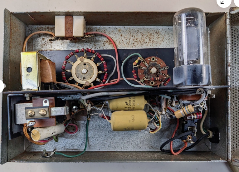

When I tested the accuracy of the exposure times, no matter the time set on the dial, the timer runs about 20% longer than what is called for.
A quick look inside (courtesy of an eBay ad) suggests the timing is probably done with a simple RC network:
If the incorrect times bother you, you could try and calibrate the timer by trimming the capacitor that is responsible for setting the time base. I assume (haphazardly) that the double 1uF (for a total of 2uF) cap is the one of interest. Note it's likely a high-voltage type given the size.
In your place, I would just use a modern timer instead, or if I were bent on using this one, I'd just accept the times as they are as long as they are consistent. My first darkroom timer was also something like 10-20% off. Like you said, print too dark --> cut back exposure. It doesn't really matter if 1 second is 1.0 seconds or 1.2 seconds, after all.
