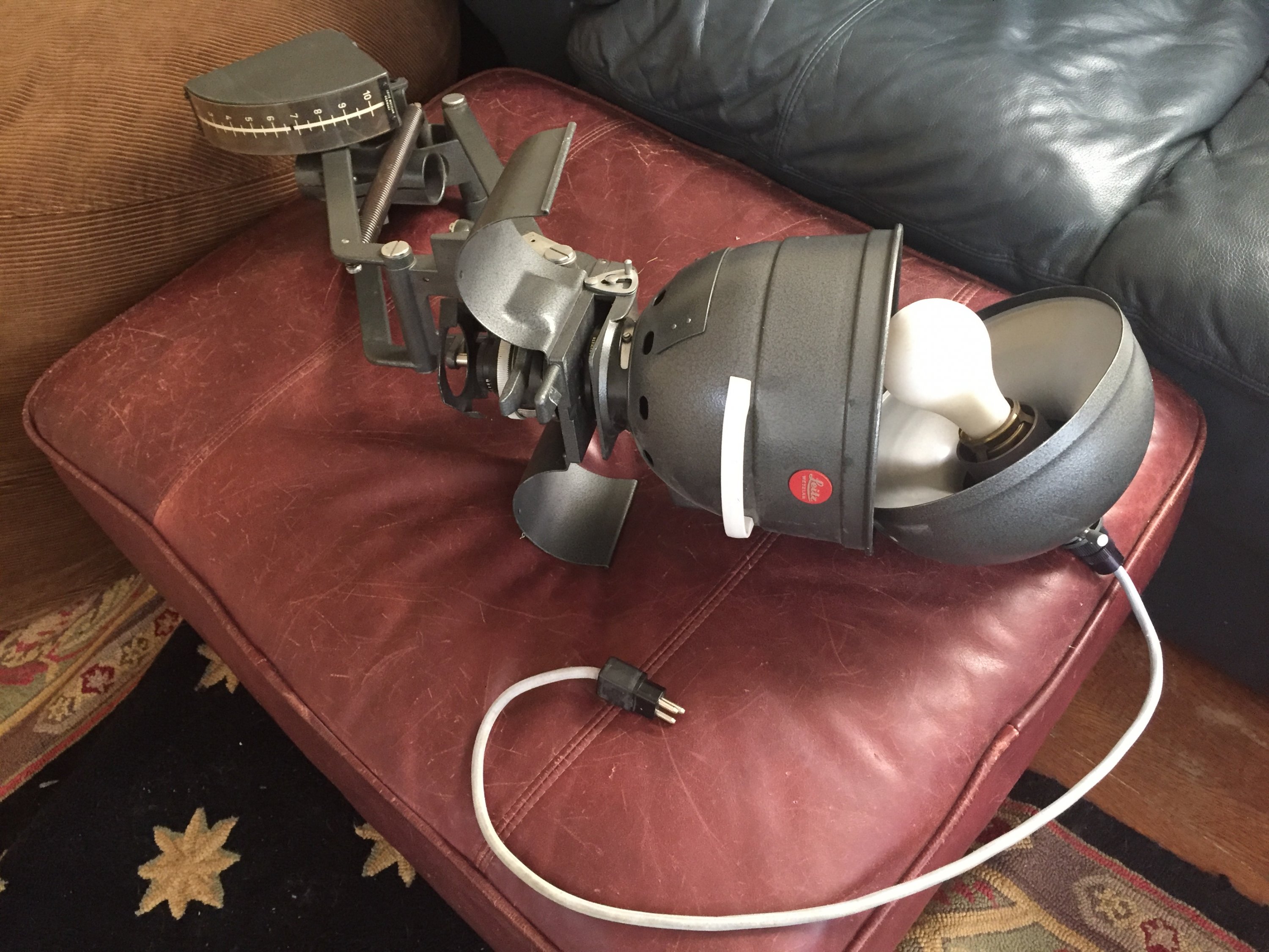

Hey all! I have received a tip but just wanted to verify somewhere else before I buy an item on eBay.
I have a Focomat 1c Color that does not have a stand or a negative carrier. I have been told that the stand for a Valoy is compatible with the Focomat 1c Color, as well as the negative carrier between the two are then same.
Can anyone confirm this before I buy the Valoy?
Do the Valoy and the Valoy II use the same stand as well (just curious)?
Anyone with a Focomat 1c Color have any advice on replacing the height indicator light? This is missing as well, though much less important than the stand and carrier!
Thanks if anyone sees this and has any information for me. The stands look the same in all the image searches I’ve done. The negative carrier is tougher to discern.

I believe the Valoy column is a smaller diameter than the 1C.
The film holder is the same.
The 1C column has the female electrical plug inside the top of the column.
Do you have a sliding filter drawer in your enlarger head?
Dang okay, I may still get it and wrap tape or something around the column to get it to fit..
I believe it does have the filter door, I haven’t pulled it out yet, but there is no tray or anything like that attached to it, it seems to be just a panel. Think I’m missing a piece?
The Valoy II column is very different: it has a rail along which the "arm" moves up and down with a dedicated break-release system.
The earlier Valoy column may be the same diameter as the Focomat Ic column, which is 41mm (is that 1,6 in.?). I can ask someone to measure his Valoy column . . . Your grey Ic normally had a 1,20cm column. There are also shorter Ic columns, I believe 85cm . . .
The Ic in the picture has no filter tray. Just the cover plate that you can pull out. People who weren't going to print colour could buy this version without the optional filter tray. It is very difficult to find those trays, and it is not difficult to modify another brand filter holder for under the lens.
If your scale indicator misses the socket & cord for the bulb as well, I would not bother with that scale indicator.
You need a so-called signal bulb for that. https://www.ebay.de/itm/Neon-Gluhla...h=item56b6634f71:g:croAAOxyW7tRgsAR:rk:7:pf:0
There could be a anti newton glass attached to the bottom of the condenser. You can take that off, be careful with that glass as it is important !
Like the previous poster said, the negative holders are compatible.
Blowing up your picture shows the anti-newton glass attachment is present.
You also have a lens (Focotar?) and below that a filter tray.

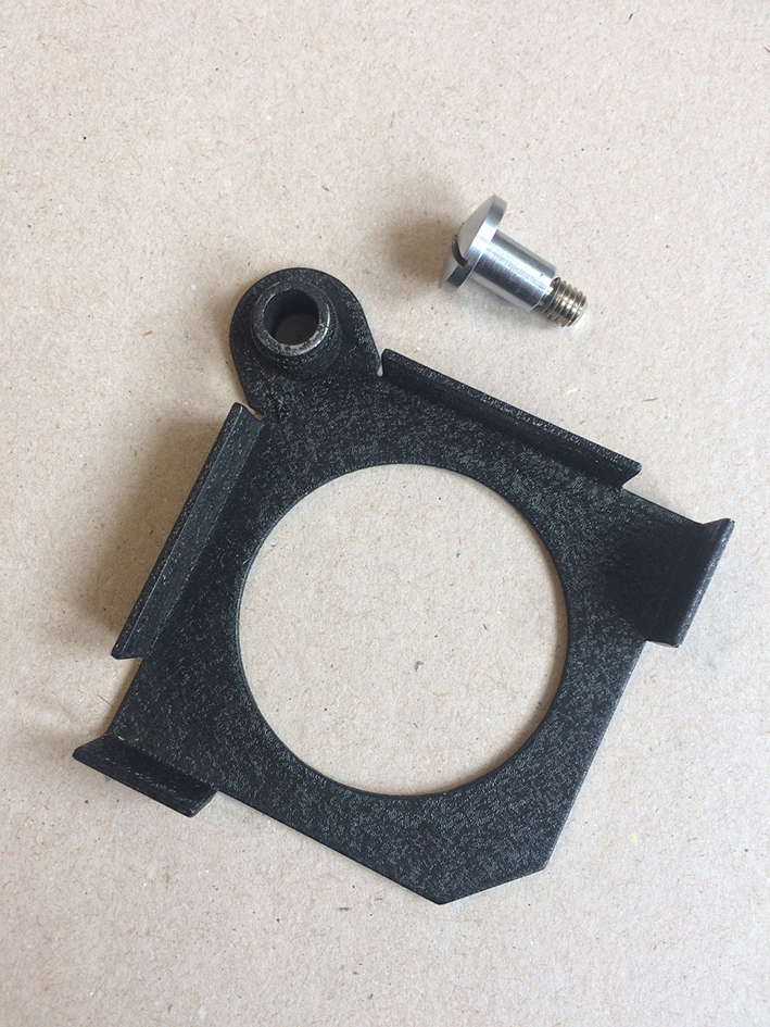

that filter tray, if I am not mistaken, is the rare black wrinkle paint filter holder Leitz USA made for the early round head Focomat Ic !!
Beagleagle, that filter holder means you do not need the filter tray in the head. This holder replaces the red filter, but with a different, longer shoulder screw. If that is present you're in total luck !!
The lens, if a Focotar, looks like either one of the two later versions . . . but difficult to see. Anyway, that would make sense as this grey Ic generally came with one of those.
Thank you everyone for your replies!! I have bought an old Valoy and hoping the stand fits. I am so pumped about this enlarger! Thank you Hilo for the info about the color filter tray, I only do black and white for now so this is perfect. It does have the below lens filter tray, it’s got the AN glass, and the fabled Focotar-2 50mm lens :smile: I won’t worry too much about the indicator, but will check out the link you posted.

Leitz never made filters. They stopped being interested in their enlargers before multigrade came on the market. The lose flexible Ilford filters will work fine and I need to check if the mounted Ilford filters fit this Leitz filter holder. Probably yes. It has been a while since I used the holder.
