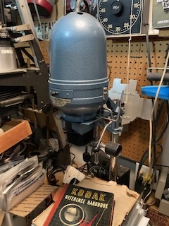

Thank you. I’m in touch with KIENZLE -phototeknik about a carrier. I appreciate your insights. KIENZLE was able to supply me with negative stage glass and 35mm and 21/4 mask for my primos TR66 enlarger.(see photo)
