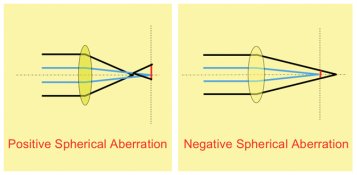

Nomenclature for negative and positive coma and spherical aberration.
Is negative aberration good thing or bad thing

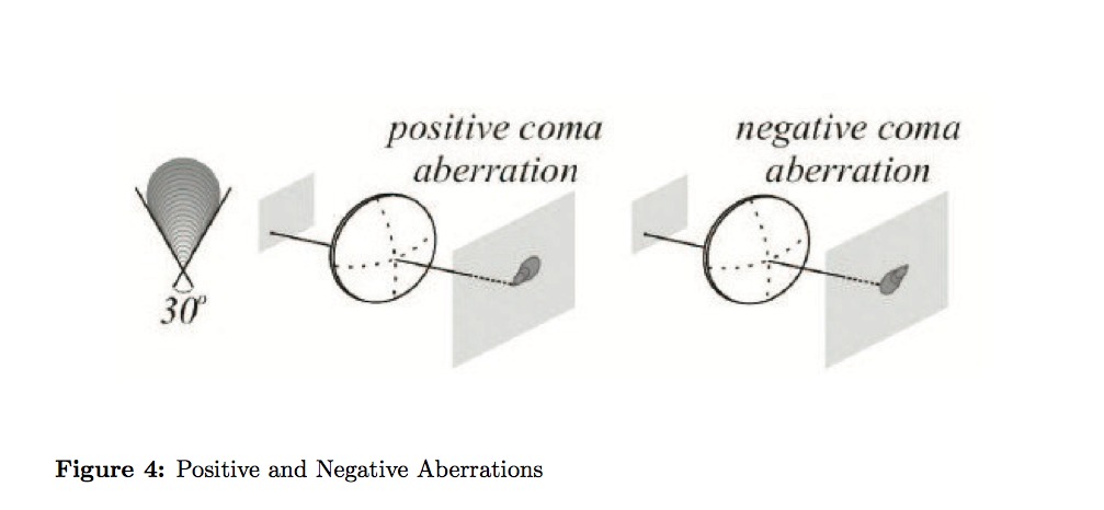

Personally I prefer positive coma, where it seems to point into the picture frame, rather than pointing outward.
ic-racer,
Thank you very much, first time I have ever saw such graphs. Can you explain first graph and your preferenment ?
Umut
That is interesting about sph. aberration.
Since the effective focal point determines the position of the image for any object, the fact there are several different focal points for the different kinds of rays means that there are several “ghost” images formed by the lens – the “real” one determined by the location of the paraxial-ray focal point, and a number of other images that are formed at different distances depending on where the rays that form them struck the lens.
negative coma
when coma is negative, the image produced by the off-axis rays is slightly smaller.

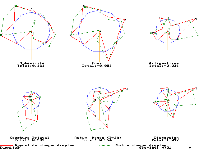

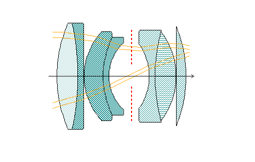

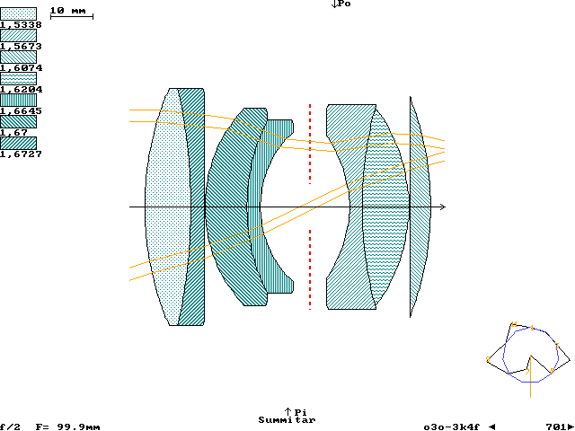

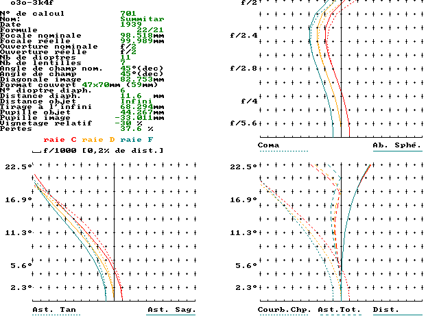

How do you analysis below charts of Leitz Wetzlar Summitar Design Analysis ?
o3o-3k4f
Nº de calcul 701
Nom Summitar
Inventeur _/_
Maison Leitz
Formule 22/21
Date 1939
Focale nominale (mm) 98,52
Focale réelle (mm) 99,99
Ouverture nominale f/2,
Ouverture réelle f/2,
Nb de dioptres 11
Nb de lentilles 7
Angle de champ nominal (ºdec) 45,00
Angle de champ (ºdec) 45,00
Diagonale image 82,83mm
Format couvert 47x70mm (59mm)
Nº dioptre diaph. 6
Distance diaphragme (mm) 11,60
Distance objet (mm) Infini
Tirage à l'infini (mm) 68,38
Pupille objet (mm) 44,24
Pupille image (mm) -32,96
Vignetage relatif (%) -30
Pertes (%) 36,97
Commentaire: DE 0 685 572

Sommes de Seidel: Etats par dioptres
Nø Ab. Sphé. Coma Ast. Sag. Ast. Tan. Ast. Tot. Dist. Petzval
1 0,695 -0,171 -0,547 -0,632 0,042 -1,348 -0,505
2 -0,327 -0,297 0,315 0,855 -0,270 -2,860 0,044
3 0,241 0,429 -0,784 -2,312 0,764 13,958 -0,021
4 0,923 -0,152 -1,232 -1,282 0,025 -2,032 -1,206
5 0,000 -0,001 0,001 -0,005 0,003 0,054 0,004
6 -2,204 0,627 1,876 2,233 -0,178 5,337 1,698
Diaphragme
7 -3,824 -1,400 1,795 2,820 -0,513 -6,572 1,282
8 0,084 -0,089 -0,119 -0,309 0,095 -1,262 -0,024
9 2,391 0,558 -1,141 -1,402 0,130 2,665 -1,011
10 -0,034 -0,098 0,300 0,861 -0,281 -8,609 0,019
11 2,377 0,591 -0,710 -1,004 0,147 1,765 -0,563
Total 0,323 -0,003 -0,247 -0,176 -0,036 1,097 -0,283
Sommes de Seidel: Totaux par dioptres
Nº Ab. Sphé. Coma Ast. Sag. Ast. Tan. Ast. Tot. Dist. Petzval
2 0,368 -0,469 -0,233 0,224 -0,228 -4,207 -0,461
3 0,609 -0,039 -1,017 -2,088 0,535 9,750 -0,482
4 1,532 -0,192 -2,249 -3,370 0,560 7,718 -1,688
5 1,532 -0,192 -2,248 -3,375 0,564 7,773 -1,684
6 -0,672 0,435 -0,372 -1,142 0,385 13,110 0,014
Diaphragme
7 -4,495 -0,966 1,423 1,678 -0,127 6,538 1,296
8 -4,411 -1,055 1,305 1,369 -0,032 5,276 1,272
9 -2,021 -0,497 0,163 -0,033 0,098 7,941 0,261
10 -2,055 -0,594 0,463 0,828 -0,182 -0,668 0,281
11 0,323 -0,003 -0,247 -0,176 -0,036 1,097 -0,283
Valeurs des aberrations du 3ème ordre:
% Ab. Sphé. Coma Ast. Sag. Ast. Tan. Ast. Tot. Courb. Dist.
10% -0,010 -0,010 -0,019 -0,014 0,005 -0,016 0,000
20% -0,039 -0,039 -0,075 -0,054 0,021 -0,065 0,003
30% -0,085 -0,084 -0,165 -0,122 0,043 -0,144 0,009
40% -0,142 -0,141 -0,284 -0,218 0,067 -0,251 0,022
50% -0,204 -0,201 -0,427 -0,341 0,086 -0,384 0,042
60% -0,261 -0,254 -0,583 -0,493 0,089 -0,538 0,074
70% -0,299 -0,284 -0,742 -0,676 0,066 -0,709 0,119
80% -0,298 -0,268 -0,892 -0,890 0,001 -0,891 0,179
90% -0,233 -0,173 -1,017 -1,138 0,122 -1,077 0,258
100% -0,074 0,049 -1,099 -1,417 0,318 -1,258 0,358
