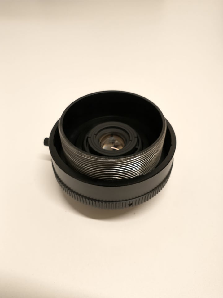

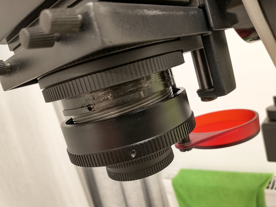

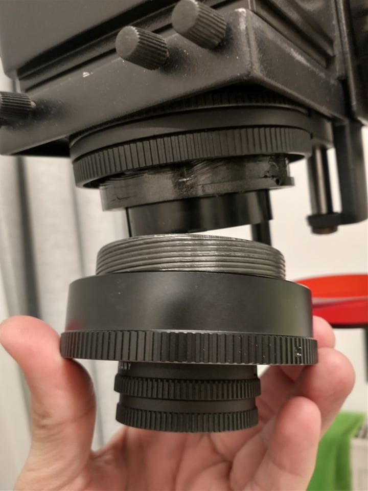

Dear all,
Another Leitz V35 user messing up with the autofocus setup here. I would be very grateful if any of you could help me out. By now I'm just confused and disappointed, as I paid a lot for the enlarger and, above all, I was looking forward to using it and start my darkroom experience!

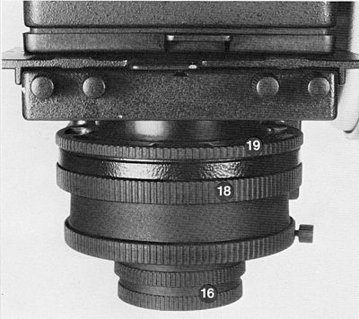

The enlarger I just bought is in mint condition. The big problem is the focus ring. Following the instruction manual, I tried to set up the autofocus by (I quote):
(1) Set column height to the height of the printing easel or to 0 if you don't use an easel.
(2) Set head's position to its highest position.
(3) Focus with the large helicoidal ring.
(4) If the ring is outside the notch, unscrew the knob (17) on it and turn the ring (15) while maintaining the lens (16) with the other hand until you reach the notch. Screw the knob (17) and check the focus again.
Since I was not sure whether the helicoidal ring was in the notch, I did (4). However, nothing happened, in the sense that, when I unscrewed the knob and turned the ring while maintaining the lens, the ring simply ran around without doing anything, least of all reaching the notch. In fact, after unscrewing the knob, it was only by turning the knurled ring of the lens (16) that the helicoid system moved up and down at all.

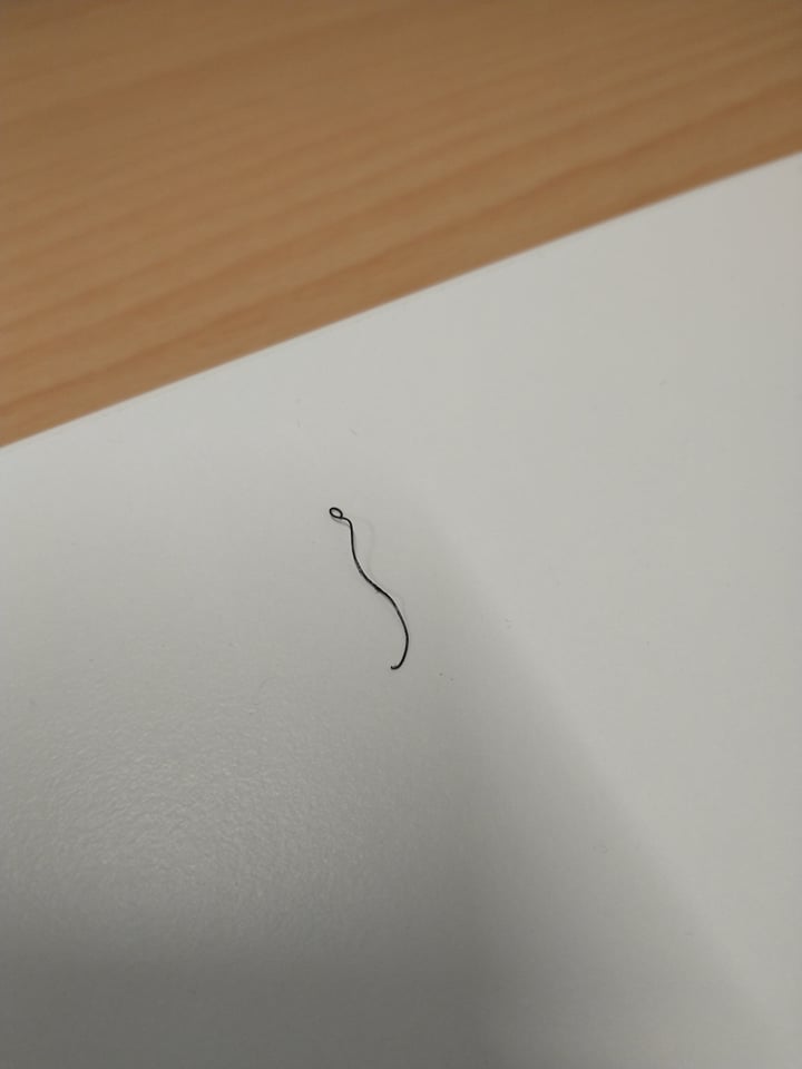

In the end, I loosened the ring to the point of unscrewing it completely. By doing so,I found a tiny spring, which was making resistance to the act of turning (it was simply stuck to the wall of the helicoid), and no ball bearing. Attached you can find the pictures. But probably the following two videos that I uploaded on YouTube are more helpful.
In the first video, you can clearly see how the focus ring spins without making any "click":
youtube.com/shorts/yZFIid34suk?feature=share
In the second video, you can see how I found the spring while turning the helicoid ring. I had to use a plier to take it out!
youtube.com/shorts/gkGglpaPCH8?feature=share
Did the previous owner miss the ball bearing and mess up with the spring? Is this the reason why the focus ring runs around and nothing happens? Is there any solution I can find? Thanks guys...
P.S. By the way, I also removed the Focotar lens to check its state. However, after I screwed it in place, there is no way to unscrew it again. Any advice on what to do when this happens?

As a SWAG, when the previous owner(or someone)was in there, The spring was deformed when the critter was reassembled without the ball last time.
The spring should go in a hole possibly the third picture and a ball bearing would go on top of it. this fits inside the ring that goes over it to
give the click stop. The spring is a COIL spring and was likely deformed when the ball was lost causing the scratches seen on the inner barrel.
You can measure the loop at the end of the spring to get the diameters and s small wire to measure the depth. the diameter of the loop is
probably the same as the diameter of the ball should be.
I haven't had a V35 for years so can't help that. Sorry that doesn't help with the assembly.

Thank you very much for your reply John. I'll try to get a new spring and ball!!! Luckily the measure of both can be find online.
