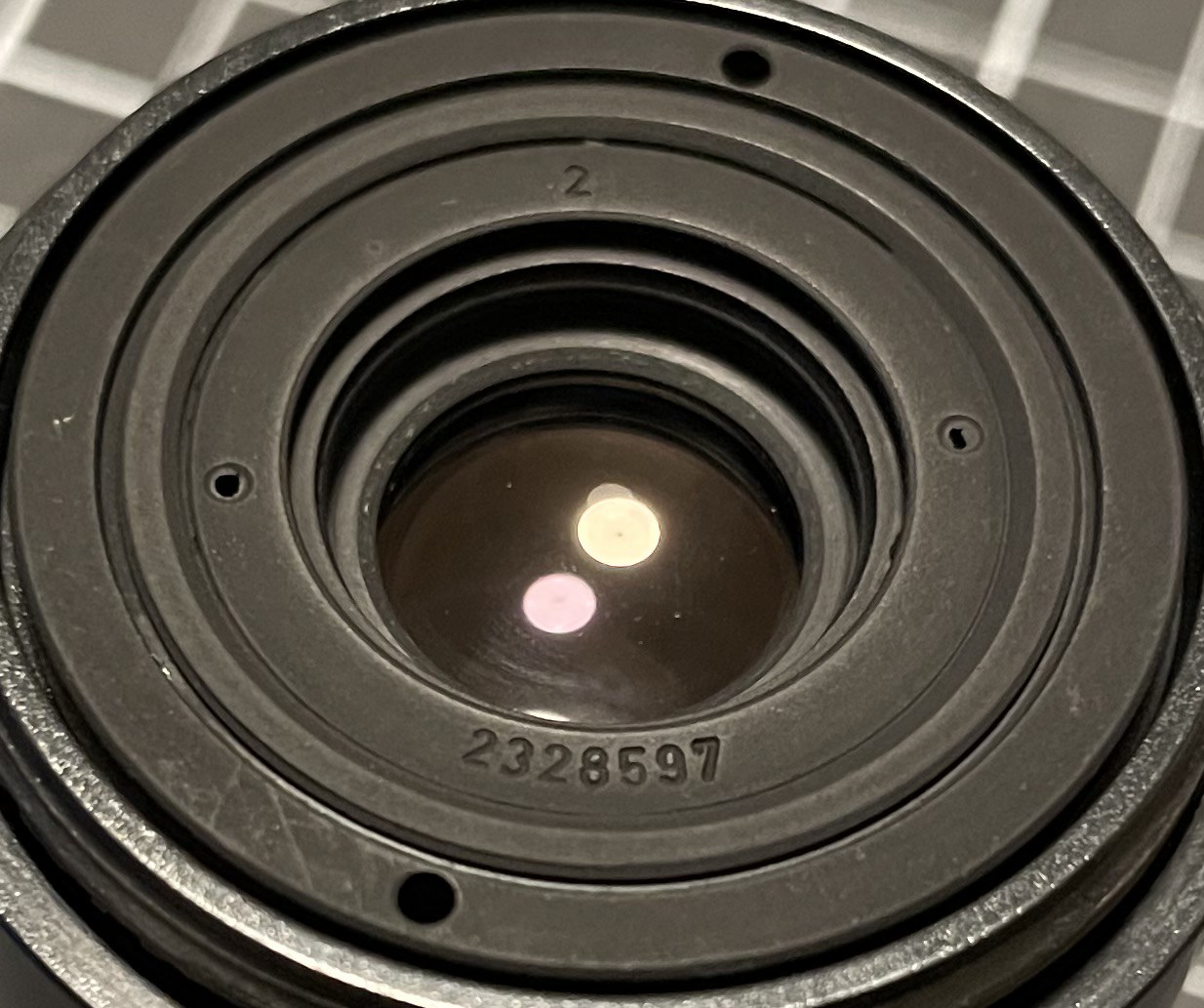

Here my 60mm Focotar. I was wrong, I have only one as I gave the second away . . . Same story more or less: the serial number indicates 1969 and the 2 is clearly visible.

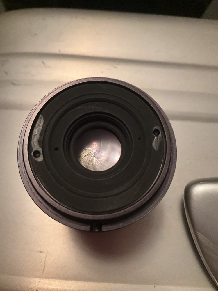

Mine looks quite different! Also shot mounted on IIC with lens positioned to show code word on 60.

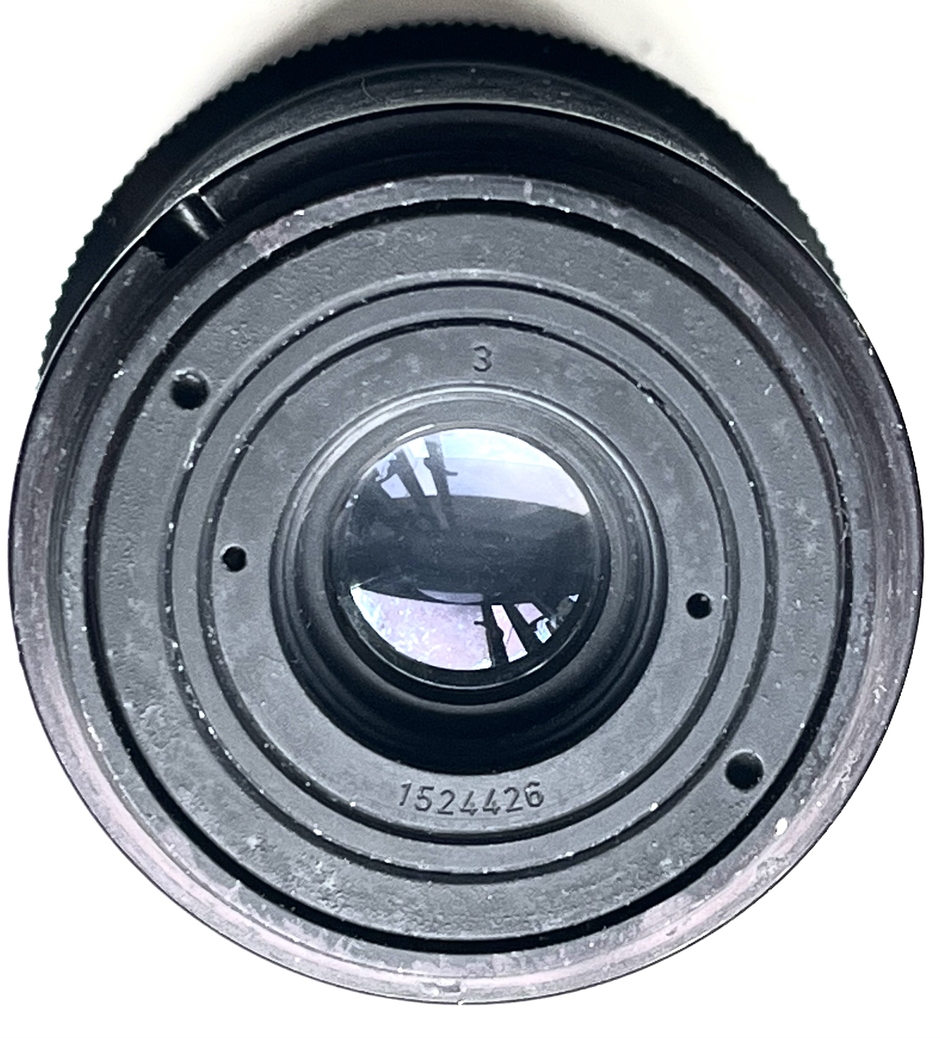

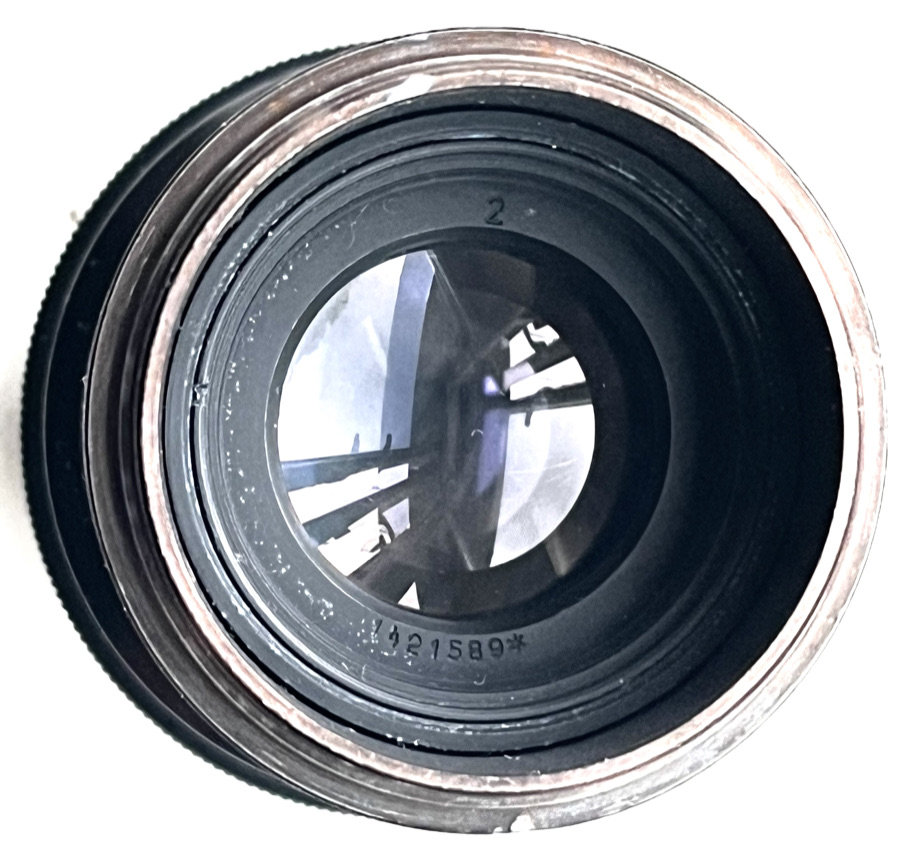

After chancing across this thread, out of curiosity I had a close look at my early Focomat IIc and its two Focotars - a 6cm f4.5 (1957) and a 9.5cm f4.5 (1956). I have nothing substantive to add to the discourse except the images of the rear of both lenses with serial number and accompanying mystery single-digit number. The 9.5cm lens comes with an asterisked serial number, making it a possible duplicate.
Re: the mystery single-digit number, I wonder if it indicates the actual focal length of the lens, as opposed to the given length. So, the number "3" on the 6cm lens would translate to an actual focal length of 6.3cm, while the number "2" on the 9.5cm lens would make it an actual 9.7cm lens. I vaguely recall that this or some similar methodology was employed by Leitz when marking their (I think) their 50mm M lenses many moons ago.
Thoughts?
