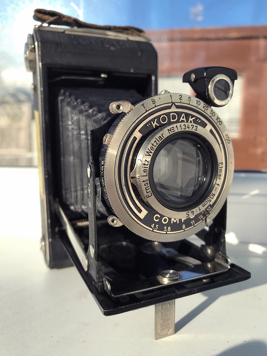

I found a bit unusual lens on a Kodak/Nagel Vollenda 620 folding camera today: it is a Leitz Elmar 10.5cm f4.5 front cell focus lens on Compur shutter. I guess it is a Tessar formula lens. But I did not find much literature on the Internet about Leica/Leitz made medium format lenses in general nor this lens in particular. Do any of you have any more information from printed references?
Thanks!

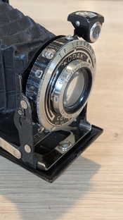

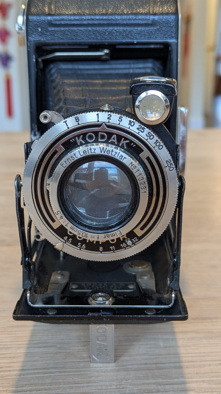

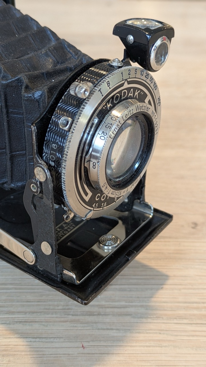

My sample looks almost identical to the Leitz Photographica (Westlicht) auction item, and the serial number is very close.
