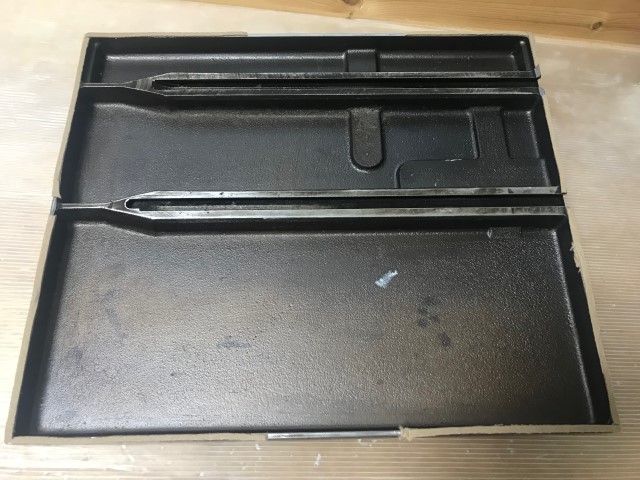

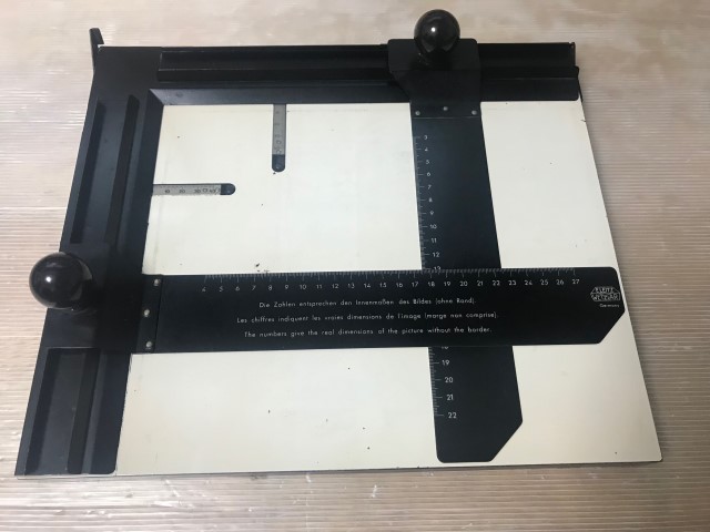

Dear all,
I have recently purchased 2 Focomats and they each came with a different easel. With the Ic I got a two bladed cast iron (or so it seems to me) easel that takes paper up to the size of 22cm X 27cm.
The Focomat IIc I got came with a smaller easel, also two bladed and has a wooden base.
Both easels have the grooves for the clamping mechanism on the baseboard.
My question is about the easel i mentioned first.
It has a steel or alloy base and is a little shorter than the wooden one. The wood based one measures 2.5cm's in height which is the default for Leitz easels I think and works with the autofocus using the normal pin on the Ic and the 25mm setting on the IIc's column.
The other one is 23mm and seems to be rather odd. The Ic it came with had an exactly 23mm tall spacer ring on it so it could be used by having the pin in the lower hole of the column and the ring on top of it.
Is this standard that the easel is 23mm tall or it's missing some anti-scratch layer from the bottom?
I was rather worried using this on the nice wooden baseboard, it would perhaps scratch it all over.
What I did is I added some felt to the bottom and it is now not scratching and also this lifted the base to 25mm so it is standard.
Any hints on what I have? Can't seem to find this easel anywhere on Google with the steel base, just the wooden one. And why is it 23mm only and is that spacer ring that came with it from Leitz or some custom design?

The top:
The bottom:

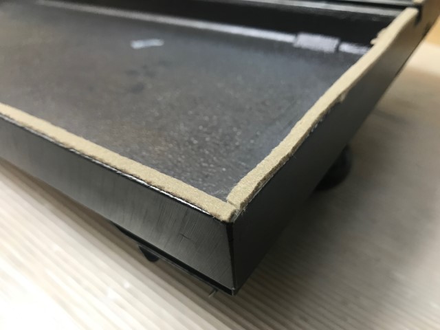

The felt I added to make it 25mm and non-scratching

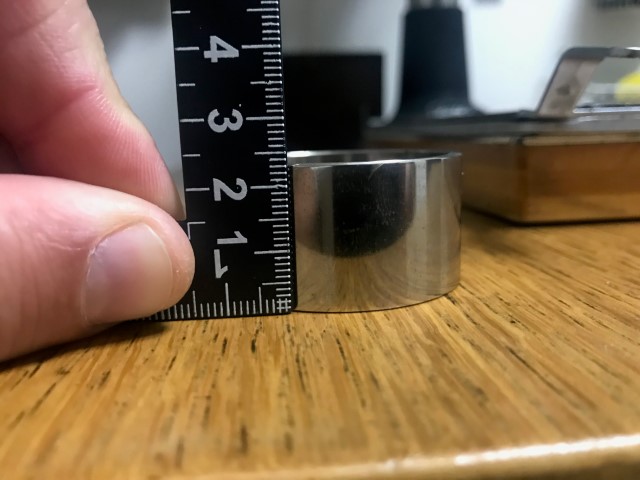

And the spacer ring of 23mm
I have 3 of the wood easels; that metal one looks like the wood base has been stripped off. The 23mm spacer is probaly custom made, but not by Leitz I don't think.
Thanks Chip. It is indeed a mystery but it doesn't seem to me that the wood was stripped off as the the size of the sidewalls would not allow for any covering, it would stick out then.

The one in your web post reference has a base, yours does NOT have a base.
I got a 8x10 Leitz easel that is only 3mm in height. Base is a flat steel plate with its underside coverd by PVC foil and it got 3 sunk in screwholes seemingly to mount it to a wooden adapter plate offered seperately by Leitz.
What do you mean my does not have a base? It is 23mm in height, only 2mm short of the other wooden easel. You mean to say the base is 2mm thick only on every Leitz easel?
I think mine is just a different version where the base is metal too.
What AgX mentions is yes another easel, 3mm tall and is optionally attached to a block of wood with the clamping mechanism at the bottom. I have one of those too with the wooden base and undoing the screws I can take the plate off and use it without the board.
The one I am showing in my post above has a base and is only 2mm shy of the normal easel's height. The one I linked in from Austria in my 2nd post is also looking like just mine, too bad we can't see the underside.

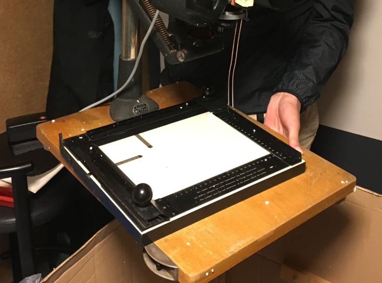

Here's another photo of my easel 1 minute after I opened the package that came from Germany, it traveled clamped onto my Ic's board.
Maybe here you can see the base better.
