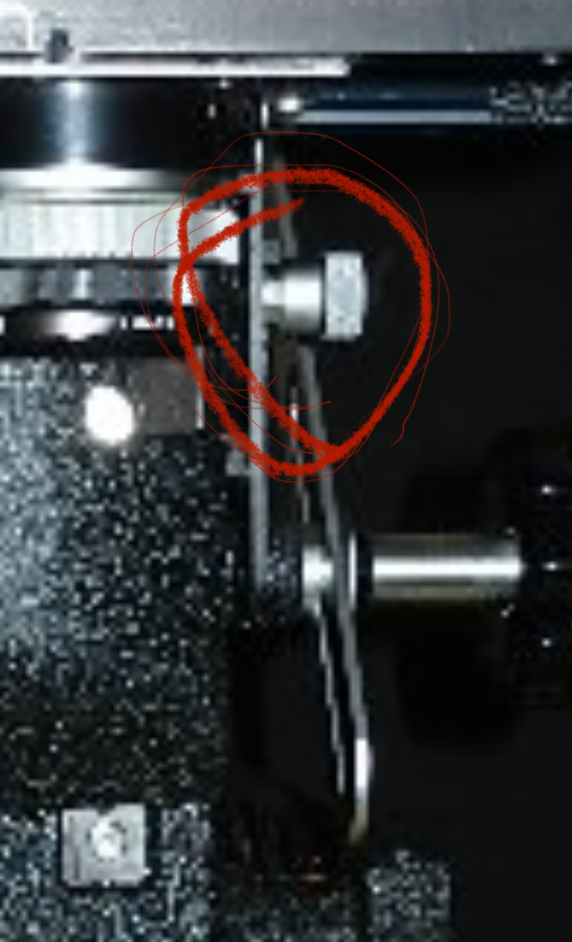

Pull out this pin

Arggghh, that pin again!!! Bravo NB23 !

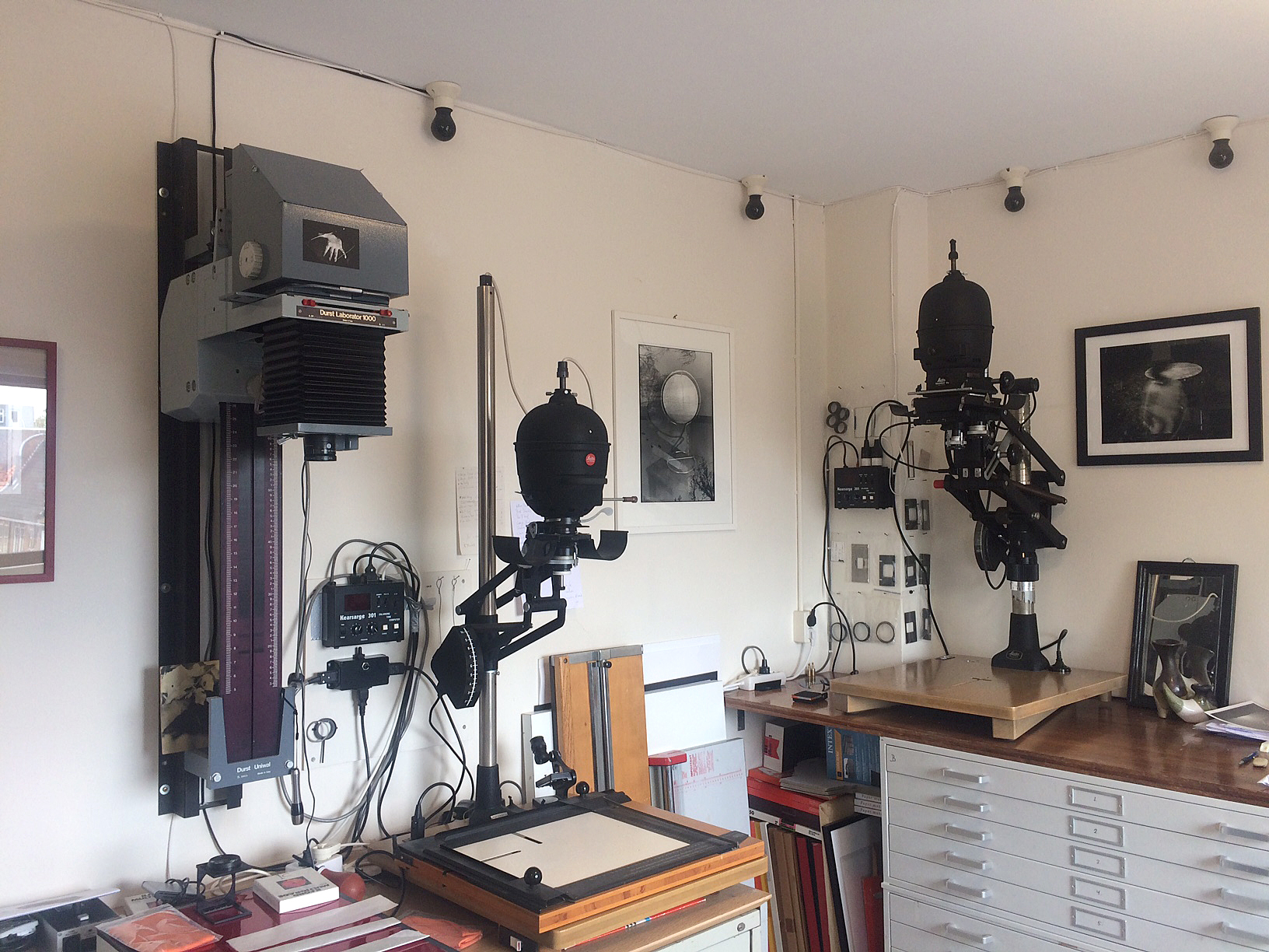

I share your enthusiasm. I use this enlarger since the late seventies. When a moment comes, that I have to downsize my darkroom, it is the IIc that would stay.
And, I do feel there are more as good enlargers around. Some do good things one can't do with a IIc.
Large darkrooms help, but are not a must. Sofar, I am just lucky in that respect.
