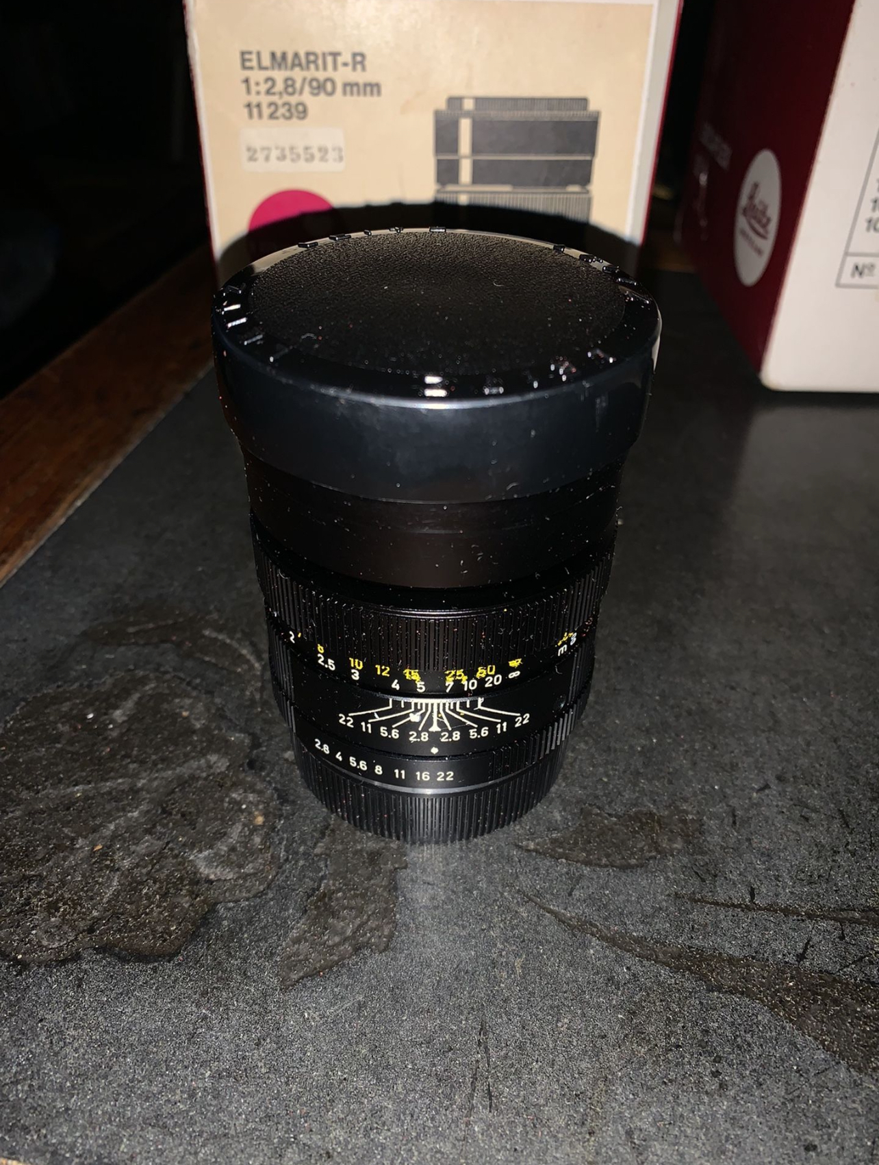

Good day all,
I hope the week is treating you well thusfar. I came to ask for some of your opinions, as I am usually good with pricing of cameras/lenses, though this is a brand I’ve never dealt with. I was looking to purchase a Leicaflex SL, though I’ve read up on the SL2 as well and have come across one that caught my attention. It’s caught my attention due to it belonging to one owner, it feels like I have the entire carfax. This gentleman was handed down a Leicaflex SL2 to him by this father, along with the original box for the camera body. As well, he is including a 1/2.8 90mm Elmarit lens (with the original box) and a 50mm lens, which I assume is the f/2 Summicron, I have not seen it yet. It comes with a black pentax bag as well, but that’s besides the point. After base cost, shipping, & tax, the total will come out to $790. From what I’m seeing from eBay’s recently sold, this is about the price they are selling for with only one lens, though someone correct me if I’m wrong.
The only thing I’m a bit worried about is that he was upfront and said the camera hasn’t been used in a couple decades. Since it was his father’s and Though he did mention afterwards he took it to a “Leica specialist” and said that after taking a basic look at it, he says it’s perfectly fine. Though, he was not willing to pay for a full diagnostic as he did not want to dish out the money at the time. I appreciate his honesty in the beginning which has me wanting to believe that this man did take it to someone to ensure it’s basic functions were working. I assume “basic testing” means testing to make sure the shutter curtains are functioning properly, shutter speeds seem accurate, etc. He says the battery needs replaced for sure, which implies that I have to roll the dice on, if I purchase it, whether or not I receive a camera with a functioning light meter. I have requested him to send a video showing through the viewfinder, because I believe this is how to tell if there is desilvering of the prism.
Any advice I’d appreciate. All input will be taken. Will upload better photos when I receive more.
Thanks all,
Gabe

It's a recoverable amount of money. Just by selling the items separately, you can get the money back - probably more. And that's even if there are problems you don't know about. I'd consider buying it pretty low risk.
Nitroplait
Jul 13, 2020
855
Europe (EU)
There is a limit to how much assurance you can get from this kind of seller. I think the price fairly reflects that.
Only you can decide if you can afford the potential risk, and these old cameras always come with a risk of needing an overhaul, and possibly an unrepairable CdS meter.

Almost all of the value is in those two (2-cam?) lenses, and I see that a lens shade is included with the 50/2, and that is a good thing. Optics should be clean and clear, minor haze and a few specks of dust are of no real concern. I'd expect very good performance from those lenses, about on par with better Japanese optics of the era. Whether the lenses are actually worth their typical eBay selling prices is something I'll leave for others to decide! But in terms of de facto market value, you're basically getting the SL2 body as a bonus item.
But manage your expectations: Camera is almost 50 years old, and while it's a true Wetzlar born-and-bred product, Leica SLRs are not iconic in the way the Barnack or M rangefinder cameras are, nor do they have the ultra heavy duty build of a professional N or C product. A "full diagnostic" would basically be a full overhaul, and it's not worth the bother for most sellers. Sherry Krauter may still service the thing, but not all parts are available, and I dunno how much $$ or how long her turnaround times are.

Looks pretty nice in the fuzzy photos. I'd assume that the light meter is non-operational - that leaves open the possibility of an pleasant surprise. Even with a non-op light meter, if the lenses are clean and clear and mechanically in good order, I'd say go for it. Obviously, this also assumes that you trust the seller to actually deliver what is advertised. Good Luck! Let us know how it turns out.
I will say that it seems like an awful lot of money for a 40+ year old SLR and a couple of unremarkable lenses...I guess you need to ask yourself what your goal is. Do you want to take pictures or do you want to collect cool stuff? If you want to get on with actually photography, then there are probably better and less expensive routes....but if you want a piece of Leica History, or a nice museum piece, then this is as good as any. (I'm gonna go put on my asbestos lined teflon jump suit now and try to hide from the Leica fanboys.)

Check the Elmarit closely for haze or fungus. They seem prone to both, ypu should be OK on the 50 Summi. As for the camera, it's a Leicaflex. Put some batteries in it, see if the meter works, you're good to go.
