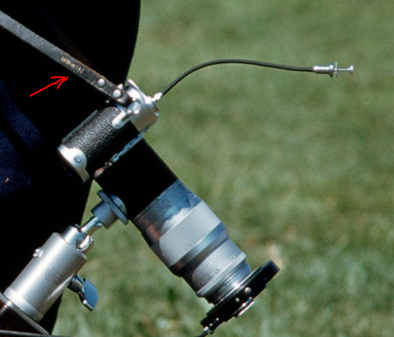

Here we see Ernst Haas sporting on a gunstock seemingly a Leica on "B" with Elmar 135 F4 and front-mounted leaf shutter.
Why would one use in such no-flash, event-photography a leaf shutter when one already got a focal plane one?
(Though it would be a nice makeshift solution for really silent portrait photography with a 35mm FP SLR, which might become another tinkerer project for me.)

The photographer liked long exposures using bulb with a long lens. Much easier to hand hold using a cable release.
Very hard to keep a camera still hand held using the button on the camera.
AgX
Apr 5, 2007
29,972
Germany
You both seem to refer to the gunstock, which is not my point and to which I only referred to describe the situation. (Typically a gunstock is used at far away subjects [thouh I myself use it for close-by too], at which a flash is not very effective.)
And I do not see a flash.
Instead I interpreted
-) the short release cable with arrest-disc as means to arrest the focal plane shutter at "B"
-) the long cable as cable-release connecting a trigger at the gunstock with the leaf-shutter release.
But maybe some shutter specialist can discern between a PC-cord and cable-release based on the connector location at that shutter... But if it is a cable release, how then is that leaf-shutter actuated...? Which I saw as a proof of my idea.
Thus, if there is no flash involved indeed, why use a leaf shutter at such event/location?
The first part is how I see it to.
The second, leaf shutter is set to bulb and is opened and closed by the trigger on the gunstock. Squeeze the trigger and leaf shutter opens, let go of trigger and it closed, or he just sets the shutter speed to what he wants.
He often uses motion blur in his photography.
Interesting technique, might rig something to try the same.

But what advantage does this set up yields to your mind in this very case?
(You too assume no flash is used and obviously there is no shutter-sound issue either at that location.)

A leaf shutter on the end of the lens could be used for multiple exposures.
AgX
Apr 5, 2007
29,972
Germany
Good idea, I did not think of this.
(Likely as I assumed so far that all cameras yield such feature by uncoupling the sprocket wheel as in rewinding.)
Don_ih
Jan 24, 2021
8,247
Ontario
Also, the "bulb" setting on a Leica keeps the shutter open until you wind it shut - which requires you to put your hand over the lens or you'll mess up your shot. A leaf shutter closes upon release (B) or upon another press of the shutter (T).

It's a 135mm f4 Elmar from around 1960-65 on an M3. At first glance the cable release on the camera appears not to be the locking type, however it must be.
It's not a Luc or Prontor shutter or early Dial set Copur, as the controls would be showing, however I do have two unnamed front mounting single speed leaf shutter with wheel controls for I, B, & T on their side.
The B setting on Leica cameras (like all cameras) keeps the shutter open while the shutter button is depressed, it closes when you release it. In this case you would need a locking cable release. There's no flash and these shutters are usually around 1/3o to 1/50 so no advantage with flash synch top speed anyway.
The rifle stock indicates hand held use, not what you would use for multiple exposures, the leaf shutter is quieter than the M3 Leica's FP shutter. My gut feeling this is a wildlife photographer, or someone wanting to shoot without being noticed, he is in a crowd of people.
There is no "B" setting on a Barnack Leica. So, that's III, IIIa, IIIb. Of course, that camera could be a IIIc, IIIf, or IIIg - I don't know. There is only "Z" (time) on a Barnack Leica, and you have to close the shutter by winding.
The rifle stock... someone wanting to shoot without being noticed
I think the rifle stock would be more noticeable in a crowd of people than the incredibly quiet sound of a Leica shutter.

Maybe Haas wanted to avoid focal plane shutter distortion :smile:
It is. The cable release connected to the camera in the picture is of a locking type. I have one just like that.
It's an M series Leica, there's no slow speed dial on the front, plus you can see a light reflection on the straight edge of the hinged back. I was referring to all M Series Leica cameras having B.
bdial is right, I'd overlooked the photographer was Ernst Haas, and the front mounted shutters are self cocking so could be fired in rapid succession. It's the only way Haas could do multiple exposures with a Leica.
Oh, look at that - it is. I guess he traded in his first Leica (bought in 1949) fairly rapidly (when was this photo taken? He doesn't look more than 40-45.).
Anyway. It still makes most sense to do this if you want multiple exposures. I can't see any other good reason.
Well that particular lens was introduced in 1960, and Haast was born in 1921. So that's the right timescale
Now the rifle mount makes sense, if sprung loaded he could fire off multiple exposures quickly. But there are shots using the same multi exposure technique where the camera, or the whole setup is tripod based.

Thank you Don and Bdial, for setting me on that track.
The depicted leaf shutter by its details indeed can be the old version of the Prontor Press shutter with its small dial at the top.
