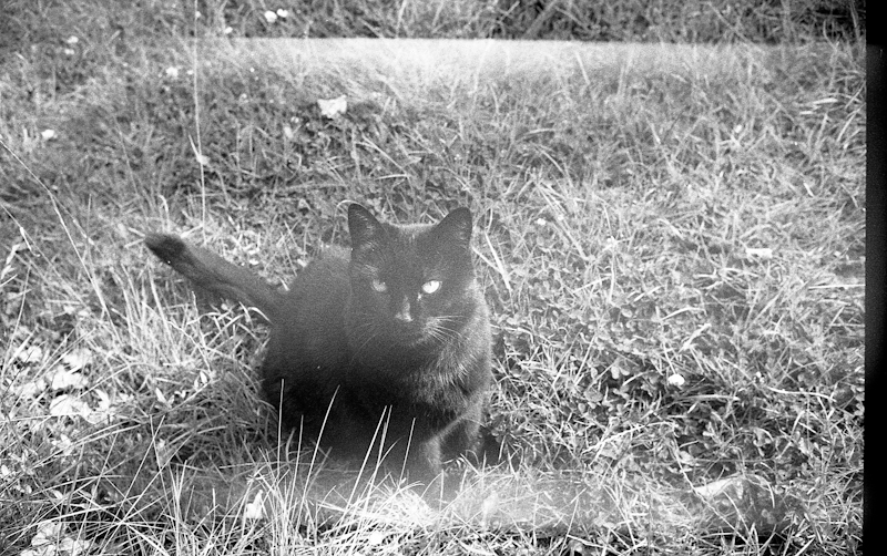

Every so often a shot comes out with these uniform horizontal lines on it. Always top and bottom in this exact position and always only two.
Looks like a shutter problem but it's happening no more than 4 frames out of every 36. I've gone through all the speeds with the lens off and nothing looks out of the ordinary but it happens at fast and a slow shutter speeds.. so any clues?
Ps the black bit at the right is just a particularly sloppy scan, my bad.
Thanks all,
Jake

Quick guess: Looks like a light leak based, not on the shutter speed, but on how long that frame sat in the film gate before it was exposed and moved on to the take-up spool. Is your camera one of those with the door in the back? Do those lines sort of line up with that door?

That crossed my mind too..
Had a quick look at the rest of the scans; the affected frames were sometimes left in for a while, but some of them are when I was shooting pretty rapidly on the street.
The camera does have a door in the back but the film plate covers the film area by a comfortable margin and any frontiers to the outside world would, I think, make vertical lines.
Can't be my processing either, because I've had c-41 done in my local lab and it's the same.

Try a different lab, to check that variable.

light seeping through the shutter curtain -- this happens with my old IIIc which has an original curtain which, I suspect, has grown thin with age, I dunno -- keep the lens from having direct light hit the front element at wide aperature, guard it while changing lenses.

It looks like light leaking around the curtain at the top and bottom. It may be that the curtains aren't running in the track provided for them but instead are running in front of the track, leaving an unbaffled path for light leaks. Probably a flash of sunlight on the camera interior is all it takes.

A quick check with a torch shone through from the front confirms this. As the rangefinder itself also needs adjustment, I'll get it CLA'd.
