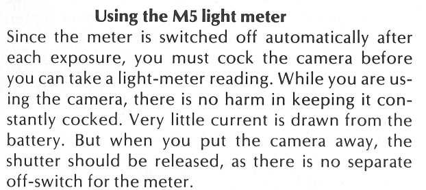

...and what about the M5? How does the meter wortk on that one?
It is only on when the shutter is cocked. The M5 has a mechanical arm with the metering cell that moves into position and turns on when the shutter is cocked. When the shutter release is pressed, the arm swings out of the way before the shutter curtain opens.

Super8
From the book, "the Leica Manual"
So it is agreed that advancing the film after each photograph is a good thing and how a camera is stored depends on the camera design. STILL I fail to see why the OP has a problem with advancing the film immediately after taking a photograph.
It seems that we were posting almost simultaneously.
The Nikon F2 manual explicitly says not to leave the shutter tensioned for more than a day. I think that the Pentax Spotmatic manuals have a similar suggestion.
Perhaps, I just need to go see a shrink for some (more?) cognitive behavioural therapy...I need to find some positive way of thinking about this concept that seems strange and arbitrary to me. I'm sure those Leica engineers thought deeply about this and considered this way as "Correct"...I just need to discover why it is "Correct" and then get with the program! :smile:
