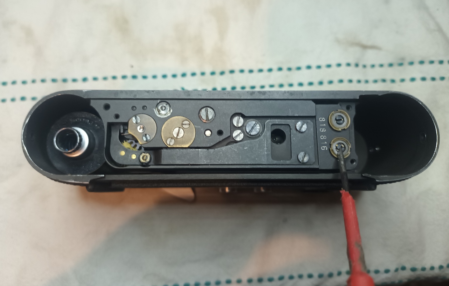

Picked up M3 double stroker the other day, seller said it had some issues including an occasional sticky shutter. I ran a roll through and there was an occasional sticky shutter on the fast speeds.
Checked out a few vids and thought Nobu video was pretty straight forward. So did the adjustment only had to do one rotation anti clockwise and all seems good, will shoot another roll to check.

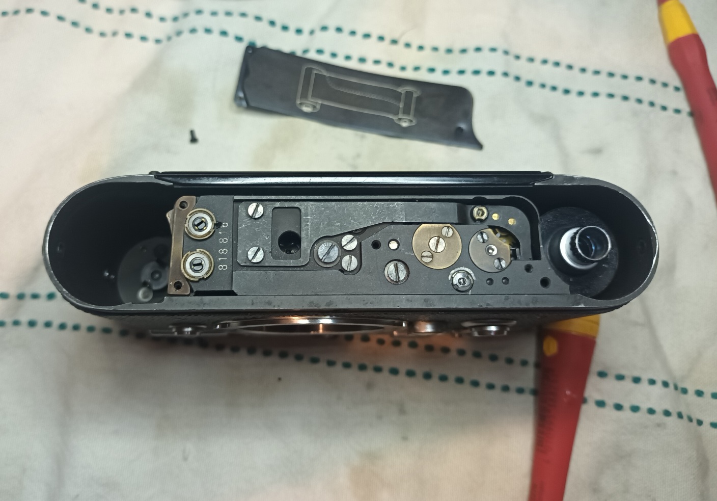

Unscrew 3 screws to take the base plate off and remove the spacer next to the adjustment screws.
Need to find the correct fitting screw driver and insert to to one side of the screw so it covers the pressure washer on one side only and press down and turn anti clockwise. Doesn't seem to work if you push down with the screw driver in the centre. You do this without unscrewing the ring lock.
