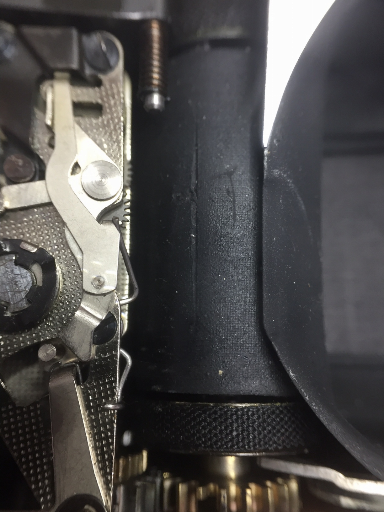

I wonder if anyone has any idea what might be the problem?
My Leica M3 frequently seems to jam on the very first shot I fire with it.
The shutter fires (click, blinds open), but I can't advance/recock (the advance lever is jammed tight/blinds haven't closed.)
But when I move the shutter speed to another gear train/set of speeds, it completes the shutter firing process (whirr, blinds close) and I can advance as normal. Sometimes it just completes the shutter action on its own without changing shutter speeds, maybe 5-30 seconds later.
Thereafter however many times I fire the shutter, it's absolutely fine every single time.
The annoyance has been reproducing this problem for assessment/repair. I've sent it off twice, but they've been unable to reproduce the problem and its returned without further action.
When not in use, I leave the M3 with the shutter cocked. At first I thought maybe I was somehow nudging the self-timer, or it might be something in how I set the shutter speed, but it seems to occur at common speeds (definitely 1/250 and 1/60) and when the camera has just been sitting for a day or two at the speed at which I then fire it (and it jams.)
I'll keep trying to isolate how it's occurring but since it's hard to reproduce, it's been a slow process.

It is probably time for a cla. An unpredictable camera will usually act up at just the wrong time. Send camera off to someone with expertise in m3s. Not exactly an identical problem but I am experiencing unpredictability with a Contax iia. Frustrating isn't it?

Thanks, yes it is frustrating, I yearn to just use it again without issue.
I have sent it for a CLA twice but they've been unable to reproduce the problem. I'll just have to send it off again I think.
1/1000 did it earlier this evening, and rotating the shutter dial to 1/8 released the jam.

I think guangong's right. When it works on the second stroke, old lube has likely been
loosened by the first release.
When you change the shutter dial especially a range that goes in the ranges controlled
with the slow speed escapement, you're moving a lever on the escapement.
If your technician doesn't find a problem, it might help by chilling the camera overnight
when they assess the camera.
The cold may make the fault more apparent.

Following a further assessment by a technician, they were finally able to reproduce the problem.
It turns out the shutter blinds are deteriorating to the extent they've become sticky and one part is getting stuck in the metal strip of the blind.
I have a picture of the blind from that assessment that looks like a partial tear through the fabric where this problem is happening.
So, I have to get the shutter blinds completely replaced (not a service my local technician can perform.)
Any recommendations on where I can get this done, and how much it is likely to cost me?

A picture of the root cause of the problem FWIW.
