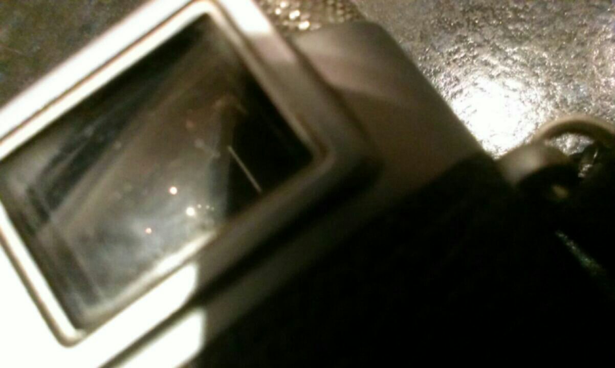

The viewfinder suddenly have this mask as in the photo. Why is it so? Used to be clear and see through. Hope someone can shed some light.

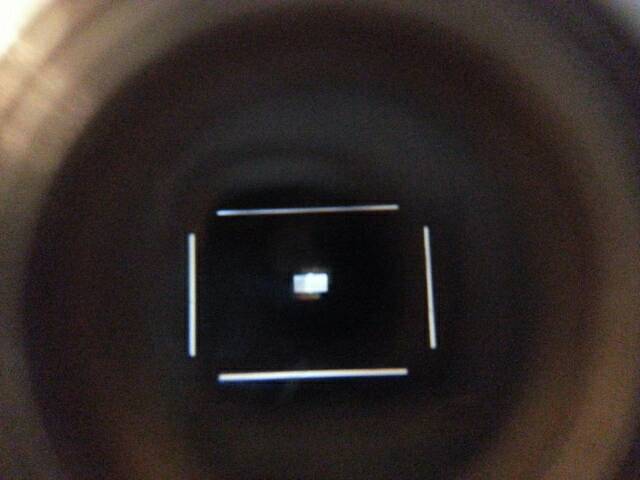

Do you mean the white framelines or the over-all darkness that is in your photo?
It is the overall darkness in the viewfinder. I cannot see through the viewfinder.

Never seen something like that. Some kind of separation of glass elements in the viewfinder. Maybe somebody else will jump in later in thread...
The camera did dropped from the coffee table to the floor recently. Since you mentioned seperation of glass element, it could be a glass prism that seperated.
This is important info - good to know that it did not go that bad from old age, but from drop.
Since it is M1 (no rangefinder, only viewfinder) - I suggest to buy external viewfinder, cheaper than repair.
the mirror in the rangefinder broke off -- even though it doesn't have a rangefinder, it has a bright frame and used the mirror for that.

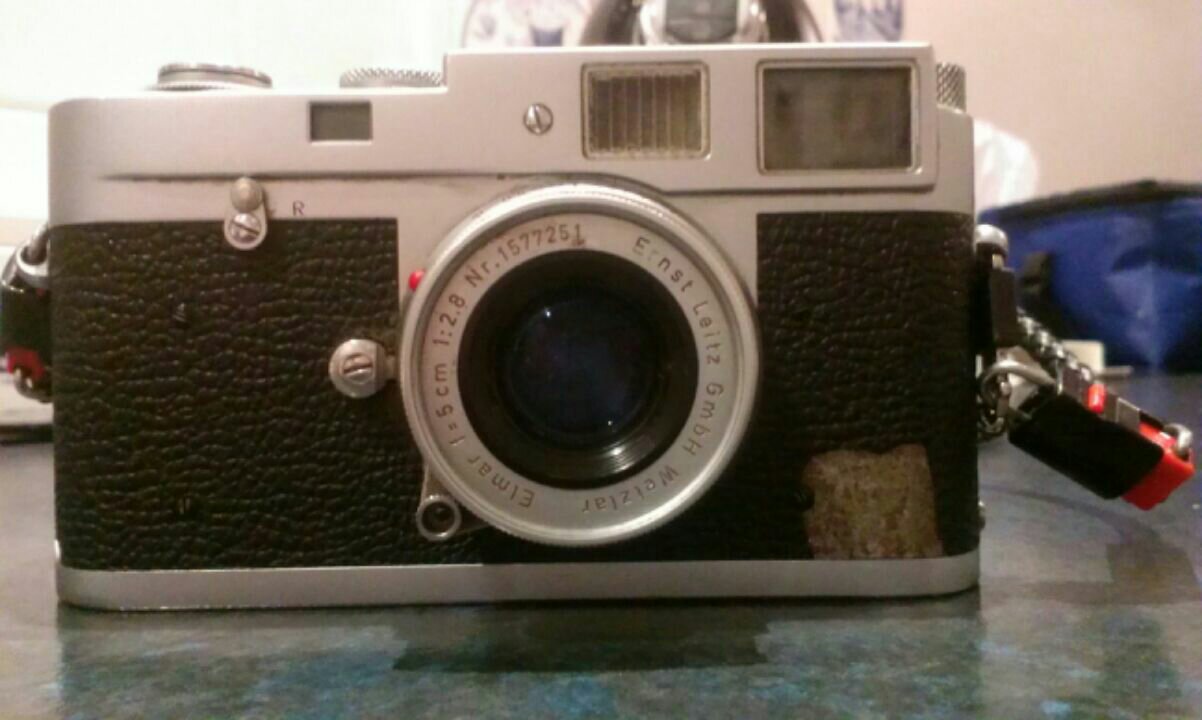

It is supposed to be an M1 according to the year and model, but strangely this one is a morphing model to M2 with a rangefinder

I wonder what is the cost of repair. Is it possible to do a DIY repair

It is not unusual to see M1 upgraded to rangefinder, it was done from time to time. Cost of repair can be higher that camera value (I have read on the internet that they charge up to 300-400€). You can sell the camera and buy "new" used M2 or some other M. I would never try to repair anything in Leica by myself - DIY is a no-no.
