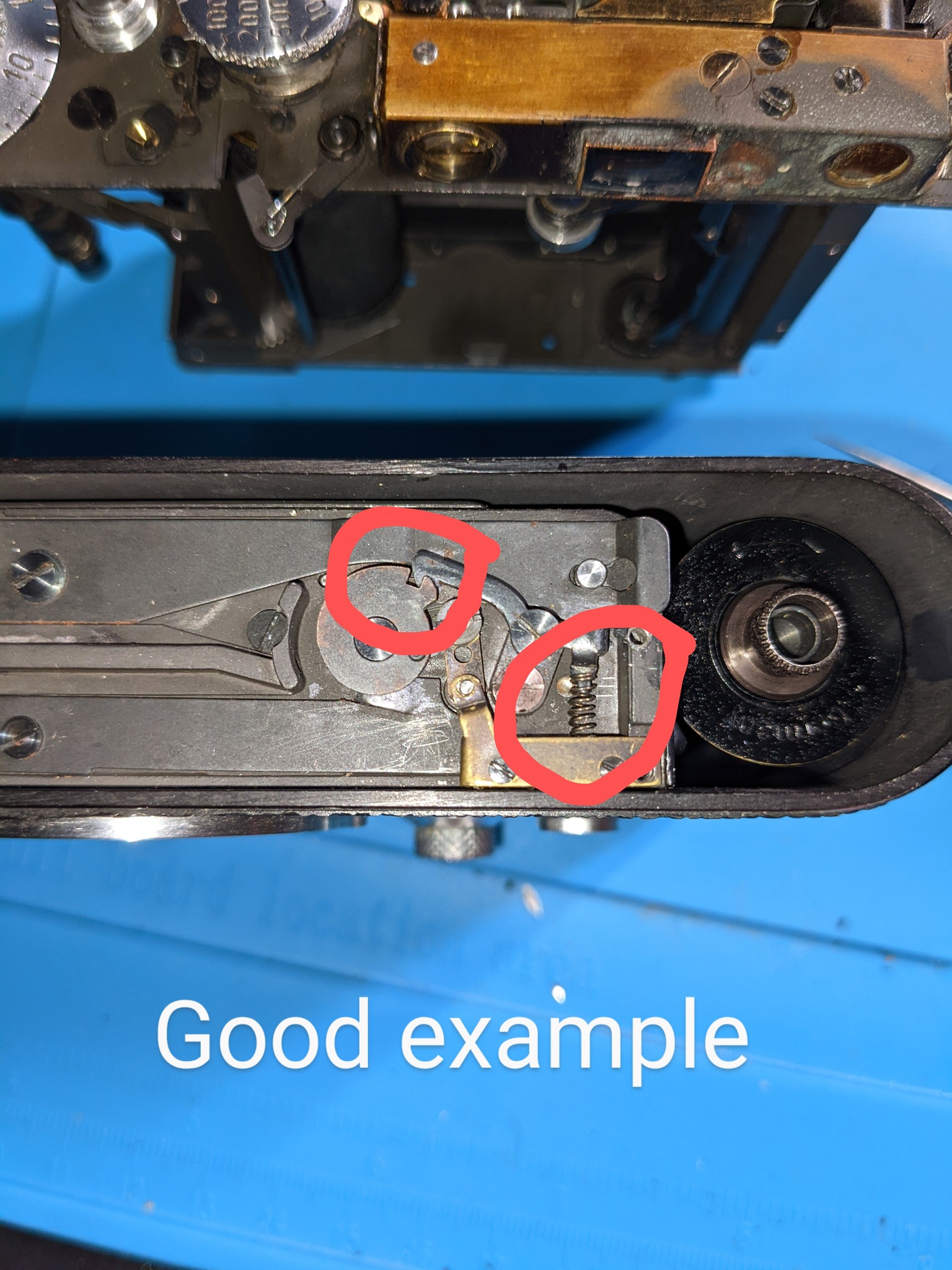

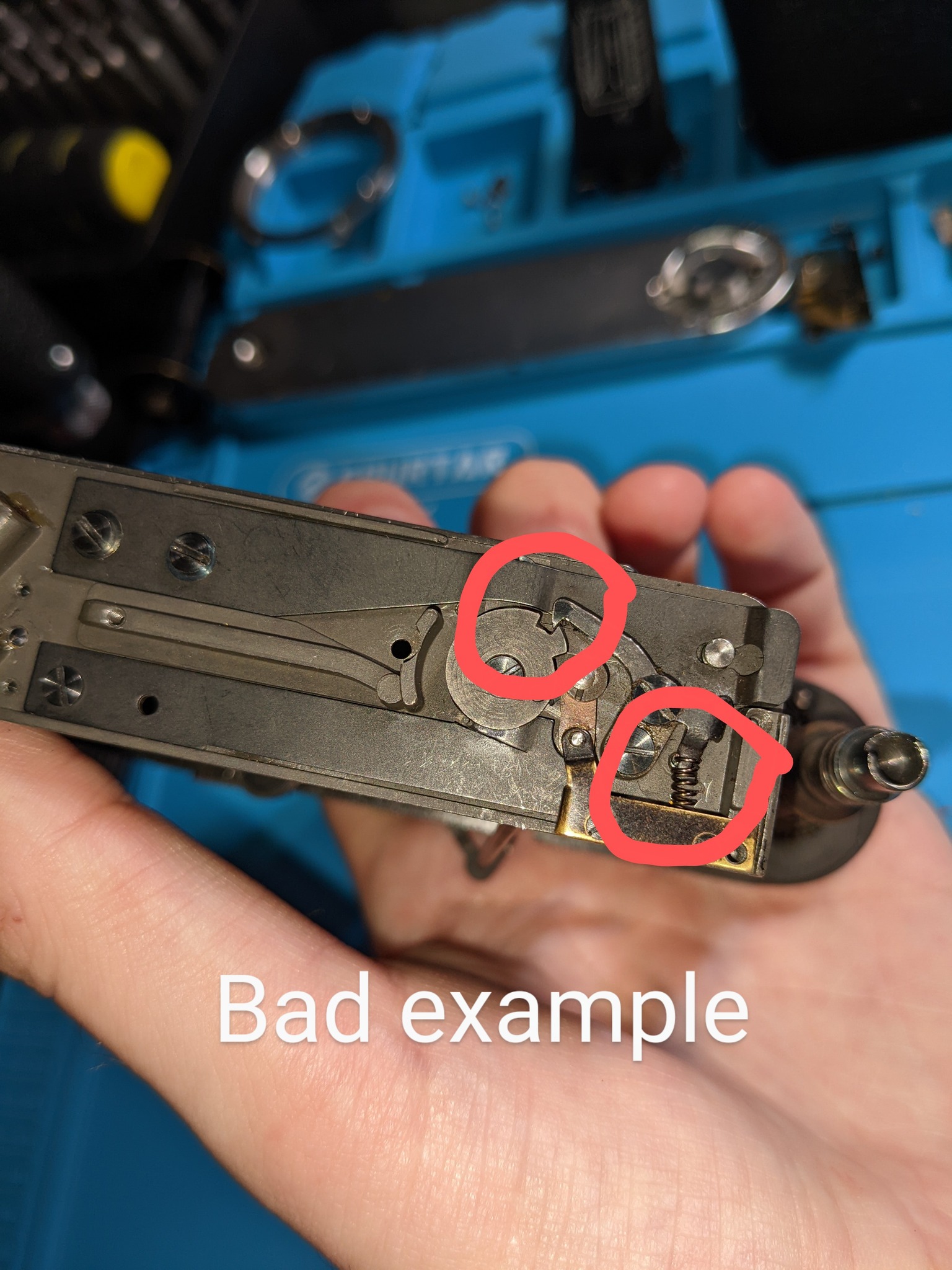

I have included 2 pictures, one of the 'bad' example which is the black dial with this issue, and then a reference photo of the 'good' example which is the nice IIIF red dial I have.
The 1st Curtain cam and latch (pawl) aren't fully engaged with each other - they engage just enough but it's not right and I'm not happy with it.
At first, I thought the spring (circled in the attached image of the 'bad' example) was the cause, and whilst it is a bit beat up, I verified it was not the cause by swapping the spring out temporarily from the 'good' body. I then proceeded to also swap over the cam and pawl from the good body, however none of that has cured the issue. If you push the pawl into the cam notch it will go in but it won't repeat the same amount of engagement without physically pushing it in. I have also verified it presents the same (not engaging enough) with the flat release spring removed.

Hi Nicholas,
The pawl will push into the notch, but requires a reasonable effort push. I've tried playing with the locking pawl profile slightly too to rule that out but that made no difference.
The spring is a slightly different angle due to the pawl engagement as you correctly pointed out.
The pawl itself moves freely, I've verified there shouldn't be a washer underneath (checked the technical drawings and compared the other IIIF I have) and also confirmed the screw is not overtightened. If anything I suspect it to be something gunked up as you say - on further inspection I think there is a very slight difference between the point the cam finishes rotating on this one vs the 'good' IIIF I have, so if that's the case I need to figure out why (or perhaps it'll be something that will end up resolving itself when I replace the curtains etc.
