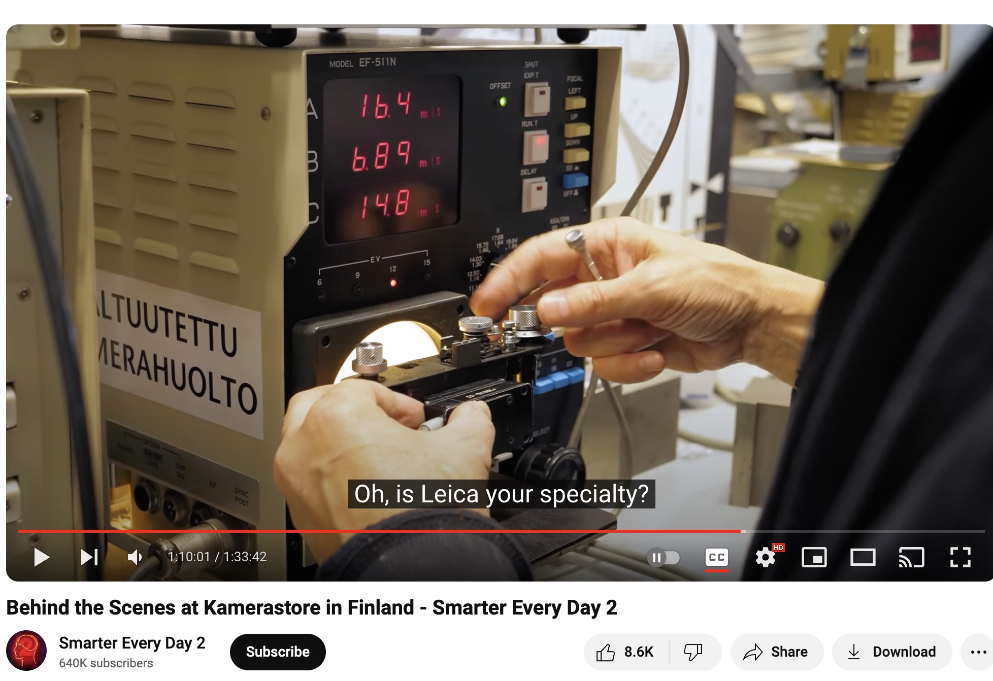

If you check out the "Smarter Every Day" segment where they visit "Kamerastore" in Finland, you can see some transit time numbers from a Leica they are repairing. Though, it is unclear how far along they are with the repair. In this case curtain 1 is 16.4 msec and curtain 2 is 14.8 msec. The middle number is the shutter speed, 6.89 is near the lower limit for 1/125 per ISO.

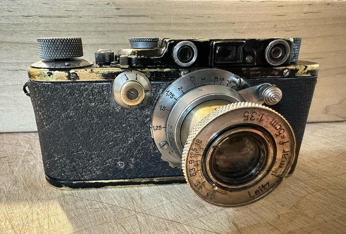

The camera, by the way:
The skin (which had been painted glossy black at some point) was broken and broke off more when I removed the chewed-up screws, so I replaced it with leather. I made a paper template and cut the leather from a piece that used to be part of a sofa. I bought actually really good very thin double sided tape at a hardware store (who knew?). The Elmar is from who-knows-when -- it has no serial number. It looks like it was chewed up by something or other. It suits the camera.

Don, check the black ring at the edge of the front glass: there's often a serial number there, very small and hard to make out.
I have checked there. I own other ones with the serial number there. This one has no serial number anywhere.
Sorry for teaching you to suck eggs. Maybe the original aperture setting knob is away and the ring with it? Or maybe it's an extremely early version with a different setting arrangement.
It's a normal f3.5-f18 Elmar 50. There are plenty of them with no serial numbers.

Perhaps the serial numbers have been worn out ? I have seen an elmar happened the same.

Uh, no. There were Elmars with no serial numbers. Some at least seem to be from converting the non-removable lenses from early Leicas when the cameras were converted to the O mounting flange.
