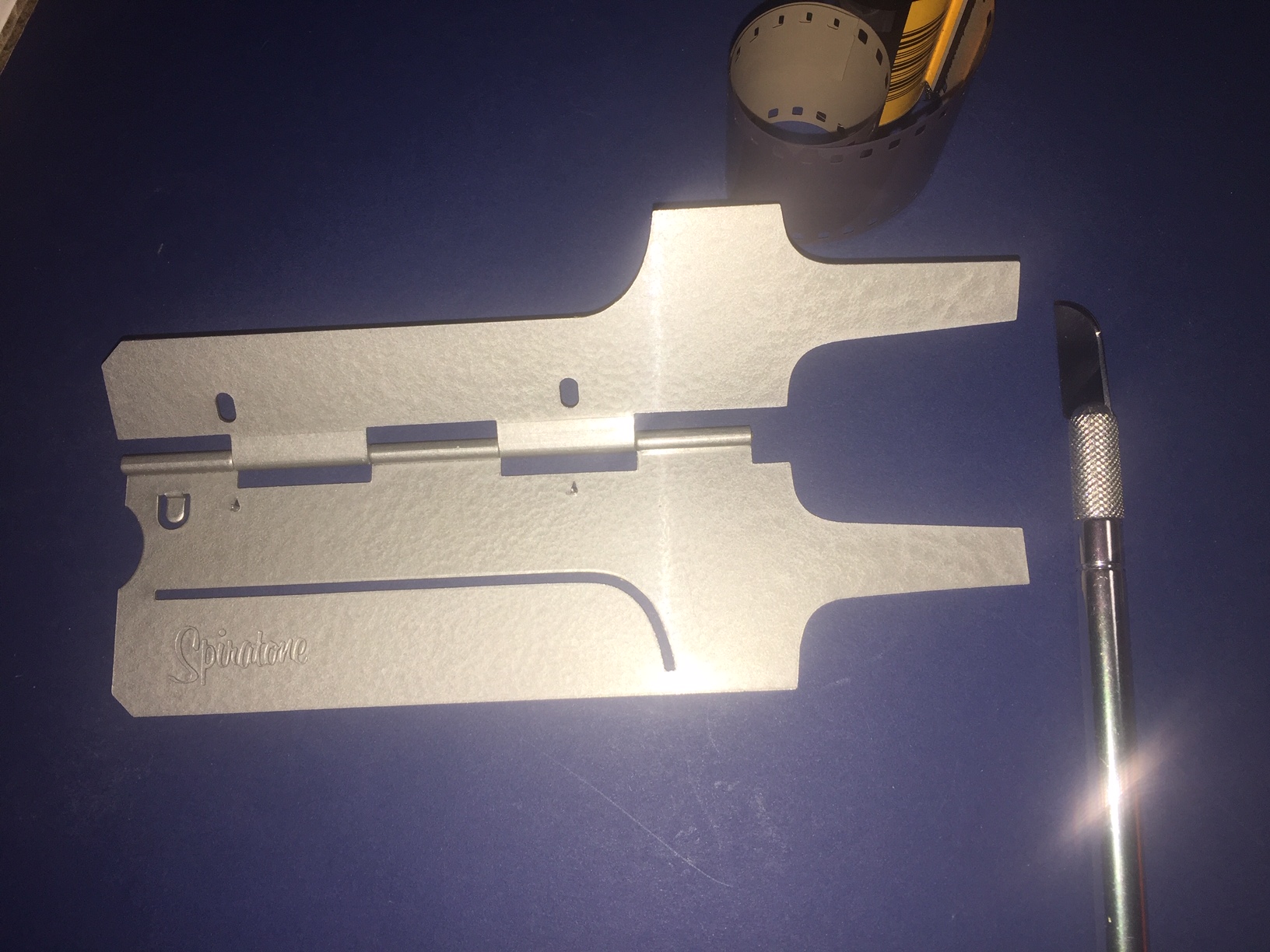

Had my leica IIIg shutter repaired recently(film peices stuck in curtain). I bought a Spiratone brand film trimmer for Leica. Not sure how to use it. see photo. Anyone have instructions? Thank you in advance.

Put the film strip on the template with emulsion down with the two teeth engaging rebate holes, and the end of strip behind the start of the straight part of the slit.
Then close the template and cut along the slit.
I never came across such template, but assume I got it right...

Thank you, I played around with it multiple times and all I end up with is a 3-3 1/2” leader? I believe 4” is the recommended length.

At one end you see that stamped-out latch. I consider it the end-position mark, as at that position the film-strip would just uncover the slit a tiny bit, enough to dive-in with the knife.

Measure the template itself: that will tell you whether you need to let the leader protrude and, if so, by how much. As you say, 4" is the recommended length to trim; but my old Kleines Leica-Buch (1952, by Theo Kisselbach) recommends 12cm or 4.75". I usually allow 23 sprocket holes when trimming my leaders.

There is no need for a template anyway. Just give the leader a shallow, smooth curve to full width and without cutting open a hole and cut the leader long enough (try it out).

There's a fella sells a plastic template on eBay, made by himself and costing $25 - see http://www.photonbox.com/filmtrimmer.html
I'd rather have one the shape of the Spiratone, as it is also a template to trim the spool end: very handy.
Like AgX, I find the leader simple enough to do by hand and eye, as long as I use small scissors.
