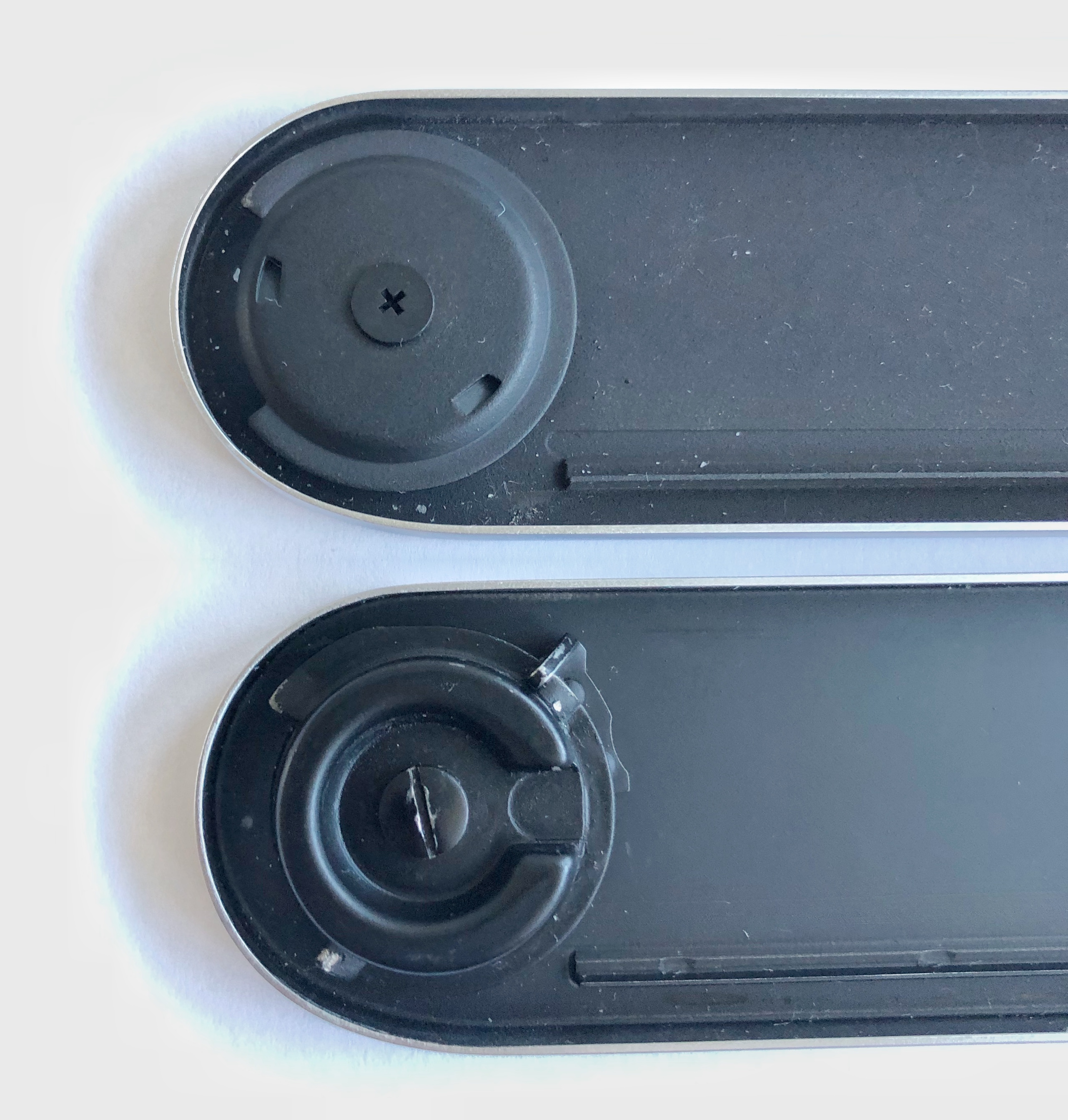

This is not a discussion thread as such, but rather a thread to record relevant information to identify the Leica FILCA and IXMOO reloadable cassettes from each other.
The enclosed images shows how to easily identify the two types from each other:
The FILCA is a little taller than the IXMOO (picture 1) - which shows that the body of the FILCA is 2 millimetres taller than the IXMOO (46mm vs 44mm). The last two on the right hand side are IXMOO:
IXMOO and FILCA are most easily identified from each other when looking at the bottom, where the FILCA will say "Ernst Leitz Wetzlar", the IXMOO will say "Ernst Leitz GmbH Wetzlar" (picture 2 below):
FILCAs will only fit into a Barnack Leica and is the older system of the two. IXMOO will fit into both Barnack Leicas as well as Leica M's up to the early Leica M6 models.
Later Leica M6's and newer M's will not have the indent in the bottom plate lock that is required to open/close a IXMOO as seen in picture 3 below:
Bottom plate that will not open a IXMOO from later Leica M6 is shown on top, bottom plate from an M2 with the required opening indent is shown below.
Newer M6's can be made to accommodate the IXMOO cassettes if you replace the bottom plate with one from an earlier M with the same film-loading system as the M6 - for example from an MDa, M4, M4-2, M4P.
I don't know if newer M's (M6 TTL, M7, MP) can be made to uses IXMOO's the same way.
