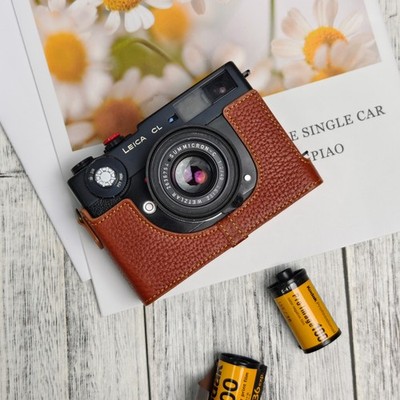

The most valuable accessory that I found for mine was a beautifully made half case that allowed the camera to hang on a strap like a regular camera. Having only that one strap lug made the camera slow to get up to my eye. But what the heck, it's a Leica, so I guess that's a feature :>}

I'll add kudos to the Mr Zhou case. It aids greatly in grip and handling. BTW - I bought this CL with a non-working meter many years back (I was using incident metering anyway). After hearing that DAG had parts for these, I sent it off to him and found the good news being there was a simple wiring disconnect issue. It was returned promptly with a CLA, battery conversion and working like new (and active meter). He has been an excellent resource over time. https://www.dagcamera.com/contact.html
The rf on the little CL is easily disrupted by over-sized hoods and the simple tube style can work quite well. The original V'lander hoods on the 40 ƒ1.4 and ƒ1.2 both interfere.

There's also this T case from the East
very nicely made.... $38 USD. pretty much 1/2 the cost of the Mr Zhou
.....or buy mine for $20. (selling my CL)

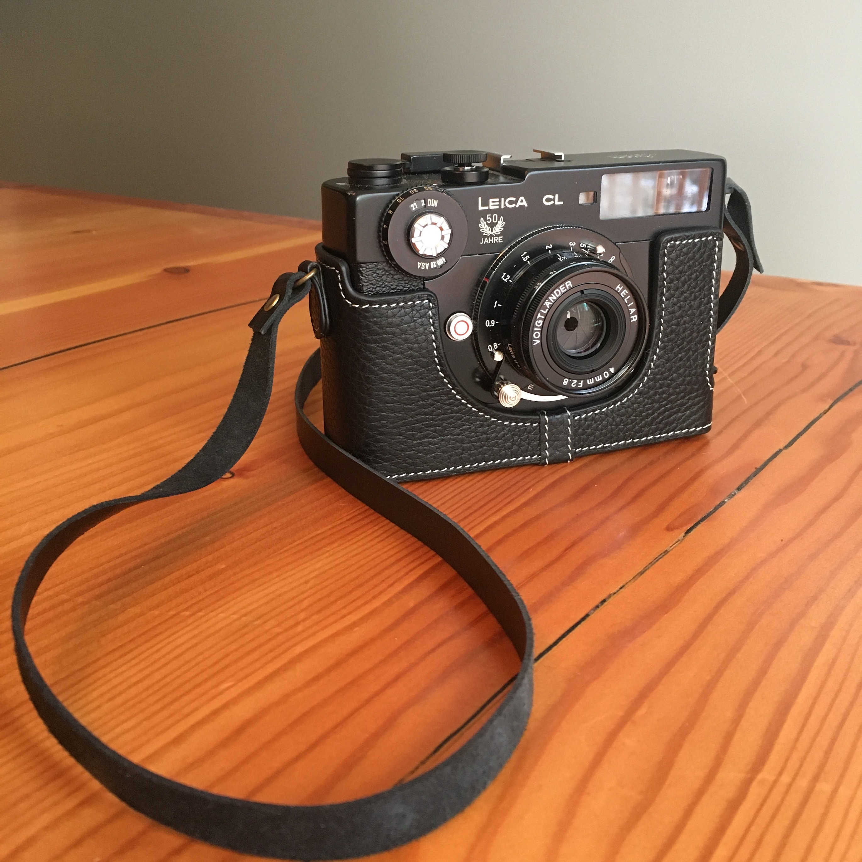

carries much nicer horzontally than vertically w the 2 lugs

Pieter, if you're walking around town, the vertical carry around your neck or off the shoulder is convenient but if your skiing or climbing and want it across your shoulder, then it's awkward since the 2 attachments are so close together ....you need to make the strap longer than normal....now the camera hangs lower and gets in the way.

i have one of those half cases and found it kind of unreliable -- maybe mine wasn't made properly, but the velcro strap around the back that allegedly holds the camera in the case didn't do a good job and the camera, once, fell out (GAH!!!!) hitting the ground (GAHHH!!!!!) but fortunately was not damaged.
I glued velcro to the bottom of the camera and the bottom inside of the case and put better grade velcro on the strap holding it in.
Mostly i use the existing lugs on the end of the camera, as god intended. It hangs off my shoulder nicely or even around my neck if need be. Usually I wrap the strap around my left hand and hold the camera with the same hand so it is VERY secure.

Summicron1, the case i have is attached to the camera by the tripod screw. I carried it around Europe for a month this summer....never a problem. But i suppose the different makers attach them by various means

I use those same cases. The camera is NOT coming out of the thing, with the tripod screw attachment. The screw is hollow, too, so you can still use the camera on a tripod with the case on.
I use one each for my m3, FM3A and F3. Mostly because I often used to do location photography with a timer or steadying the camera on a wall, and the case keeps me from scratching the bottoms up.
You never want to scratch your bottom in public.
The TP original ones are the best cheap half case for that job.
