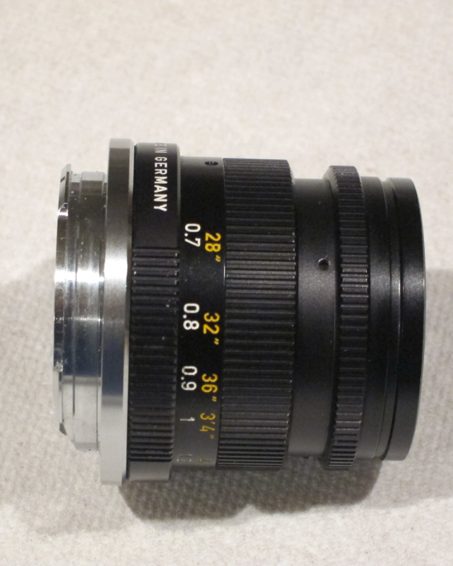

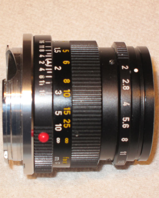

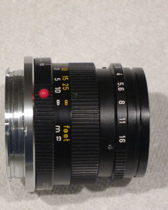

50mm Leica Summicron - AGAIN! resurrected thread
I let this thread expire before bcs I was too lazy to post photos and tightening a screw got me by. I just kept using the lens . . . until a knew problem.
Now 1 screw on the ring behind the aperture ring is gone and one on the same ring is loose and I have snugged it in but not tightened it hard. The ring on which the loose screw and missing screw are located was turning freely so that aperture did not stay steady against the white marker dot. When I tightened the loose screw I was able to set the ring at the right spot for the actual aperture and tighten down the screw so the ring did not swing freely.
Pic 1 is the missing screw. Pic 2 is the gummed up loose screw I tigtened and Pic 3 shows the one good screw at the bottom and a silhouette of the loose screw AFTER tightening. Meanin it is NOT set right.
Any help for me? How much is a good CLA of this lens?
Thanks

If you have half an idea of what you're doing, you could probably just replace the missing screws and run a test roll to see if focusing & aperture are still accurate.
If you have doubts, a good CLA certainly won't harm your lens.
The *BIG* question is, why are you losing screws like that?
It certainly isn't normal. Either someone took the lens apart and didn't put it together well, or it's been subjected to vibration: unpadded contact with an airplane carry on bin is especially bad, but vibrations from other vehicles can also loosen up screws. In that case I'd recommend a CLA as other internal screws and retaining rings could also be loose.
