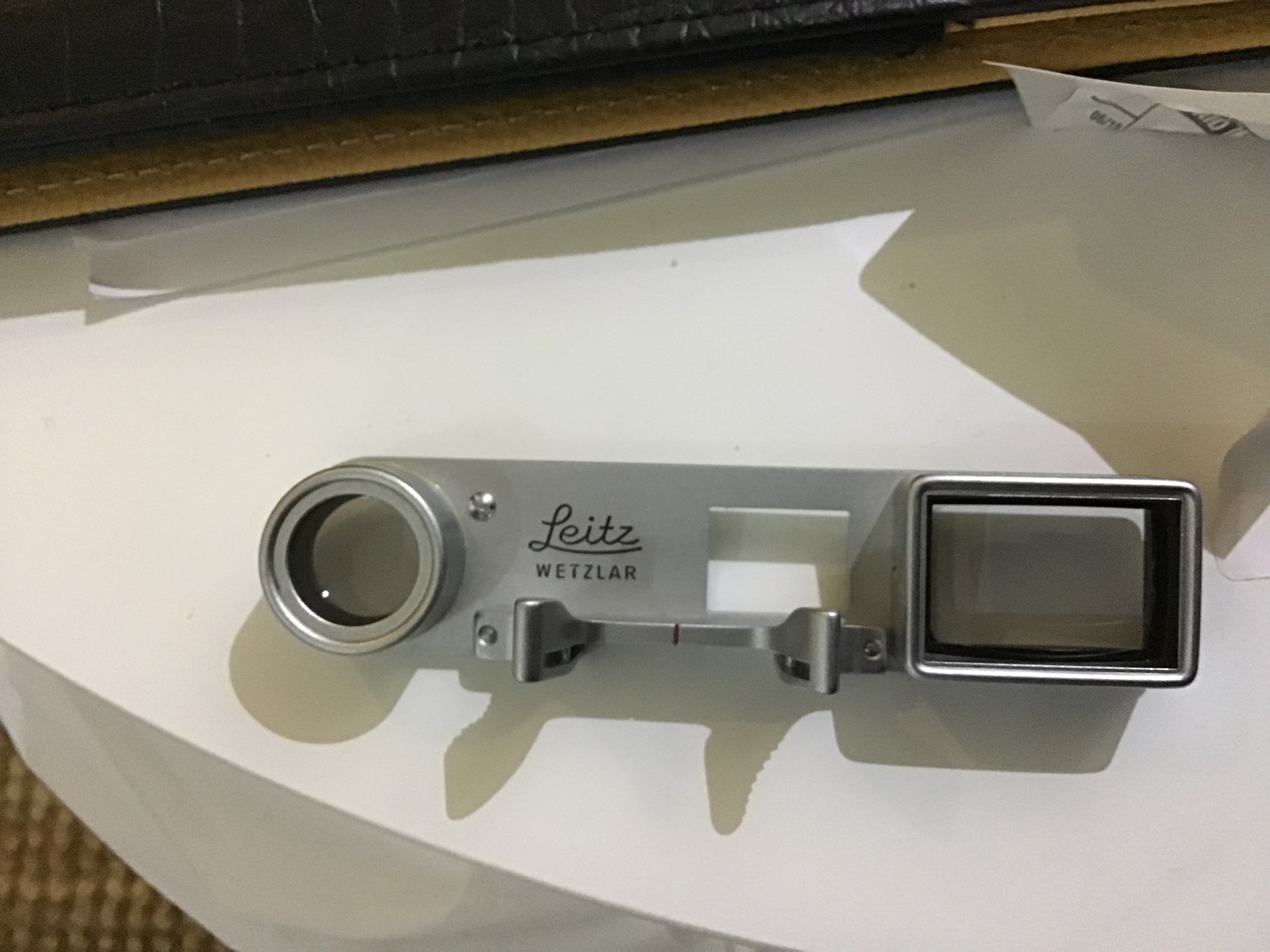

You may have the wrong goggles! mine does that too because someone switched the goggles from one series of the DR to the other.
Which ones do you have? attach a pic. Perhaps we have each others and can swap!

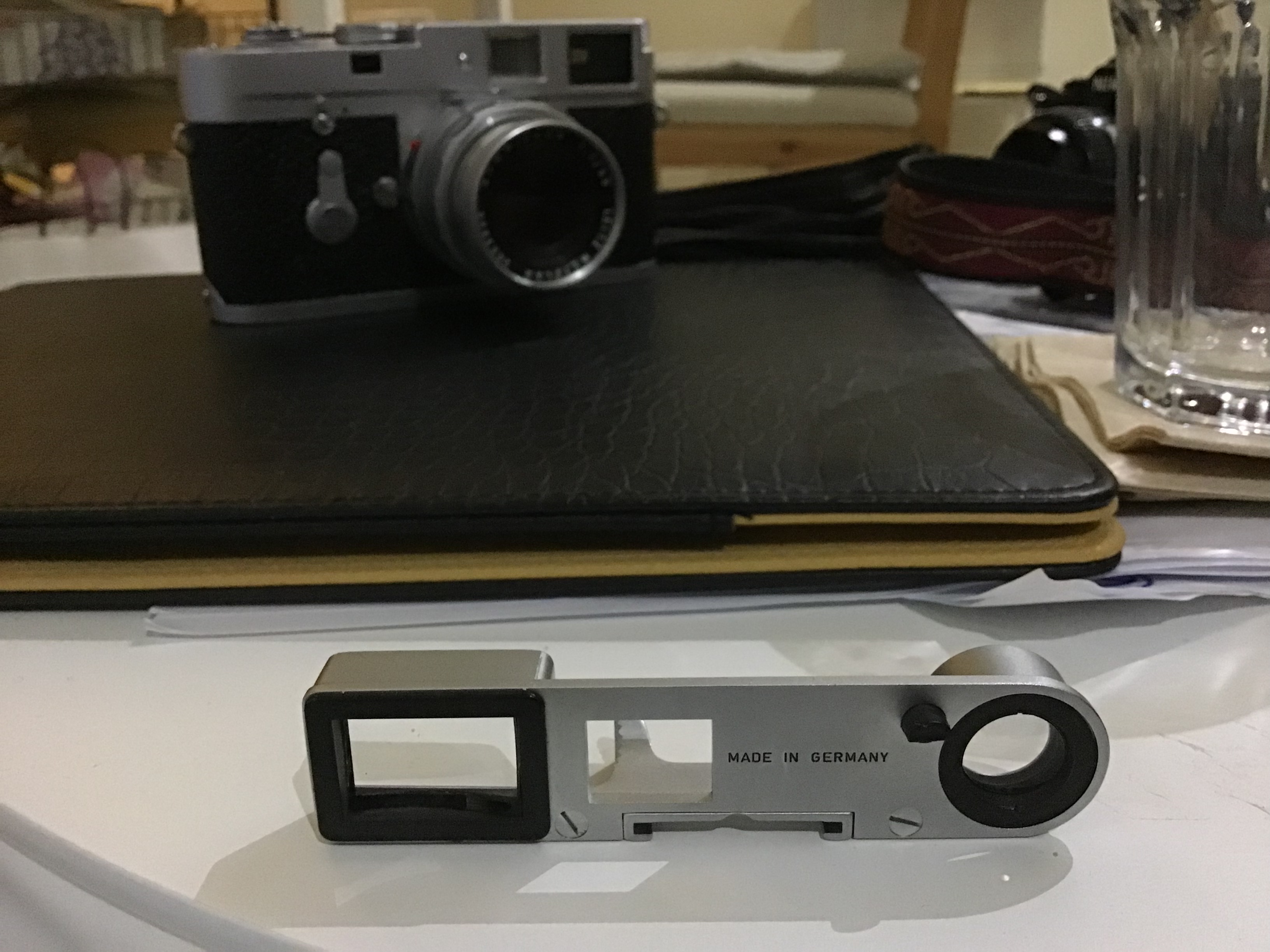

That’s a great suggestion! It would be just my luck, though, if you had the exact same goggles!
Dood, this is our lucky day! This is mine - the way to tell the difference in the two versions is the Leica script. Mine says E. Leica Wetzlar in a 'frame'
Yours just says Leitz.
Where are you located?
What a stroke of luck! I’ll send you a message with my whereabouts.
