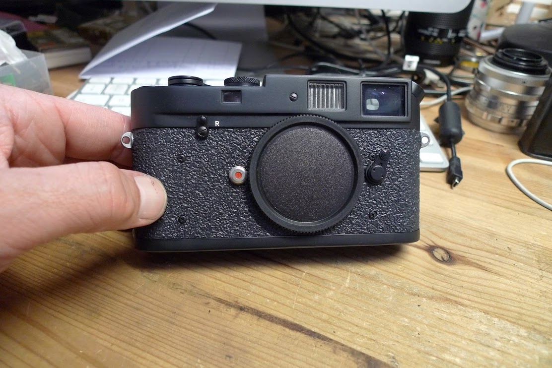

If you are comfortable with a hand held meter or if you share with me a preference for one over an in-camera meter, then I would recommend the Leica M4-P. Get one with the older, more pronounced 50mm lines and brass top (SN 159.... or less) and you will be satisfied. As long as you don't wear glasses, the M4-P 28mm lines work well -- here's a snap of mine:>
