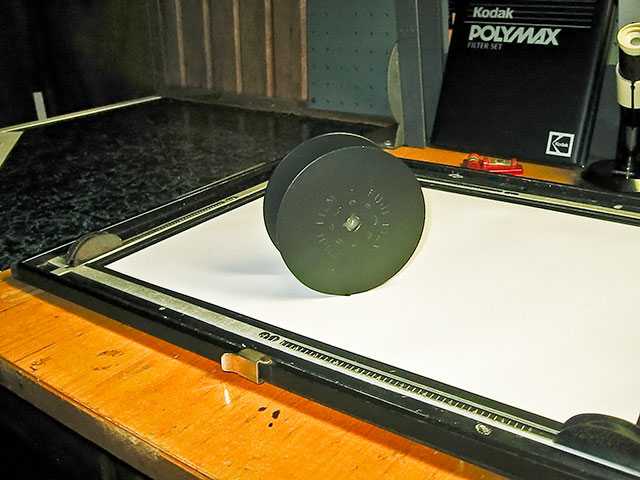

Yup... It's just a little ole' film spool.
93mm (3.6") outer diameter. 29mm (1.125") inner diameter. 36mm (1.4") wide.
They fit in my Watson just fine. No modifications necessary.
