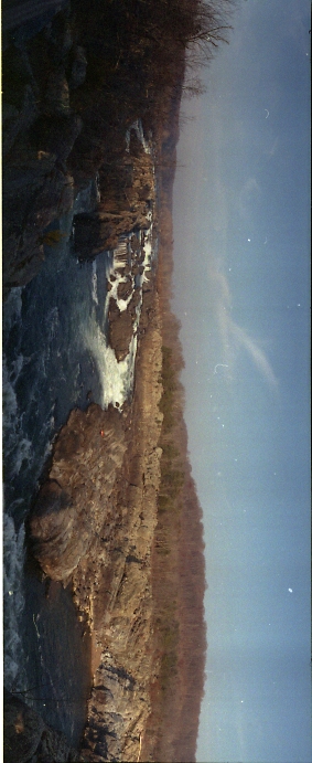

The left side of negative is out of focus on my Widelux F7. Any suggestions? I am sending it of to KEH to CLA and release the foam seals because the seals feel sticky. With KEH's new repair pricing I might as will get the CLA and ask them to address the focusing problem.
The fingers holding the camera do show up well considering, I think.

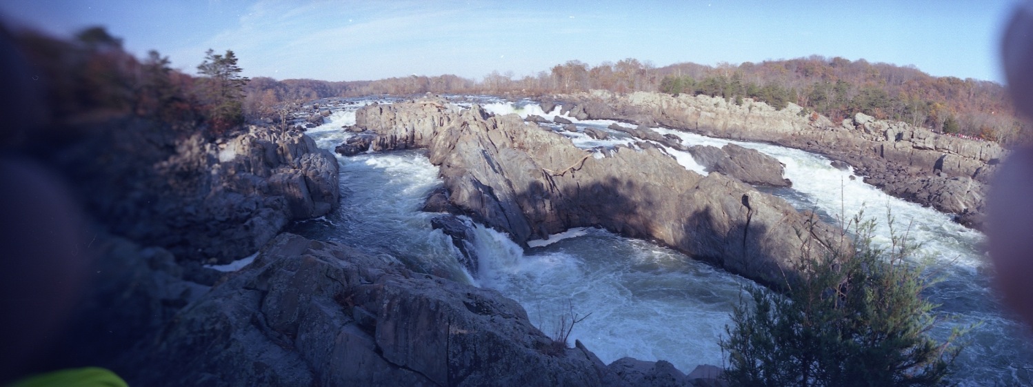

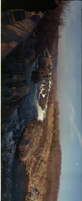

Could the foam block on the right side of the lens [looking at the back of the camera with the back off] allow the film to move away from the proper position? The image does spread there; look at the top edge, it does it on the bottom too.

The film is obviously slightly out of position at the ends (not in register with the film rails). Lack of normal tension in the film strip might explain this. That would allow the film to belly out from convex surface of film positioning rails near the retaining rollers just outside of the ends of the frame. This makes sense because that is where the film makes a sudden transition from the large concave radius (of the emulsion side) to the much smaller convex radius as it is forced under the rollers.
I think that the film rewind knob likely needs more resistance to ensure that the film has normal tension.
A technician might be able to adjust the camera to restore normal resistance to the movement of the film so that the film strip has the proper tension to keep it in register with the convex guide rails. I base my comments on the open-back illustration here.

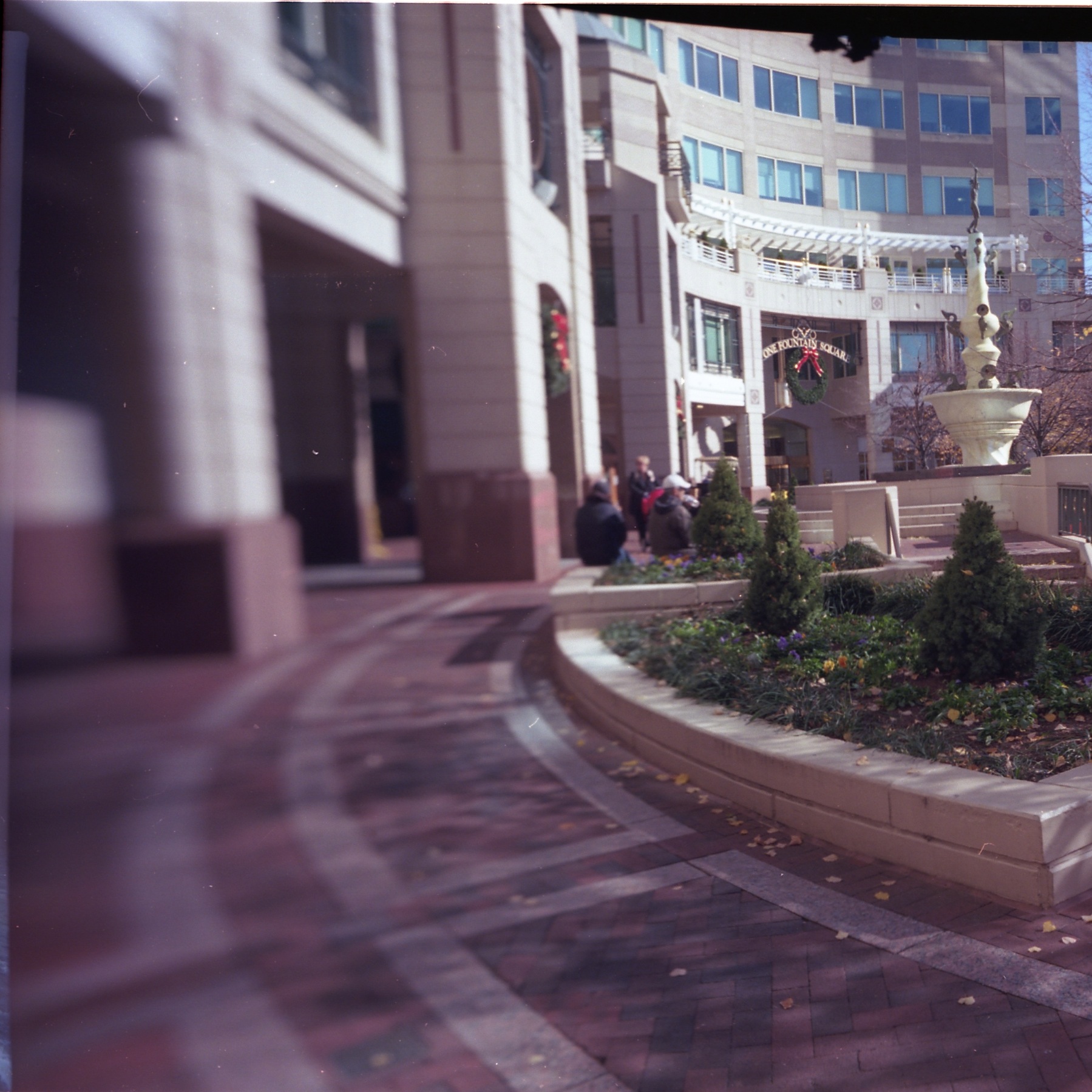

Ah ha! Loading the second roll I see that I may have put the film between the foam gate and the second roller rather than under the second roller. The thicken plots!!

If you fail to thread the film under the second roller, then there’s nothing to keep the film against the film rails at the right end of the frame. That would leave the image badly defocused at the left side of the photo—which is exactly what happened.

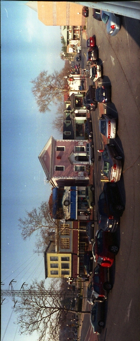

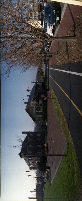

I think that I fixed the problem. Also several years ago, my brother sent several rolls of frozen film to me REI Opticolor 200 135-24 Color Print film, process before 7/94. Do the photos that I took today look ok? I had to rush to get it processed before the film became out of date!
