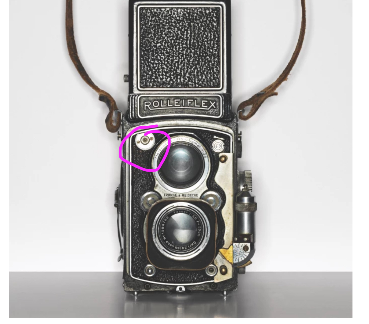

Would anyone happen to know what the connector (or whatever it is) at the top left of Miller's Automat Model 1 is (photo from this Sotheby's Magazine article).
Am I right that in thinking it was not standard on the Model 1, and that also the lugs for the flash solenoid were retrofitted?

You mean the disk, partial cut from the top edge as it intersects the front rim, center dark area, upper left of lens panel?
Looks like an electric flash PC socket but hard to be certain without more detail of center part. If so, this is one of the first Rolleiflex MX models! :smile: You have a simple electronic connection, and a solenoid delayed flashbulb connection.

I would go further and say definitely the flash socket, the Sotheby's link also shows the flash bulb holder. I have seen similar fla sh bulb delays on Press cameras, in photographs.

Thank you for your replies. I'm sorry I described it poorly, I should have marked up the image. Yes I mean this thing:

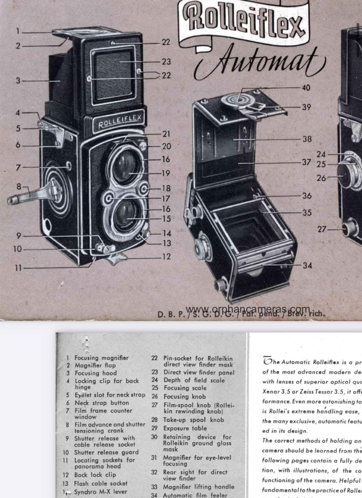

The Automat Model 2 that I have lacks this connector and I don't believe it came standard with the Model 1. However both Model 1 and Model 2 have a flash cable socket, which is at the bottom right. It's no. 13 in this page from the manual:
I'm guessing it was retrofitted for some purpose, possibly use with more modern flashes.

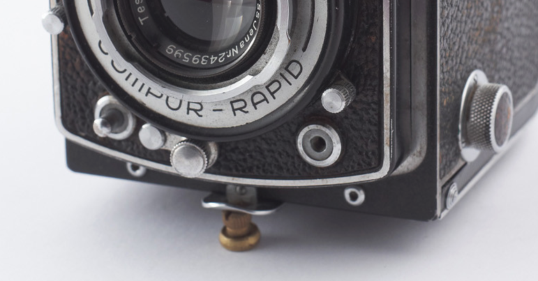

#13, labeled Flash Cable Socket, was not always a flash cable socket. On many Rolleiflexes of this type, it was a cable release socket. I can't say with any certainty why the difference. If it was changed at a certain date, or if it varied from camera to camera, or such.
Looking at the photo of the actual camera, it looks like a cable release socket, not PC flash connection. This camera was a pre-WWII or so model, based on the gray paint circles on the shutter and aperture dials. Maybe this was the dividing line between cable release and flash socket.
There was a decent amount of empty room inside these cameras. Allowing for attachments like the flash bulb solenoid. And for adding a PC flash socket and running wires, etc.
Actually you described it well, I fully understood. It is the 1937 to 39 Automat, with no shutter lock, and no flash connector, until modified.
As Dan says where the Flash sync is shown #13 on the later versions it is the cable release socket on Lee Miller's Rolleiflex Automat.

the camera is the very first Automat from 1937, even the Tessar is from 1937 by it's serial. In 1938 the Automat was fitted by a shutter release protection, Miller's camera doesn't have it here.
The contact marked in magenta is indeed a pc flash sync, a modification not made by Rollei.
Indeed the cable release socket is here where the flash socket was in later Automat's. #13
Thank you everyone for your continued help. So Miller's had a PC sync fitted later by a third party, it seems.
Is it possible to say if it was done during WW2 or later? I searched for info and according to Wikipedia the PC connector first appeared in the early 1950s. But looking closely at the image above, it seems the connector on Miller's camera is slightly different from "normal" PC connectors, or? It looks like the centre part is wider, though granted it is difficult to tell from a photo.
I also need to correct what I wrote above about my Model 2. It does indeed only have the cable release socket in the lower-right corner, not a flash connector.

It's very easy to add X flash sync to an old leaf shutter (for Electronic flash). The Rolleiflex Automat X (K4) has X sync in 1949, However you need a mechanical delay between a flash bulb being triggered and the shutter opening, for M flash sync.
The 1951 Rolleiflex Automat MX (K4A) had a Compur Syncro shutter so could be used with Electronic Flash & Bulbs.
