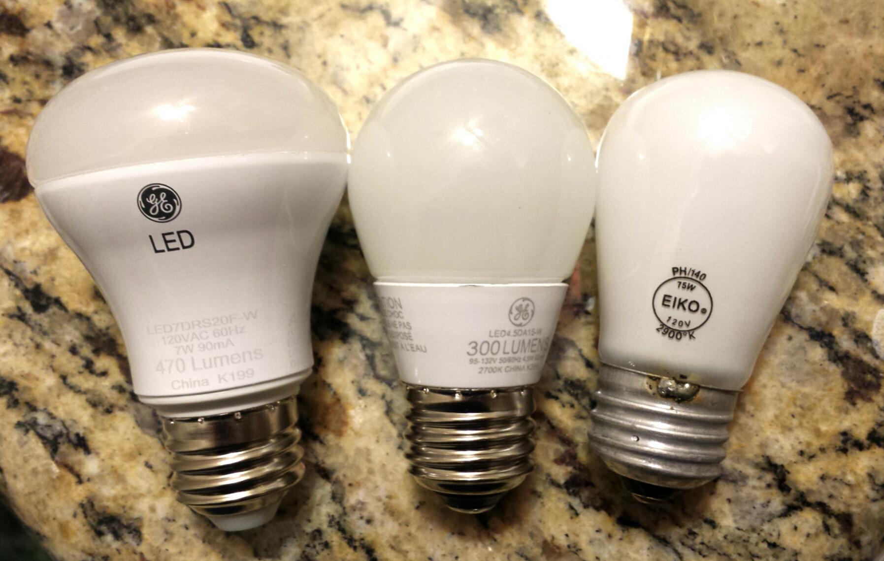

I found these bulbs at Target that are a dead ringer for a PH140. So I bought one and tested it.

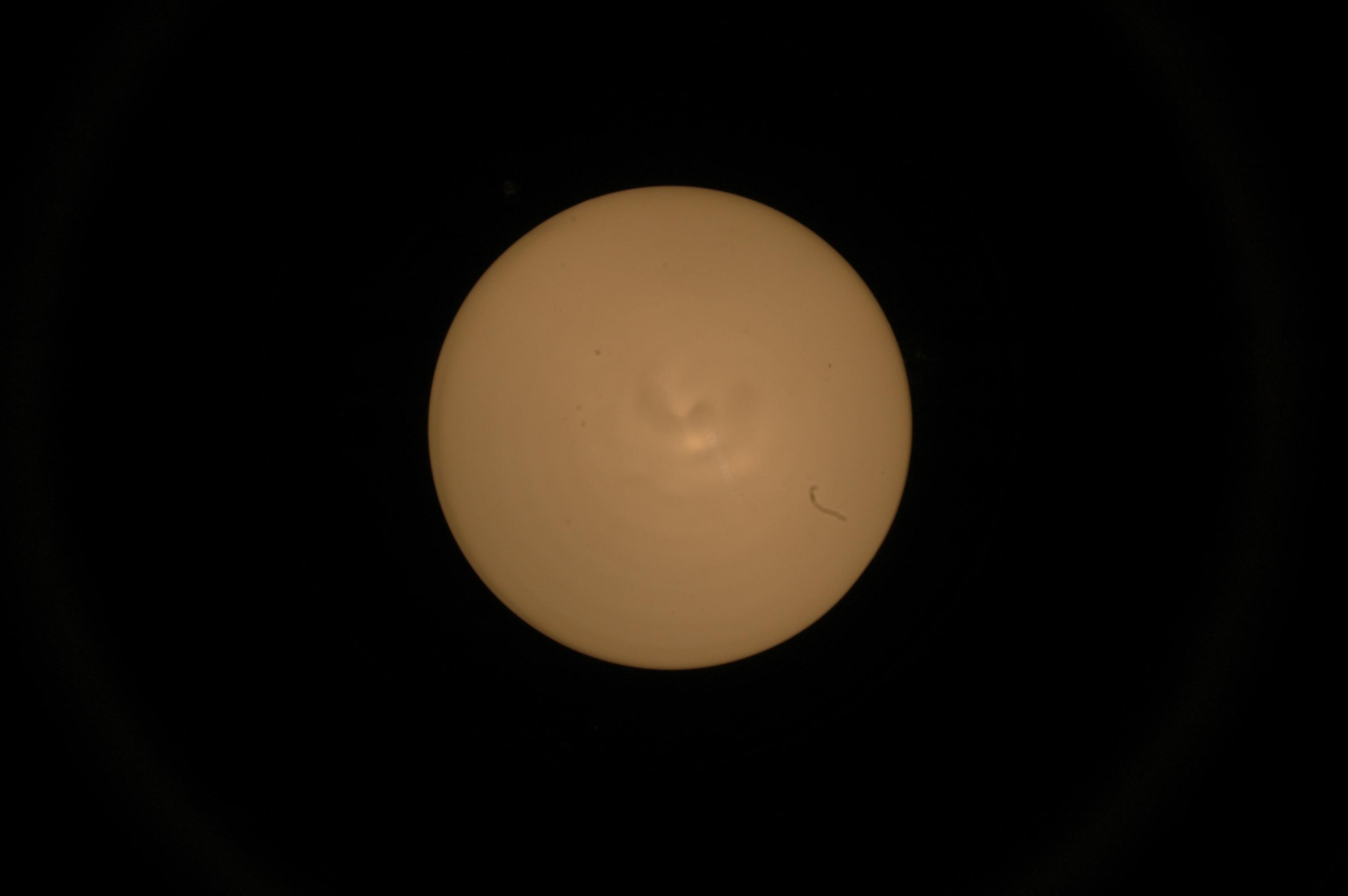

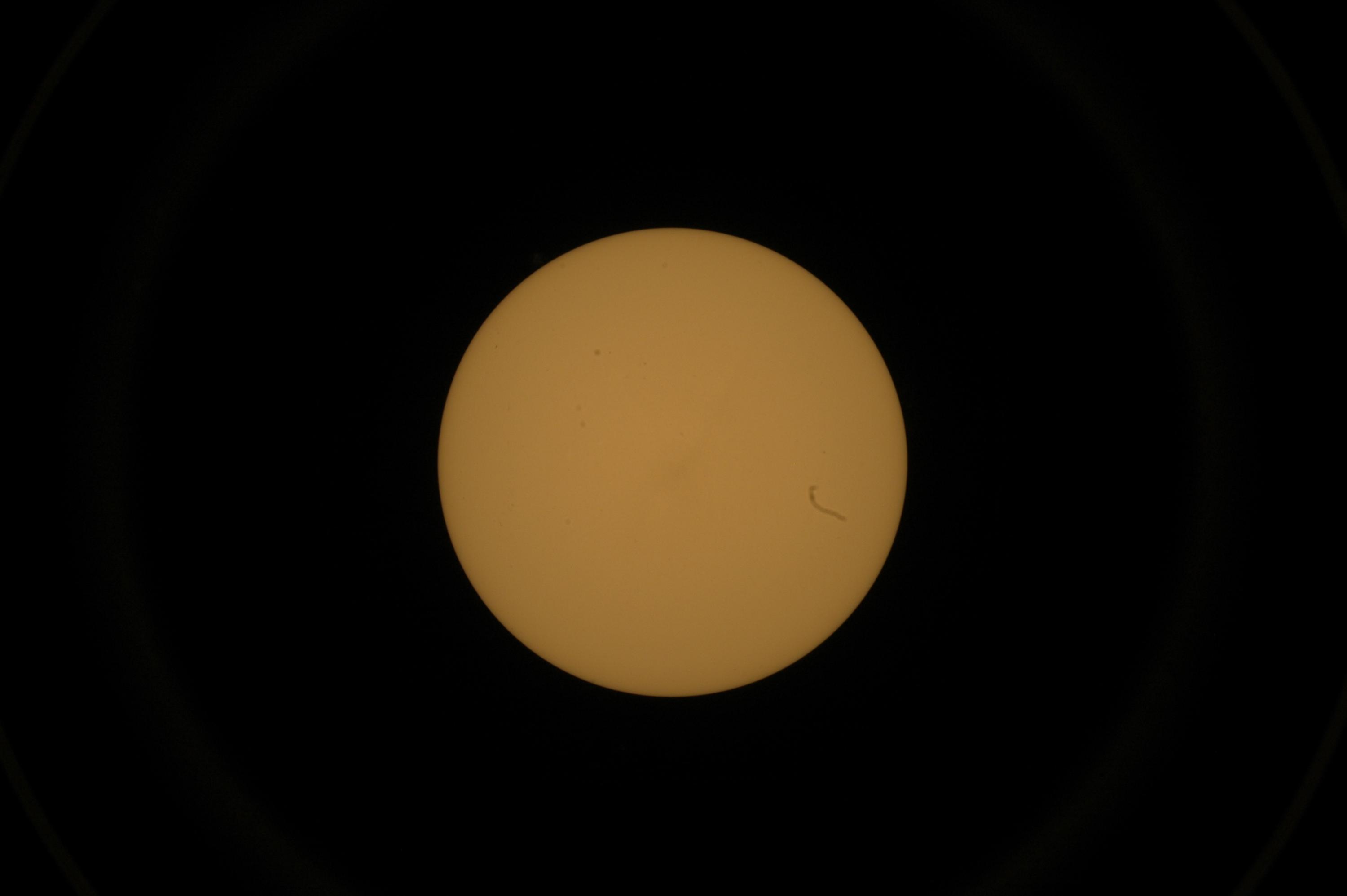

In manual mode with my D70, I can center the histogram with 2000s at F22 for the incandescent, and 640 seconds with the LED. So that is about 2 stops slower, which is fine with me since I typically use a 3stop ND film in my filter drawer anyway.
The images show that the LED appears to have more even illumination than the incandescent. And it appears to turn on and off instantly. How will it fare with the VC RC paper I use? Find out in the sequel coming soon!

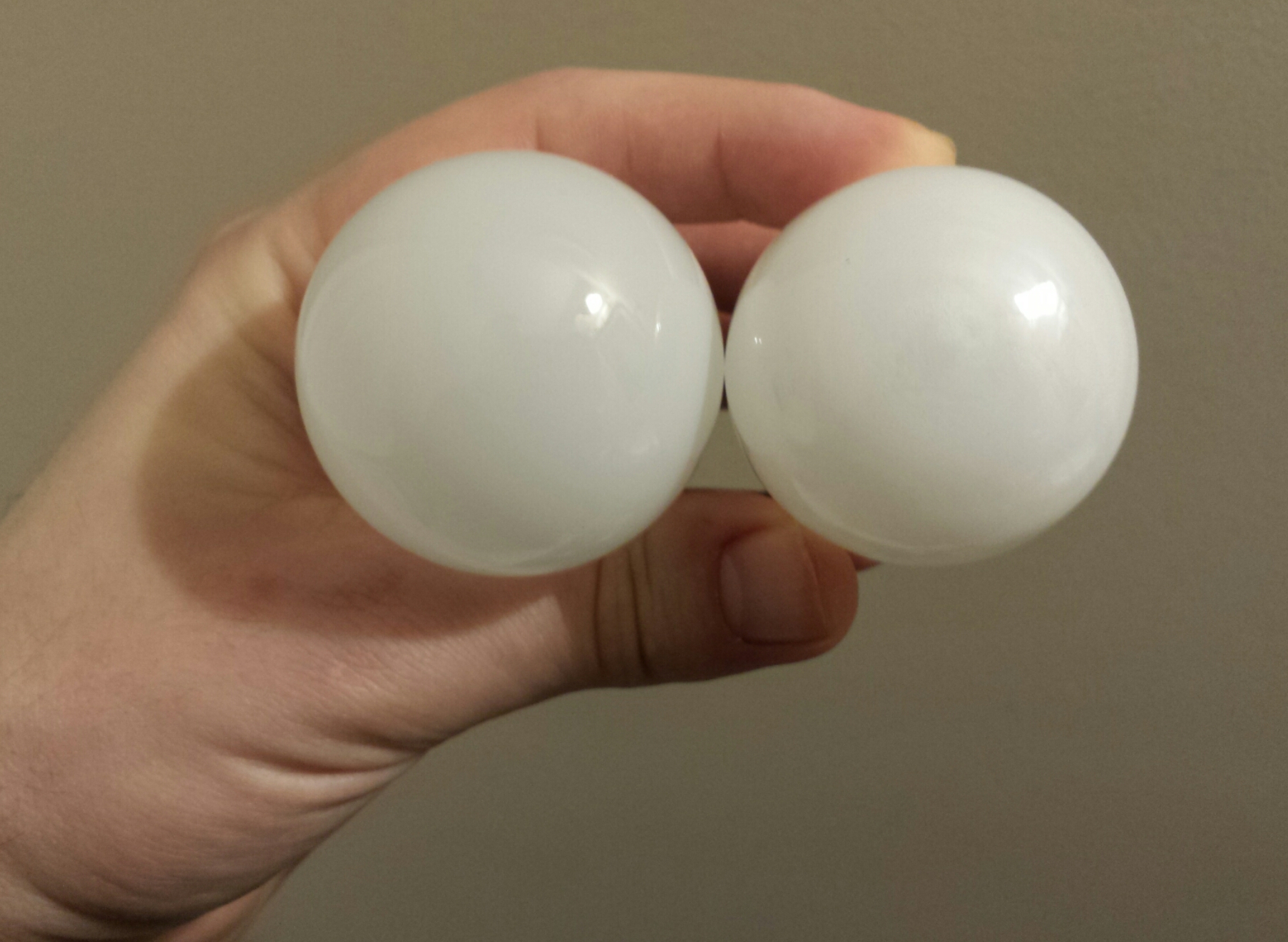

Additional pictures of the LED bulb next to the 60 W PH140 bulb and another LED bulb from my fan that I am also testing.

Well, I'm having problems with heat affecting my negatives in my cheap enlarger, and I can't get spare PH140 locally, and cutting 60W of heat from my small darkroom will be a side binus.
This is marketed as a ”40W equivalent " at 300 lumens. But the fan light is marketed as a 60W equivalent but has like 20% lower lumens than a real 60W incandescent. So yes, they are stretching it sometimes.

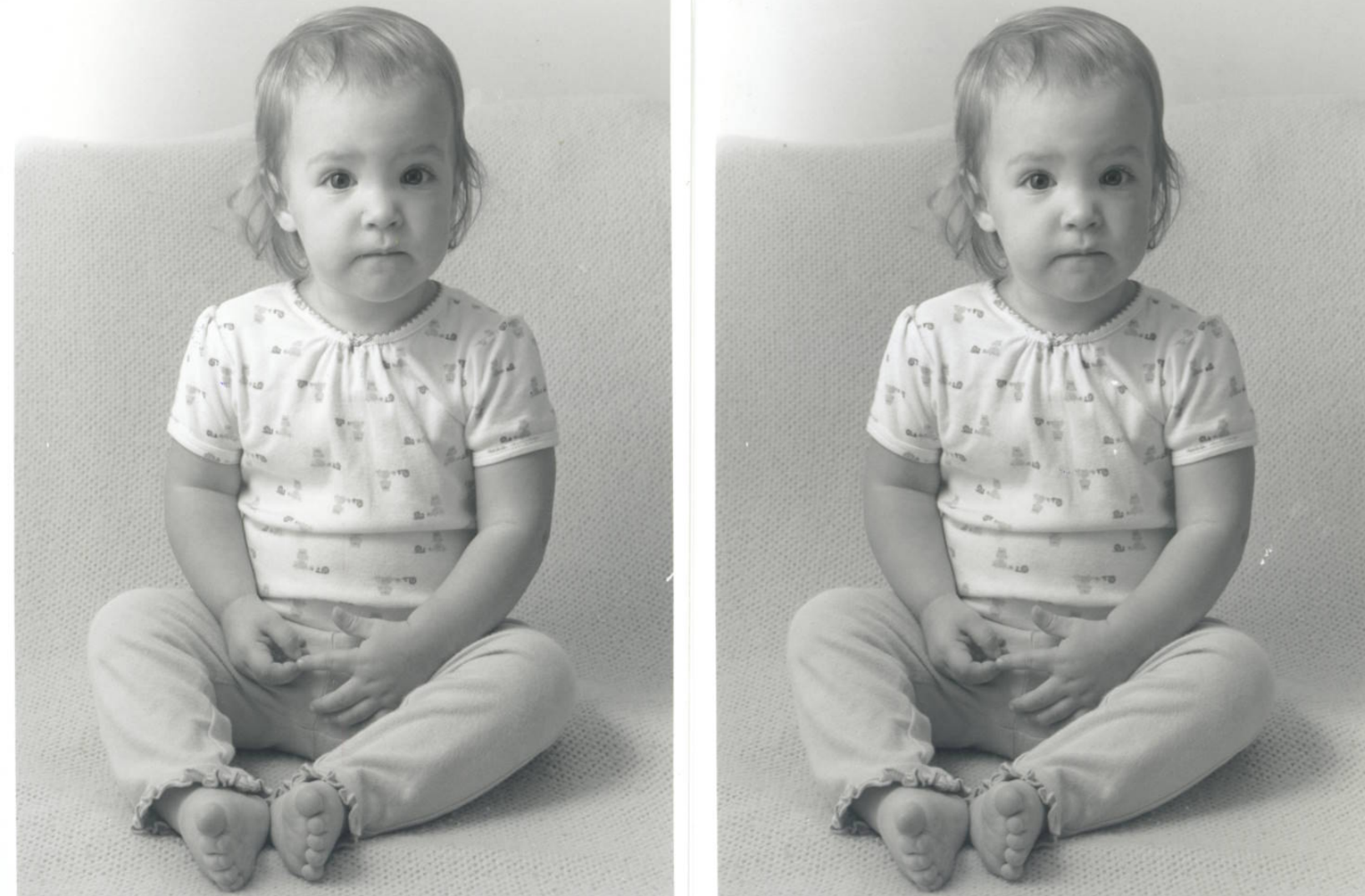

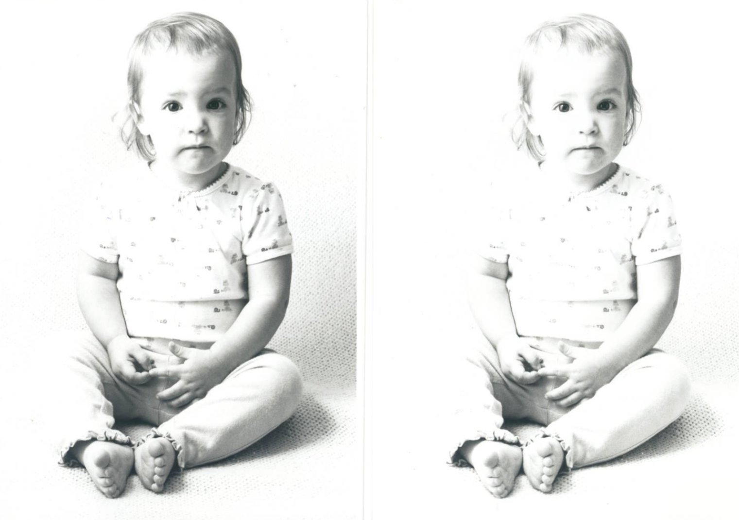

I made 2 prints, one with each bulb, with an Ilford grade 5 filters onto MGIVRC. I didn't match the exposures perfectly but the contrasts appear similar. Then I made two prints trying to get normal contrast with each bulb type. The LED bulb required a grade 3 filter while the incandescent required a grade 2. This seems workable as my main concern was if the bulb would work with multigrade printing.
As expected, LED exposure time was about 4 times as long as the incandescent which I think is a bonus...the exposure time with incandescent was only 2 seconds for this 5x7 print.
