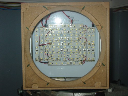

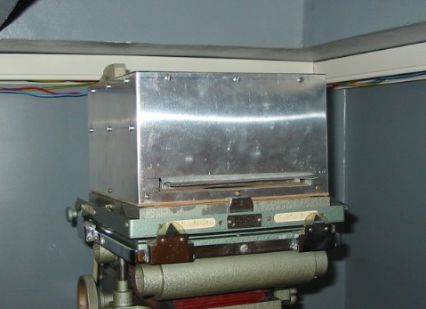

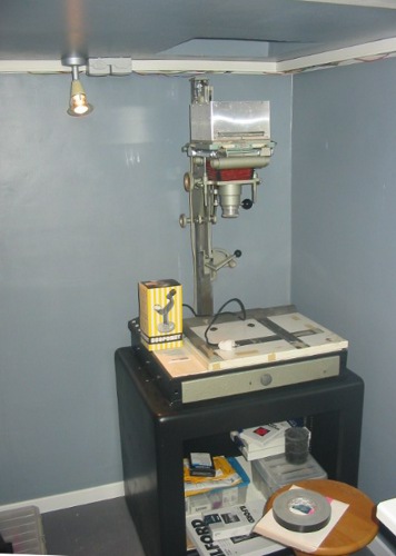

Thanks (millionS of them) for the link. I'm using a similar setup but did not drive so many tests (I'm only using white LEDs).
My enlarger is a Priox, the setup works fine (my difuser is baking paper, I have to test some material they use in theaters. The white plexi cost me too much (3 stops)).
My only issue is converage on the edges for 4x5 but I'm afraid this has to do with my enlarger (it's a 9x12 one)

I'm looking for one of these diffusers (I contacted Kinght Optical, who seem to make what I need http://www.knightoptical.com) but in the meantime I decided to bite the bullet and I doubled the LEDs in my head.
I arranged them in a larger rectangle, with more density on the edges, hoping this will help in illuminating the corners and edges.
