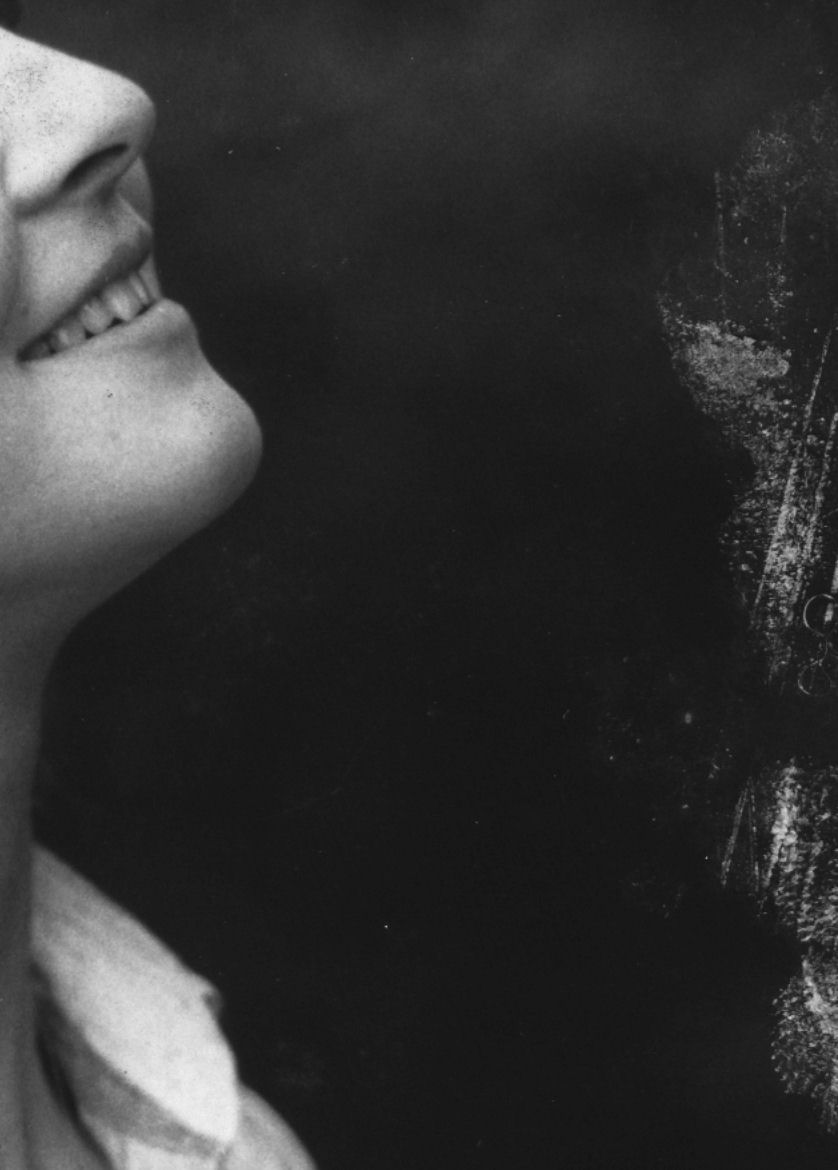

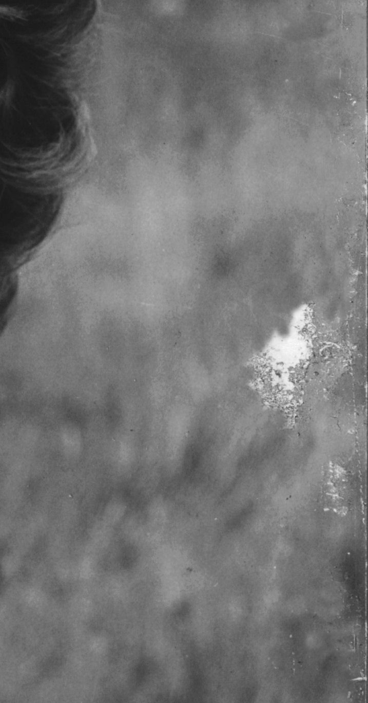

I love the fungal or bacterial attack though !! Next time, can you take a picture of that?
Just for you :D
Here's two images showing the effects of fungal or bacterial attack.
attachment.php
attachment.php
You can see clearly where the gelatin has broken down and washed away.
Gelatin is used in labs to culture micro0rganisms, fungal and bacterial, so a print left too long in water, particularly static water, is at high risk of attack. The same happens if a dry print gets, and remains, damp.
