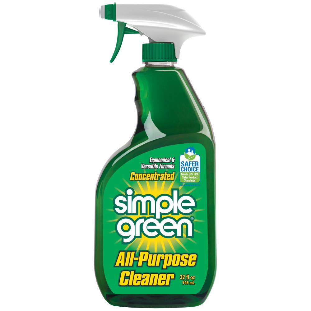

For those of you needing to strip the leather off an old camera (e.g. early 20th century), I almost accidentally found something that works wonders.
I have an Ansco No. 9 model B that I was dreading removing the leather because I thought I would have to sand it all off. What a mess!
Tonight, I figured I would try getting it wet. The closest thing near me was a bottle of Simple Green. I sprayed it on liberally, and let it sit a couple minutes. Lo and behold, the leather (and most of the glue) scraped off in sheets! Sure, it can raise the grain a bit, but nothing a little 320 grit can't take care of in short order.
I never heard of Simple Green. Looking it up yielded several products.
Please look up the ingredients of the product you used and tell us.
The original green Simple Green.

What is the product the OP recommends? Water based?
Yes, it is water based. Maybe it's the alcohols in simple green that are doing most of the work. Of course, the Ansco is a simple roll film camera with all the metal bits removed and the bellows covered with a towel.... simple green isn't great on metals.

I use Simple Green for initial cleaning of leather(ette), but I don't let it sit-- Usually apply it to a cleaning cloth, and use it to remove a few decades of grime.
