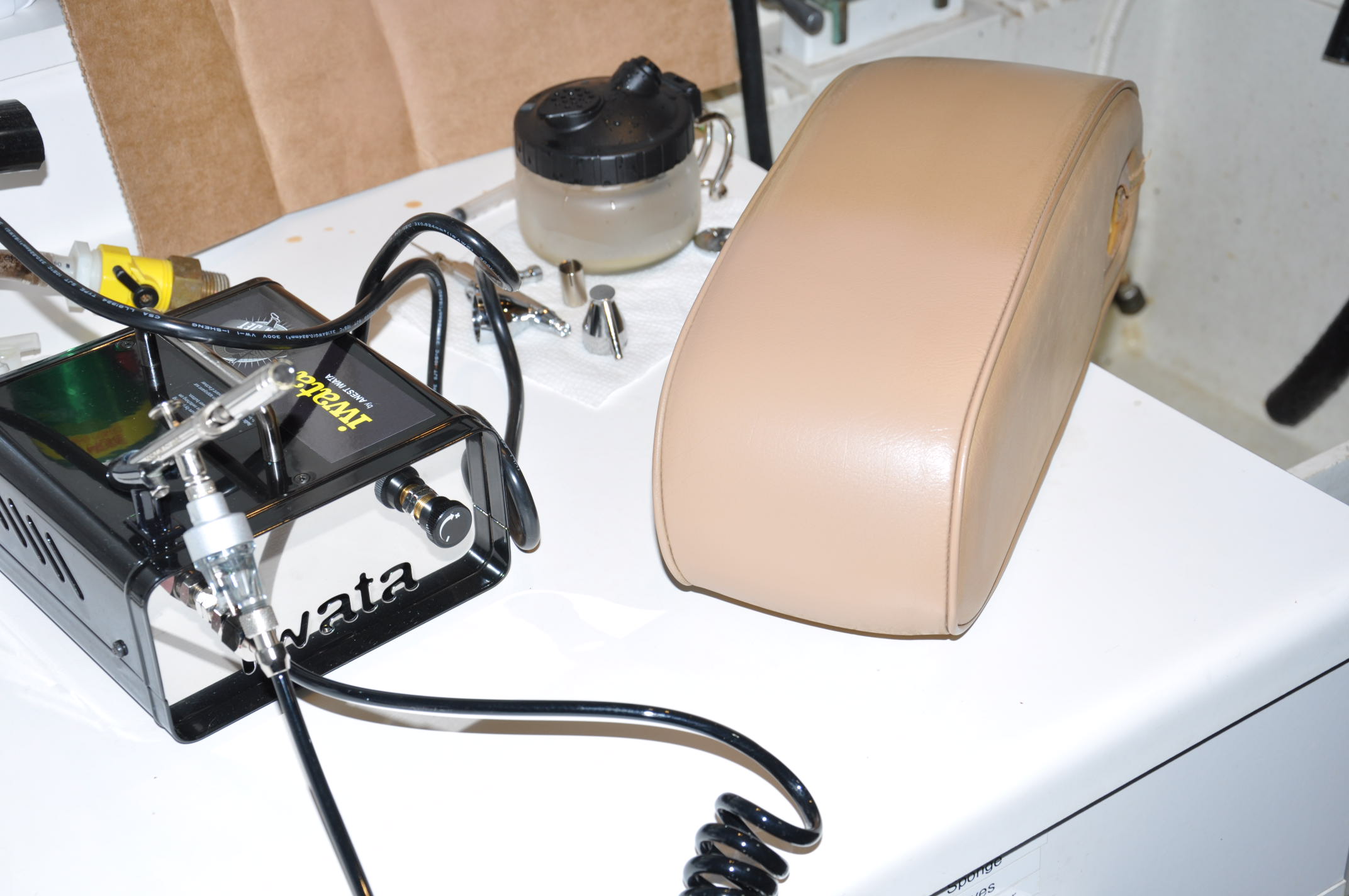

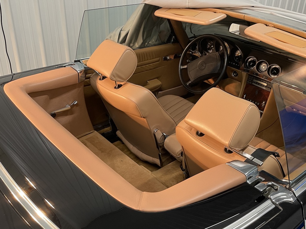

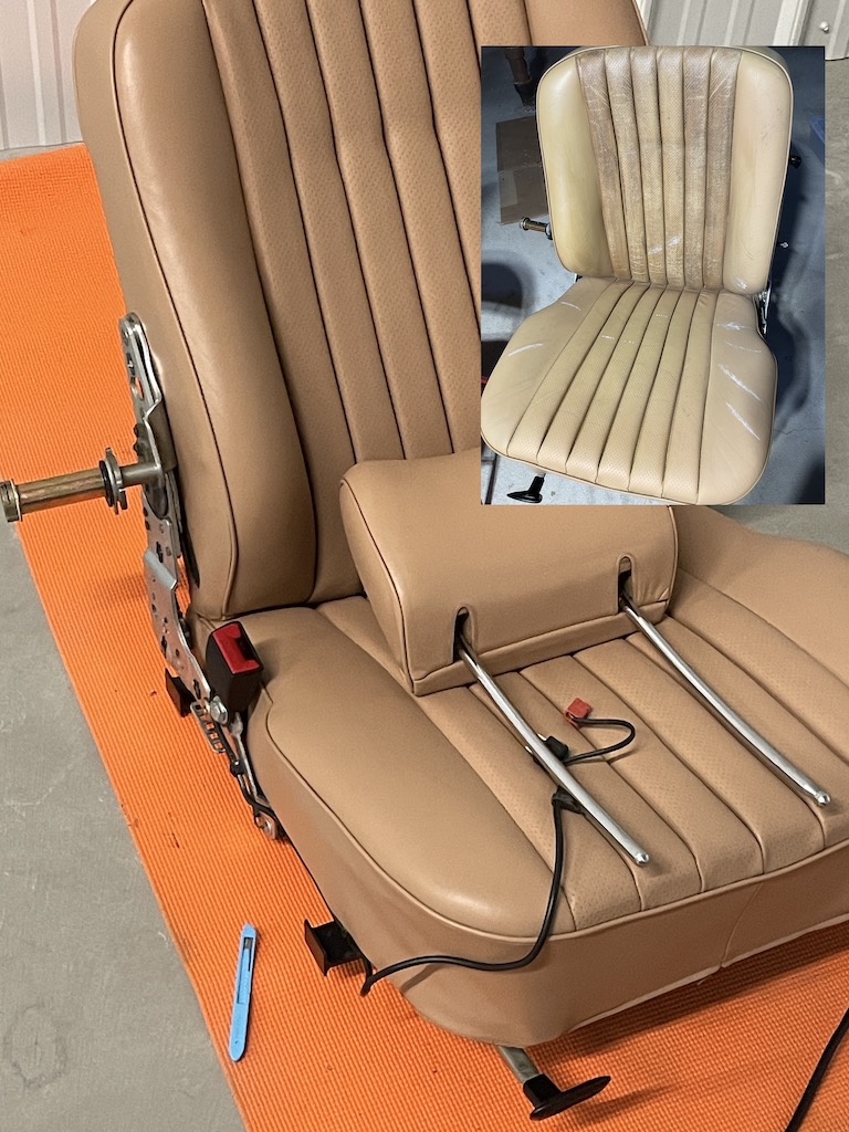

I spent this last winter redying the leather seats in one of my cars. I used a hobby airbrush for the whole project. I contemplated doing something similar to some other leather items but it was a lot of work.
Maybe for a camera case, just buy a new one.
