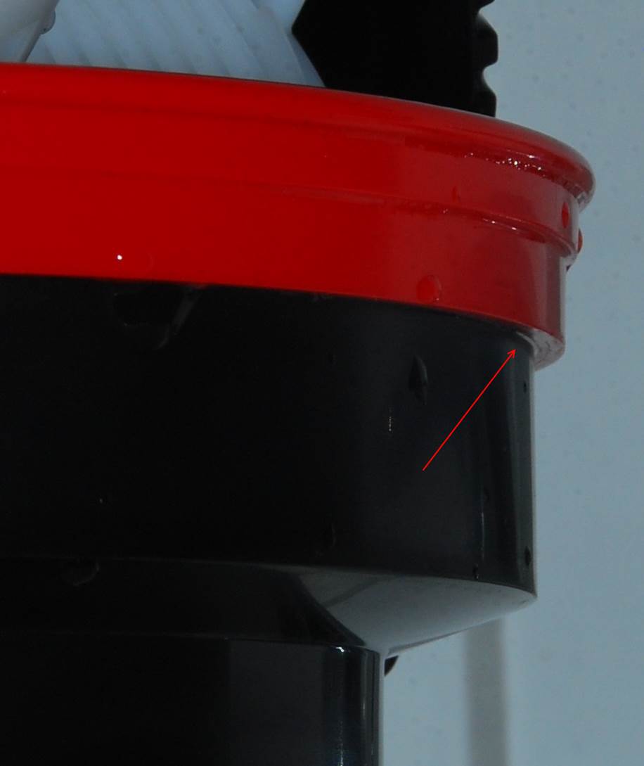

I dug out my Paterson tank to finally develop some film that had piled up, and found it to be leaking a bit between the tank body and the red gasket thingy. The flexible lid seems to be sealing nicely still. Is there anything I can do to fix it, or do I need a new tank? Can I switch to swirly-stick agitation? I've seen some members recommend against it.
When I invert the tank the liquid seeps into a pocket between the tank body and the red gasket, and when I turn the tank upright again it spills out between the tank and the red bit. It's not leaking all around the tank, only in a small part.

I had a similar problem. I was able to glue the two parts together with epoxy. Worked great.

Yeah my formerly leak free paterson tank started doing this recently as well. Bit disappointing, it's only about 2 years old, and not that heavily used. I plan to just put a bead of epoxy or silicon or something around the outside seal.

I have two I use alternately. One leaks as described, and the other is fine. Neither has been abused. I'll try the glue fix mentioned above. It's best not to have the chemicals running out to avoid potential contamination problems.

I have a Paterson tank where the red ring actually came loose on one side, which meant that the lid would come off in the midst of an agitation cycle!
A bit of cheap "Super" glue, and everything works great - no leaks and no surprises.

I still have a paterson universal 3 tank that even if it is a couple of decades old it does not leak. I have also another one that does not have any info on it other than a table of volumes under it. This one was leaking and I had that fixed by applying a relatively thin layer of soft silicone in the inner circumference of the cap (top part, not the smaller cap you use for draining it). Now, it seals perfectly and not a single drop comes out. It gets worn once in a while, but it is easy to remove it and replace it with another smear of silicon.

This isn't the lid leaking. Burping the tank doesn't help, the leak is too big. I'll get some epoxy and see if I can seal the leak from the inside of the tank.

You're not understanding, there is a separation between the red and black, "burping" doesn't create a vaccume neck see there's a leak, so even with the vaccume created, air slowly transfers into the tank through the leak and the suction/vaccume disappears and the leak happens mid-development. The "hole" needs to be sealed...

This is a new leak that wasn't there when the tank was new. It's probably been bumped around when I last moved house. A small section of the red gasket had come unglued from the tank body and didn't seal properly anymore. The epoxy is drying now. I also put a coat of epoxy all around where the gasket meets the tank, to be on the safe side.

I did another film today, and the tank seems nice and tight. The epoxy on the inside does create a little extra friction when rotating the funnel lid, but hopefulle that's not a problem. Thanks for the advice, everybody!
