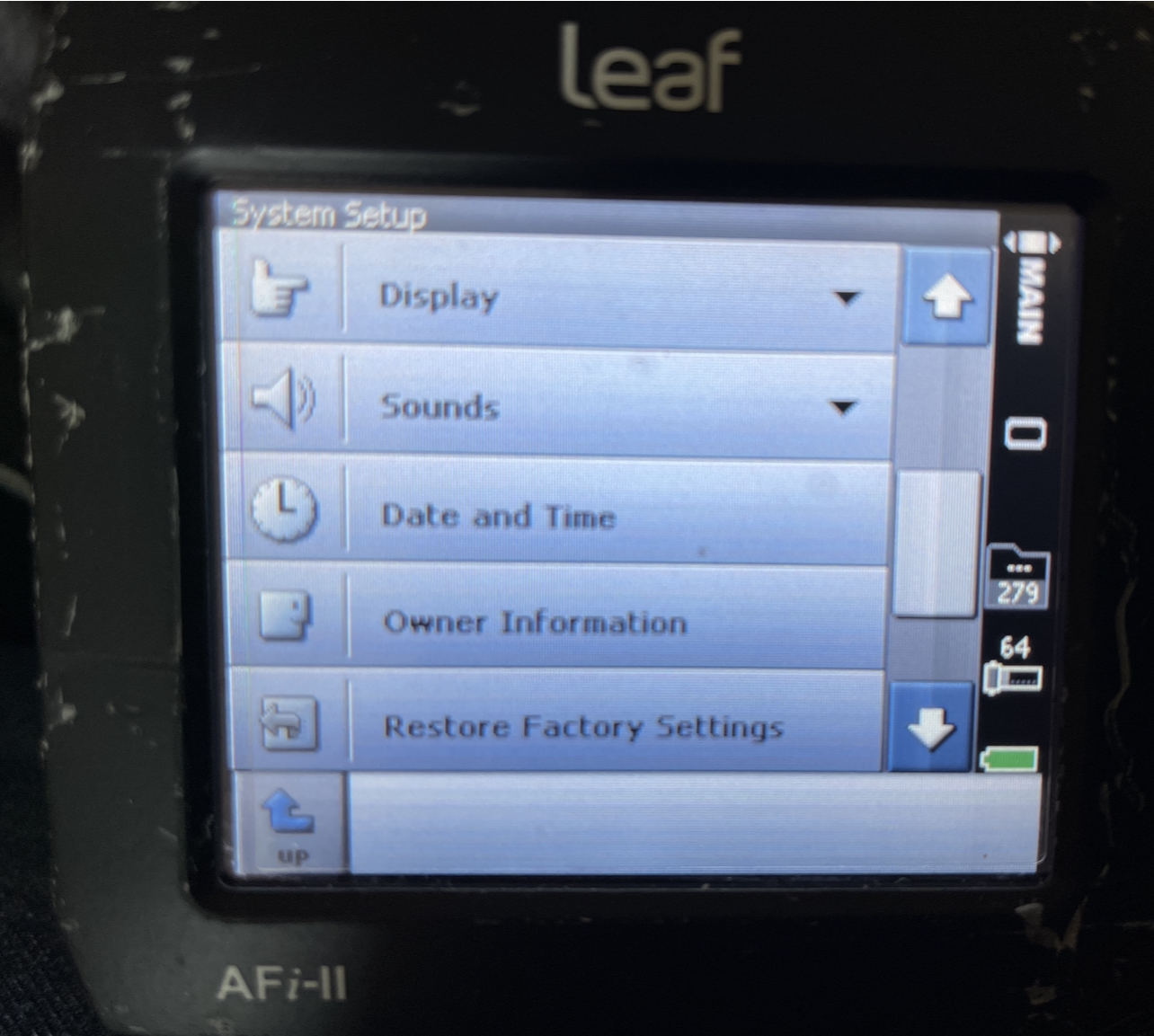

When reading the Afi-II manual in details, I realized that it could work with some old HP iPaq PDAs and connect through Bluetooth.
Here the extract from the Afi-II manual:
The problem is that I do not see any “wireless” option in my “setup” menu. Here screenshots of the Setup menu in my back.
Is it a functionality that was removed on some versions of the back, or after a certain firmware version (in which case, would downgrading the firmware to an earlier version bring any noticeable problem)?

I imagine you can go down some versions if you have access to the version you now use. Try to find out which versions for the HP & the Aptus were in combination at the time because the more recent versions of Aptus were using other devices for what you want to do.

Found this in some pdf.
Leaf WiView
Leaf WiView is not supported for Leaf AFi-II 10 camera systems.
Anaxagore
Jun 1, 2005
130
Leaf WiView
Thanks, that must explain it - no support on Afi-II 10 and Afi-II 12. Probably file sizes made it hard to load on these PocketPCs with insufficient memory and processing power.. or some other management decision.
