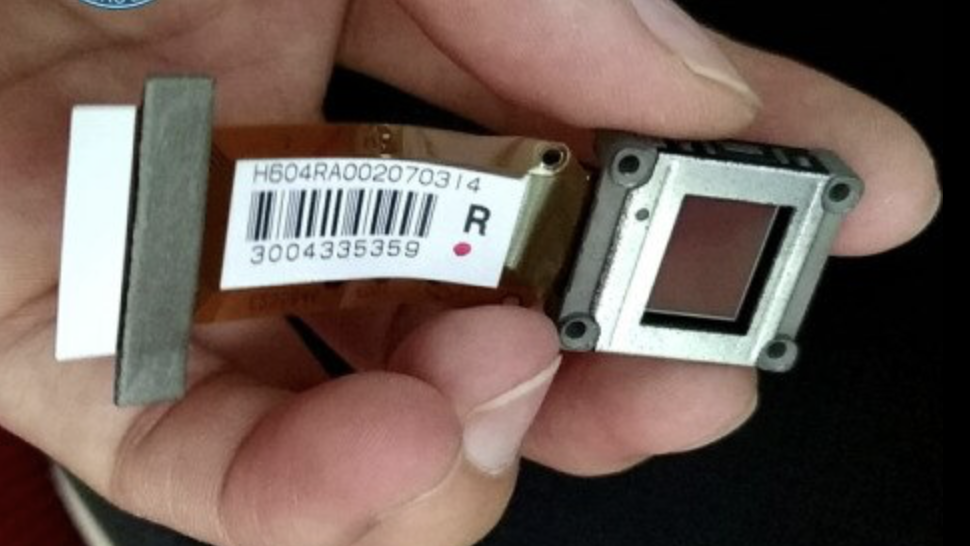

Large format?? Looks smaller than 35mm format to me. Maybe You have a lens form some monster projector for a movie theater or something that has a massive 0.95" chip. Still far from large format. (0.95" = 24mm)
