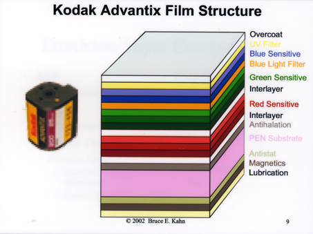

Pellicle,
the principle is as follows:
-) the basic layers are typically placed in the sequence (surface to base)
bluesensitive-
yellow filter-
greensensitive-
redsensitive-
in addition of course
surface-
subbing-
antihalo-
(antistatic-)
(anticurl-)
to make it more complicated
many films of today have the colours layers seperated in two or three sublayers with a different scope of crystal sizes, which makes 1x2plus2x3 or 3x3. Behind this are similar thoughts as in BW multilayering: control of gamma, latitude, grainularity. The sequence is high-, medium-, low-sensitive.
sometimes
UV filter-
red (or magenenta) filter-layer
seperation-layers between the colour groups
for the yellow filter-layer Carey Lee silver (collodial silver) is the classical approach, however a more modern concept employs a dye as its absorbtion charecteristics are more profound.
The thickness of most layers will be less than 2μm.

There are a few more than AgX lists above but he is correct in the essentials. See the cross section I posted here on color film. It shows and identifies each layer. It is in the emulsion making and coating forum.
Basically it is /overcoat/fast blue/slow blue/CLS/fast red/IL/fast green/slow green/IL/slow red/AH/subbing/support/AC/. Sometimes the fast red is under the greens and sometimes not depending on film. On the back are antistats, anticurl and other things. Subbing is present sometimes for example, but in some films it is not present due to the method of manufacture.
See the excellent article by Chuck Woodworth from Kodak on (I believe) howthingswork.com .

You left out some interlayers and the division into fast and slow components.
Awww heck, here it is again. Note that the labels don't distinguish fast and slow layers, but they can be seen in the light and dark colors in the example. This also shows the UV overcoat and does not show component inversion.
It varys with each film.
PE
